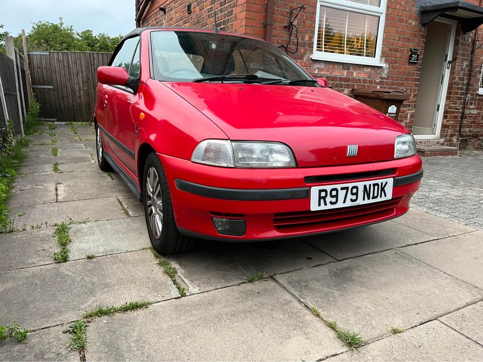

I picked the car up from Stockport, drove it 240 miles home without incident. I had to stop and get wiper fluid, the car was seemingly lacking in power the whole journey initally struggling to get above 60mph but after about half an hour of driving it seemed to free up and could get up to motorway speeds. The top speed on the car should be a touch over 100mph so something isn't quite right. More investigation needed.

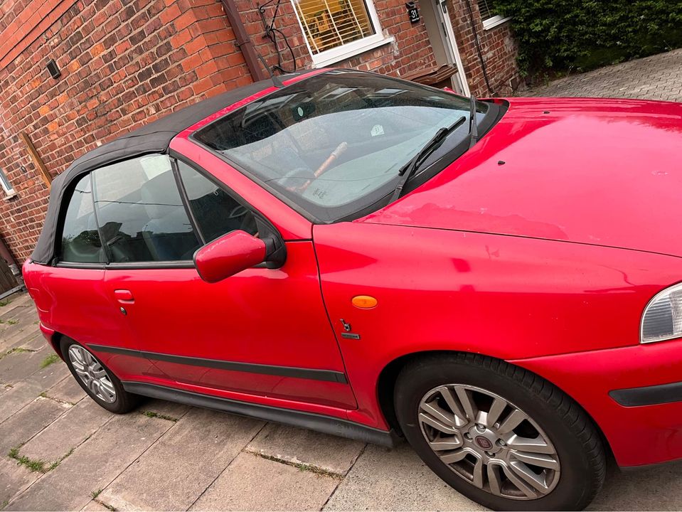

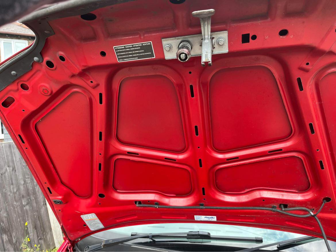

The general condition of the car is pretty poor. That said what attracted me to this car is the lack of rust. Or that is to say very little obvious rust for a mk1 punto. Some of them are swiss cheese these days after 25 years on the road despite the older puntos having pretty good rust protection.

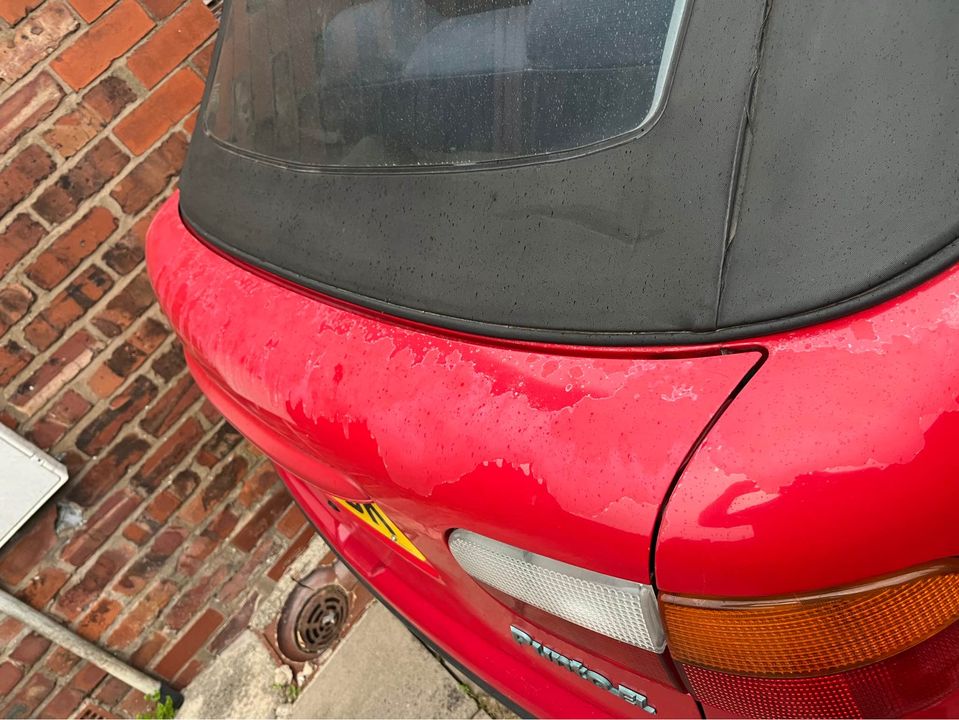

The body work is free from any major dents, but the paint is terrible. The car will need repainting.

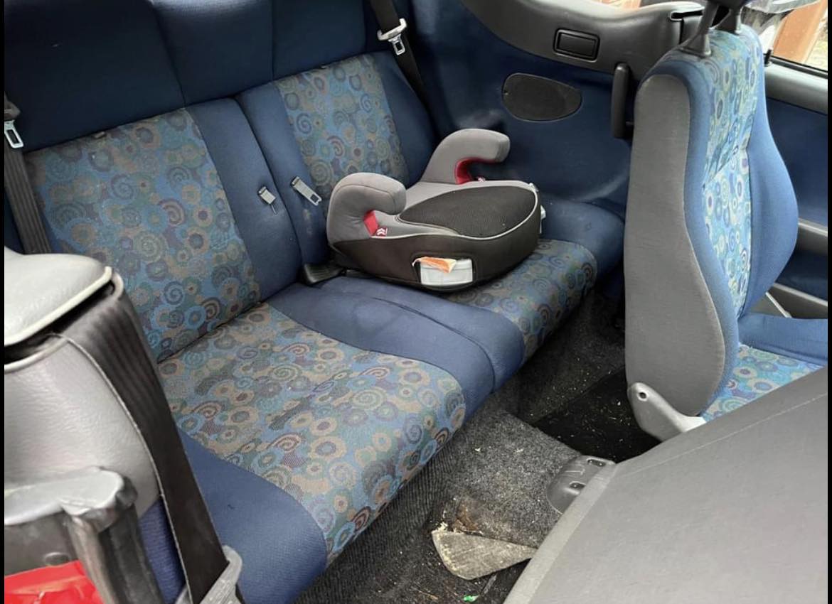

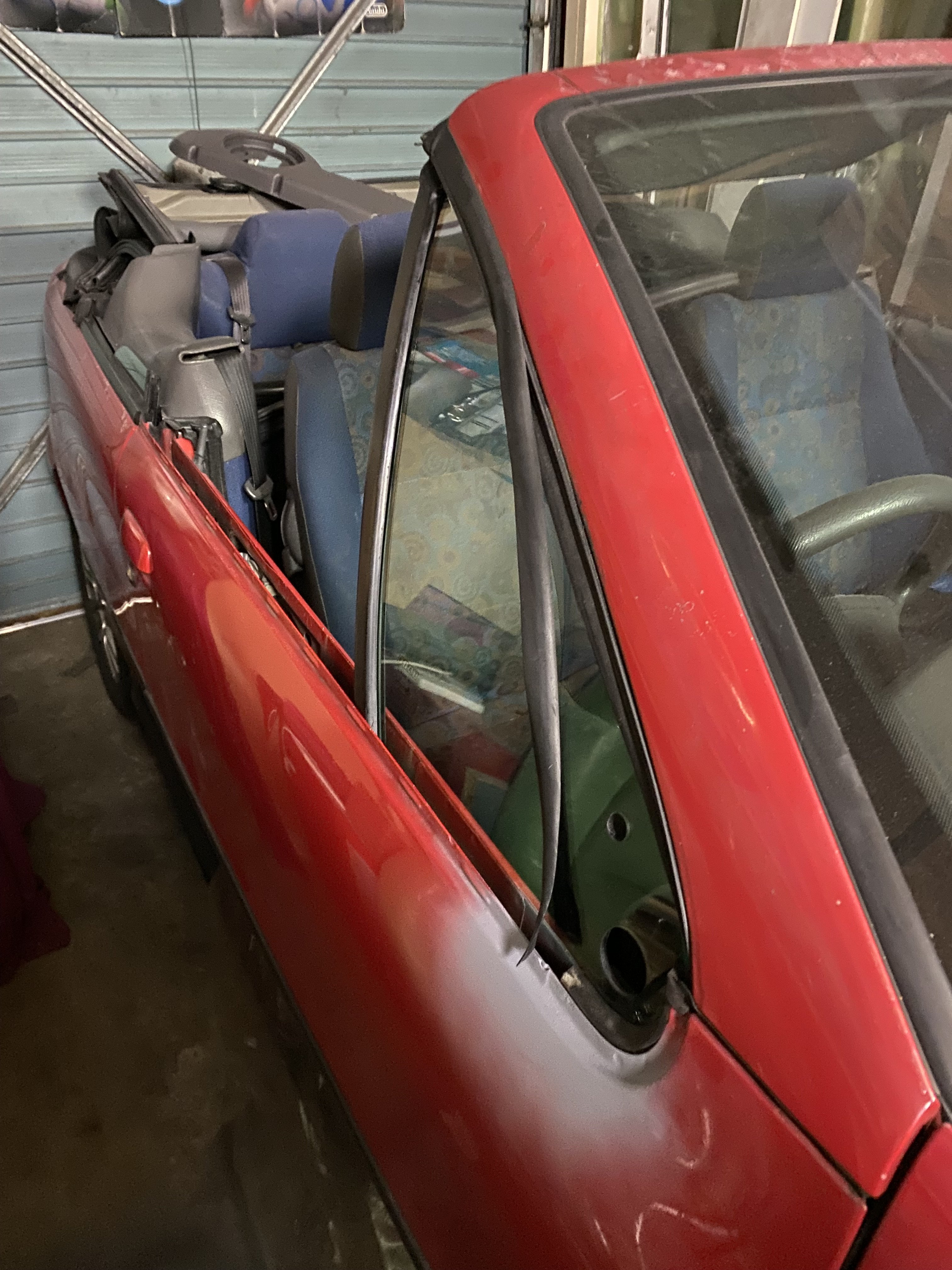

This is the 1.2 85hp 16 valve engine. It is the ELX model with all round electric windows and electric roof. it has a typically 90s/early 2000s stereo and the interior is pretty grotty. I have a plan to completely refurbish the interior including the carpet which appears to have been damaged behind the drivers seat in some sort of minor fire at some point. Which has also damaged the door card. No damage to the seat so these were either not in the car or have been replaced.
