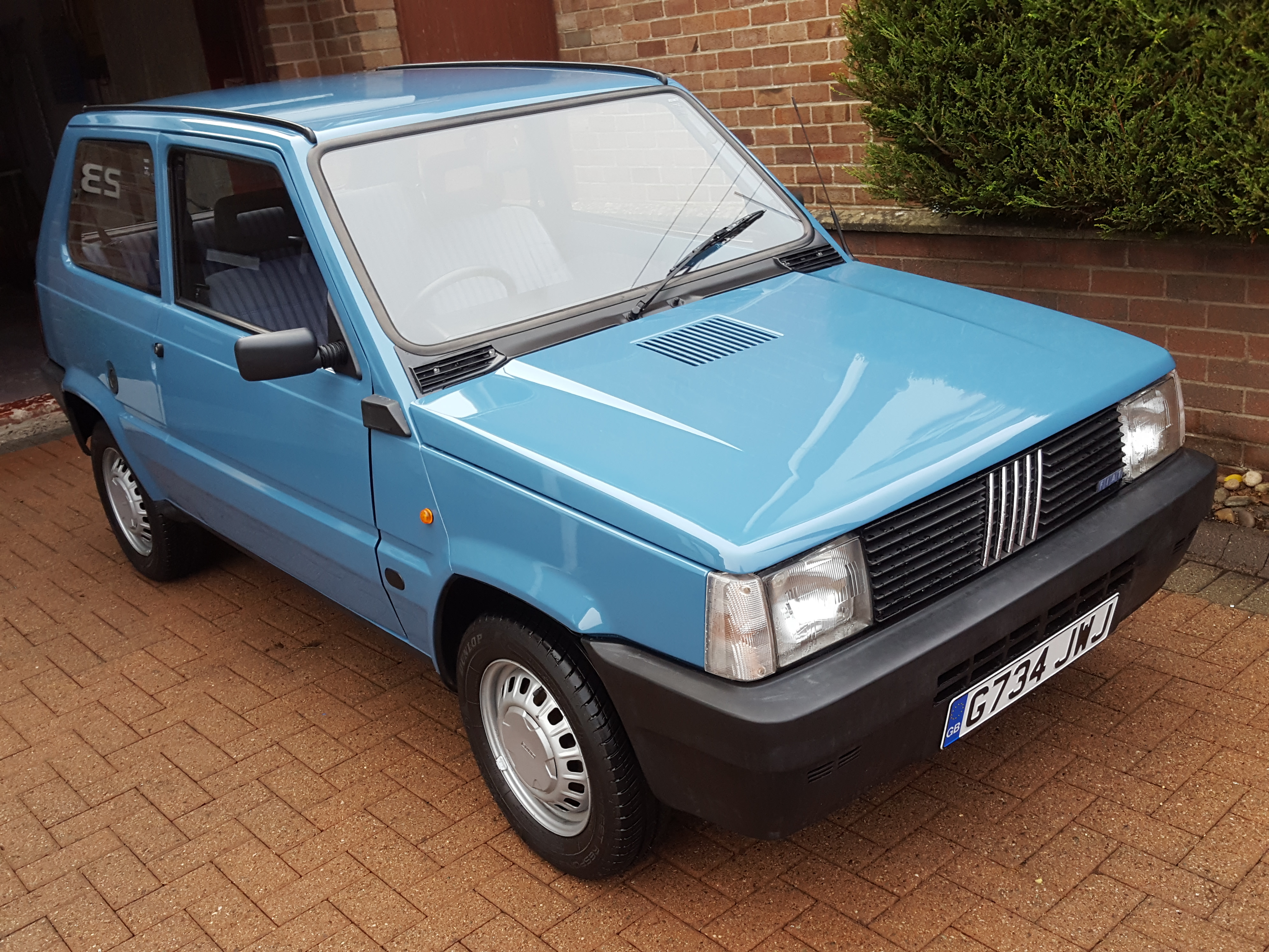

Before any work is started I then spent the following 4 months buying small pieces of trim and parts as well as obtaining quotes for a full exterior respray along with welding and patching. After spending a small fortune on eBay for parts and trim and thanks to Binhoker, not only for parts from his Panda 'Lipstick' but for directing me to a scrapyard near Ballycastle (probably the only one in NI that has a classic Panda), I've obtained almost everything I need to get started.
The project is intended to be a slow one for next year or two despite having almost all the stuff I need mainly due to other commitments etc. that I'm sure many of us will be too well familiar. Pandani's currently SORNed and hibernating in the garage after the welding and respray was completed a week before Christmas and I intend to have her on the road in the spring allbeit with plenty more work still needing done then.:)

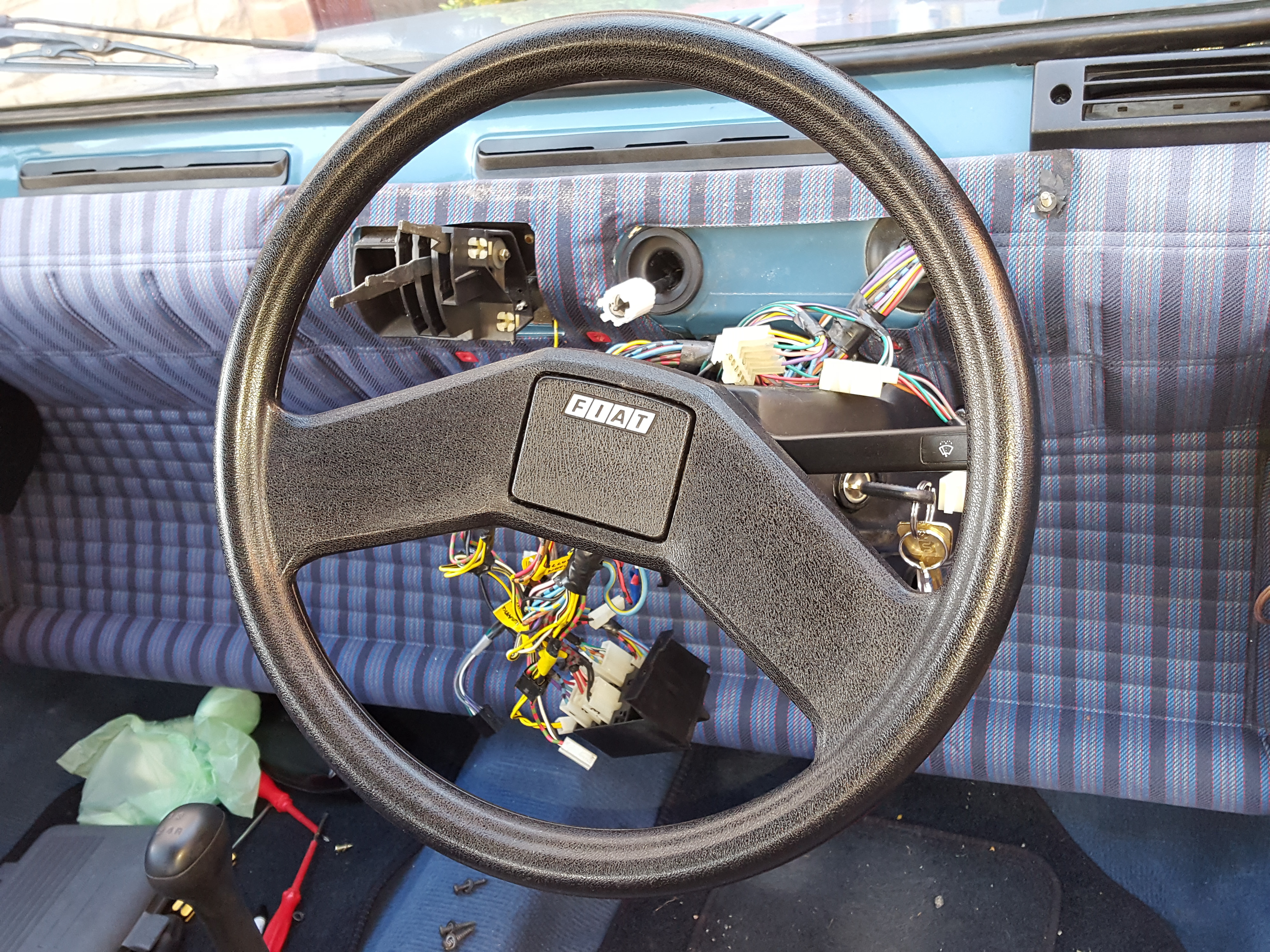

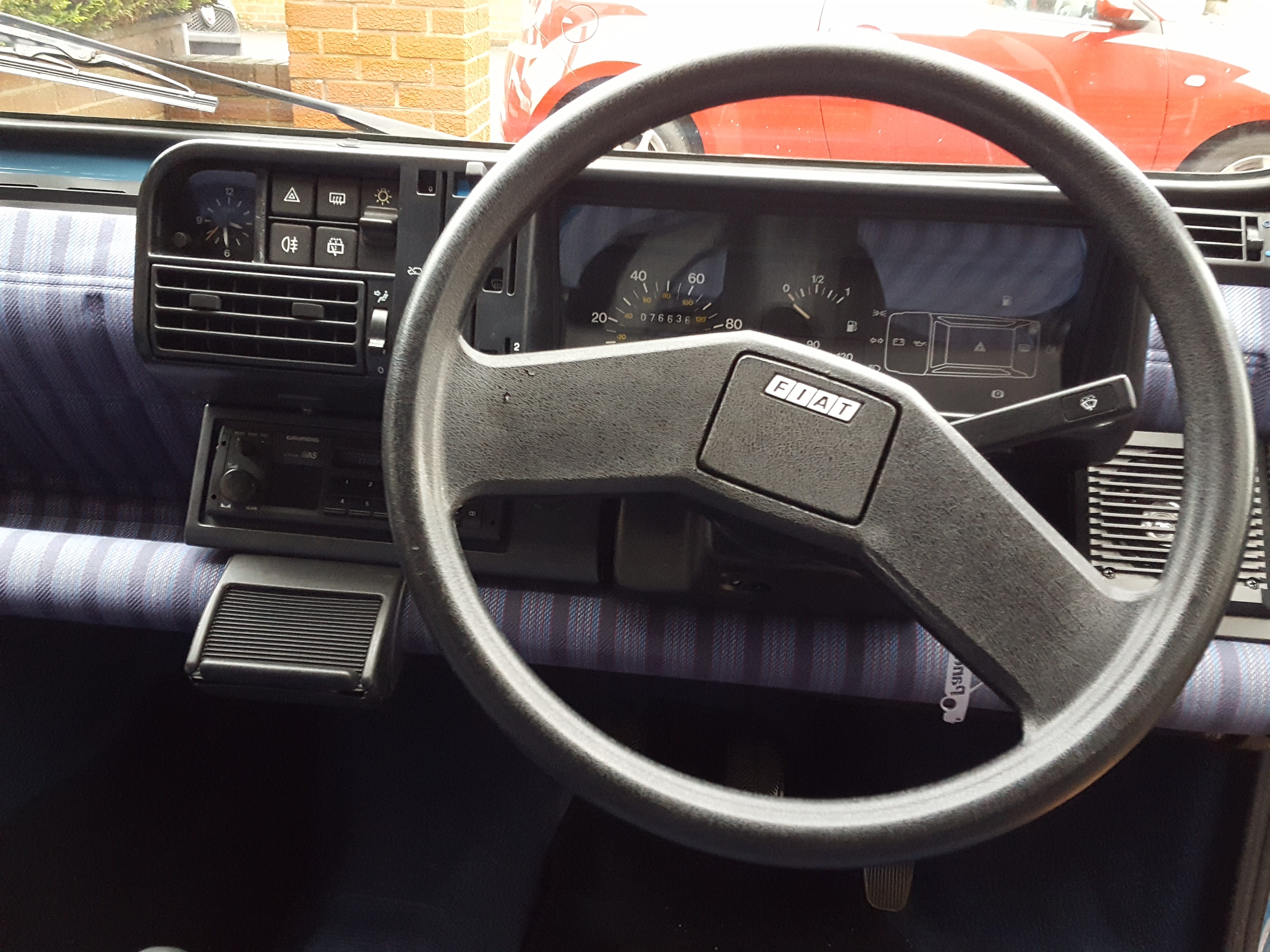

A few weeks ago I replaced the black plastic dashboard housing, this was cracked in many places by a previous owner and I managed to get a replacement from ebay which was easily fitted.
I also fitted a second hand clock and connected the cigar lighter which are both non-standard items on the 1000CL. It was so easy as the wiring loom already had the connectors and wiring in place.:) I also took the opportunity to modify the wiring to the ignition coil and break it through a 15 Amp fuse I'd fitted beside the fuse box, this not only protects the wiring (which wasn't previously fused) but also acts as an effective immobiliser against opportunistic scrot bags that like to steal.(y)
I've done almost everything I need to restore the car and now she's been SORNed for the next 6 months and will be hibernating in the garage. I don't want to be driving it through the winter months; this Panda's for keeping and enjoying through the spring and summer.
