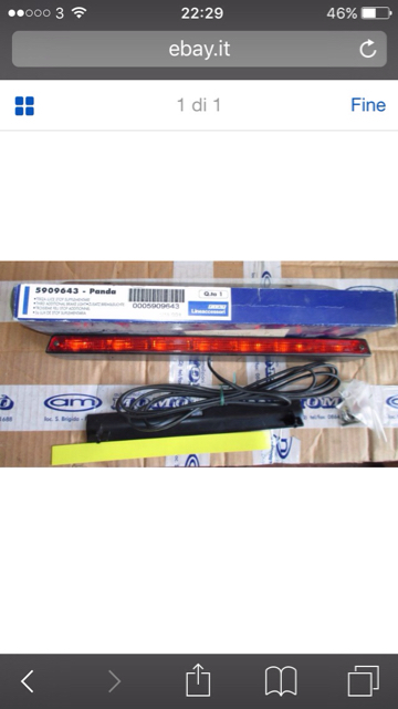

3RD BRAKELIGHT
I'm wanting to keep Pandani mostly original, however I have made some exceptions such as fitting things from higher specced Pandas (clock, internally adjustable mirrors etc.) and also a 3rd brake light. I think safety reasons alone justify the 3rd brake light and I've managed to get a suitable one from Amazon for about £8 that is the correct size and style to match the Panda's boxy shape.
The steel bracket wasn't suitable as supplied, however i modified it by bending it to suit the shape of the tailgate; cutting off the excess of one of the bracket's 'leafs' and then bending it to form a small box section, a hole was drilled and a small grommet fitted to allow the cable to go directly into the tailgate's hollow section through a larger hole that had been drilled into it. I primed and painted the bracket prior to refitting as well as shrouding the three cores of the exposed cable with black heat shrink tubing and it looks reasonably well.:) The cable was then jointed to another newly positioned extension cable within the tailgate hollow section that led down through the flexible tubing/conduit that links the tailgate wiring to the car body to enable connection to the brake light circuit. Getting the cable through the conduit was a real bitch of a job and you probably wouldn't want to waste your time trying the same.:mad: Maybe just running the cable outside the conduit would be a lot less grief.

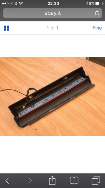

If you are looking for an original fiat linea accessori 3rd brake light let me know
Cheap here in Italy around €30
Love your updates!
[emoji106]
I didn't even think of that. I always assume that you can't get Panda stuff and even when I do look it's nearly always the wrong places.:mad:
If you wish I can find one for you.. I know you did a great job with the current LED light but the original fiat accessori one is just perfect to keep the originality of the car
Brand new old stock
£40 plus p+p
You will need the tailgate support
Second hand
Lights + tailgate support
£30 plus P+P
Thanks, but I won't as I've already gone ahead and fitted the one I got as you know and to make matters worse I bought a second one as they were so cheap, just to have as a spare. Yet again I always look in the wrong places for stuff thinking Panda stuff is rare to get.I remember fitting that Lineaccessori one in your photo to my Cinquecento many years ago.
