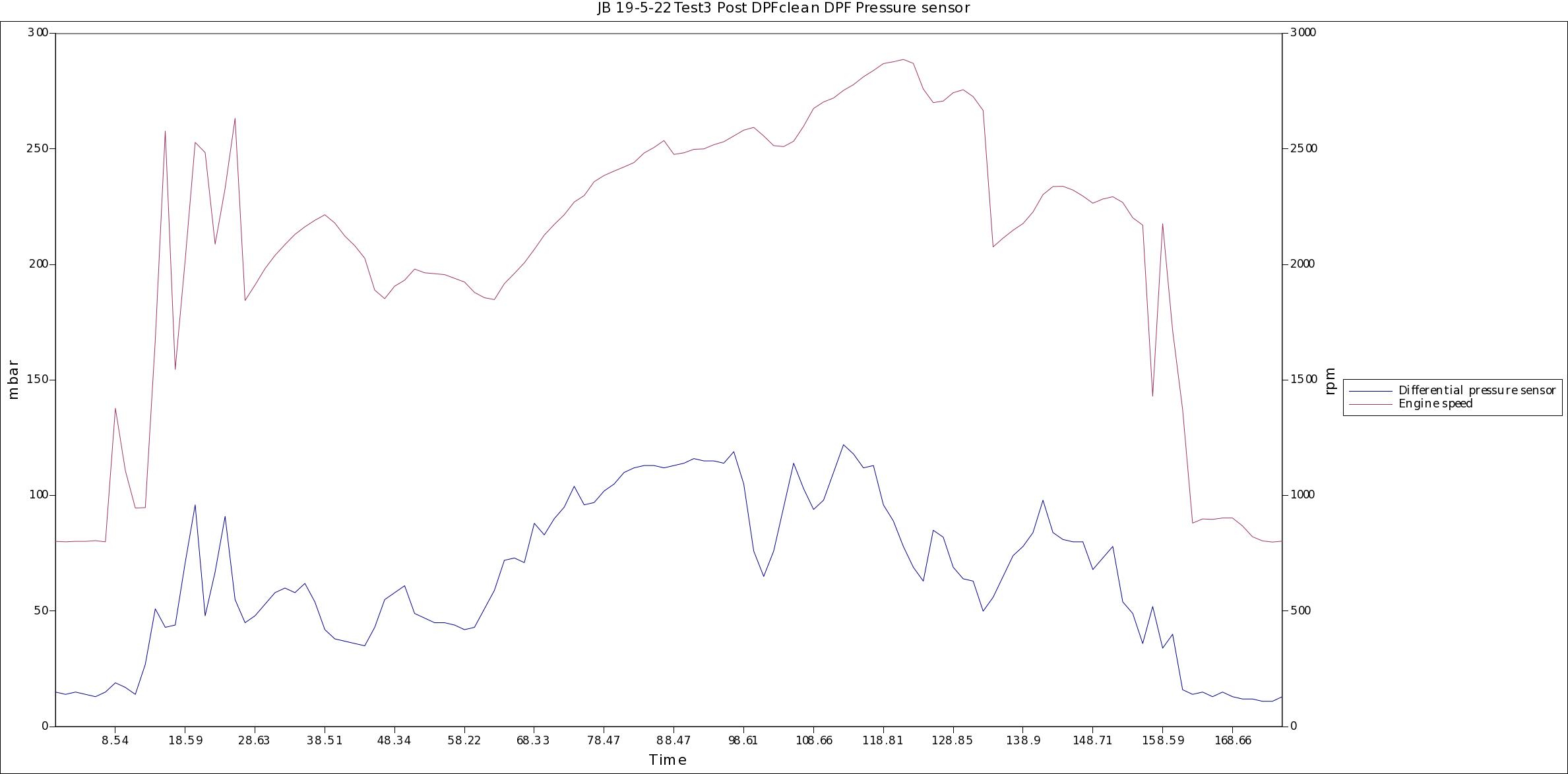

I also got a spray can of DPF cleaner. Supposed to spray it in through the Lambda? sensor. Or could it go in the Differential pressure sensor pipe?
Says to do a regen after but I don't really want to. So just drive it?

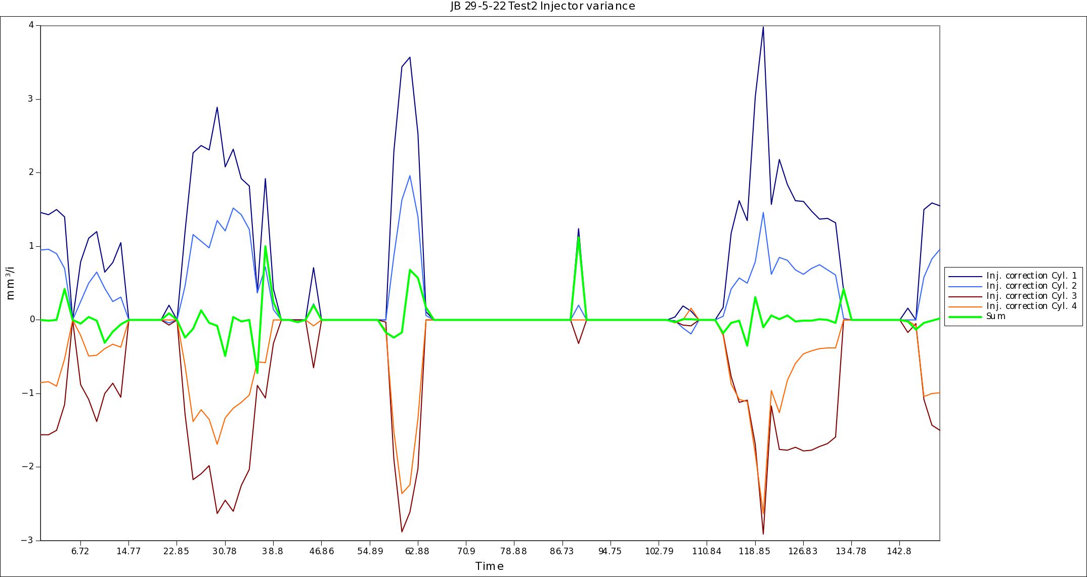

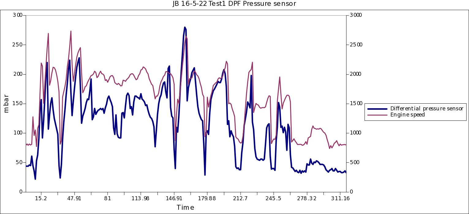

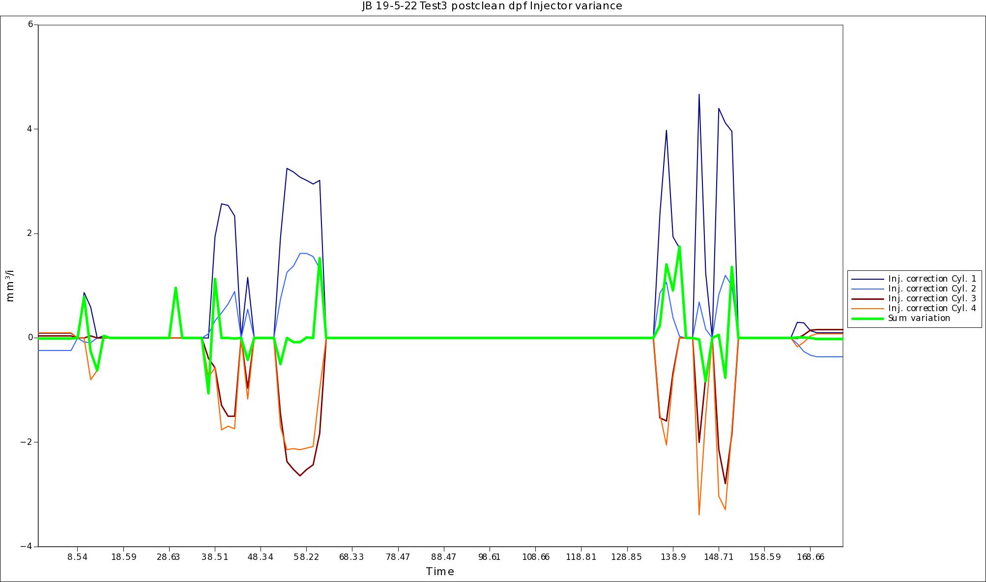

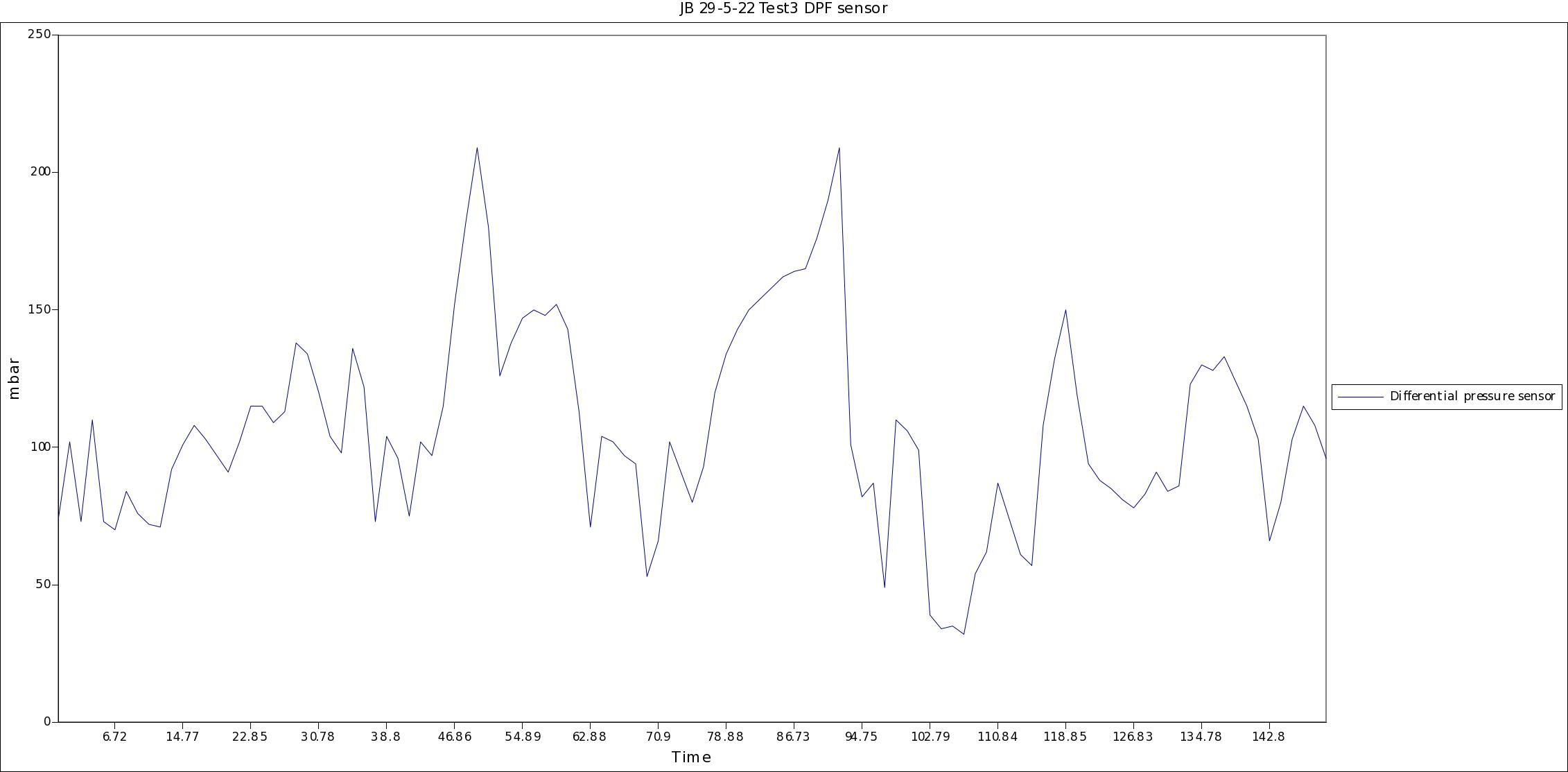

300klm later and I am back to the same issues. p1206 but only 69% clogged and normal clogging
YesOk, so I have just taken all the injectors out (surprised at how easy it was!) and I am bringing them to a place to be tested tomorrow.
Assuming I will be putting some new ones in, how do I program them to the engine? Is it done in MES?
