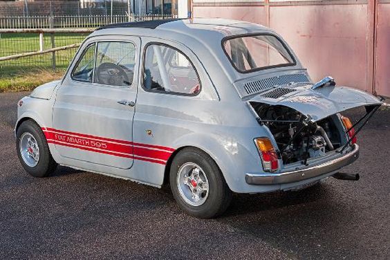

When it comes other fitting under arches, wheel diameter and tyre size are ultimately quite linked. If you were to go the route that many VW enthusiast go with 'stretched' tyres you can fit crazy wide wheels under standard looking arches. Offset also plays a big part also. I'm sure the wheels in this picture are going to be 7 or 8" wide and 'fit' under fairly standard arches, but they aren't going to be a fit most are happy with.
The wheels @smart51 is using, I believe, are 4.5" wide. So thats 1" wider than standard, and fill out the standard arches nicely.
These couple of 500s are using 10x6" wheels ( I think, could be 10x5?) under standard looking arches.
At a guess I'd say you wont want to go much wider than 5" without needing something more than just an arch roll, and you'd be best to take some measurements from your current wheels to calculate the offset and work out how much extra banding you can do. There are guides online as to how to measure and calculate wheel rim widths and offset.
