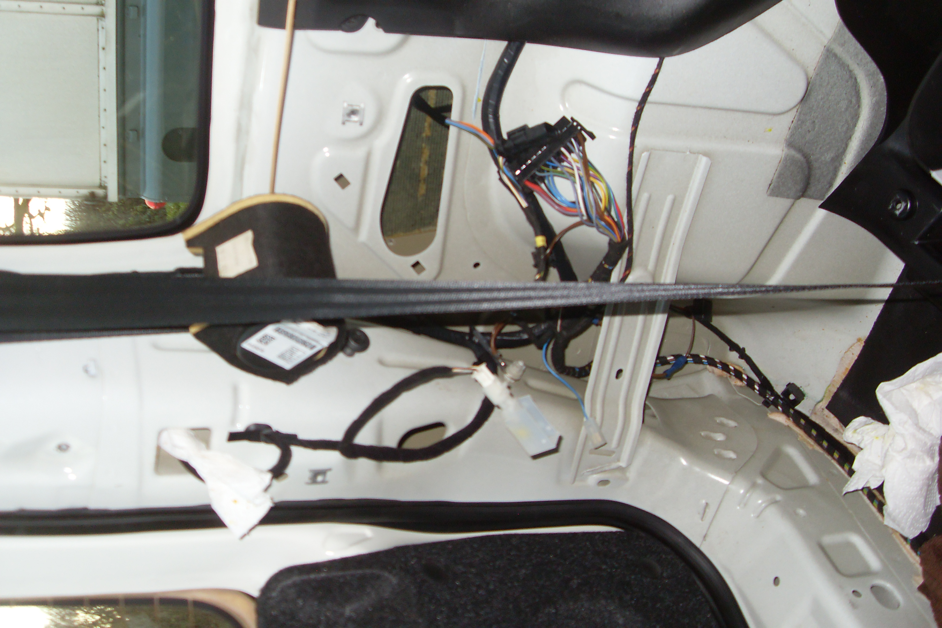

Well, had it apart and still not solved. Water is dripping down inside of inner pillar and when contacting the plastic grommets ( to fold the wiring loom), is coming in through there. See the No.3 photo, follow the wooden skewer thing and it's the grommet just under that.
However, on the end of that skewer is a tissue which was wet. So water is coming from higher up.

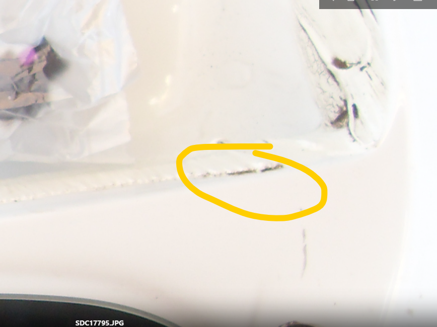

Photo No.1 shows the outside body under the light. You can just see the inside of this panel looking through from the boot side and it is dry, including where the wiring comes in.
Also all under the quarter light is dry.
Sorry the photos are all on their sides!!
Was on my own today so didn't get help with the hose but will try again tomorrow. I'm now thinking roof rail but how is that attached????

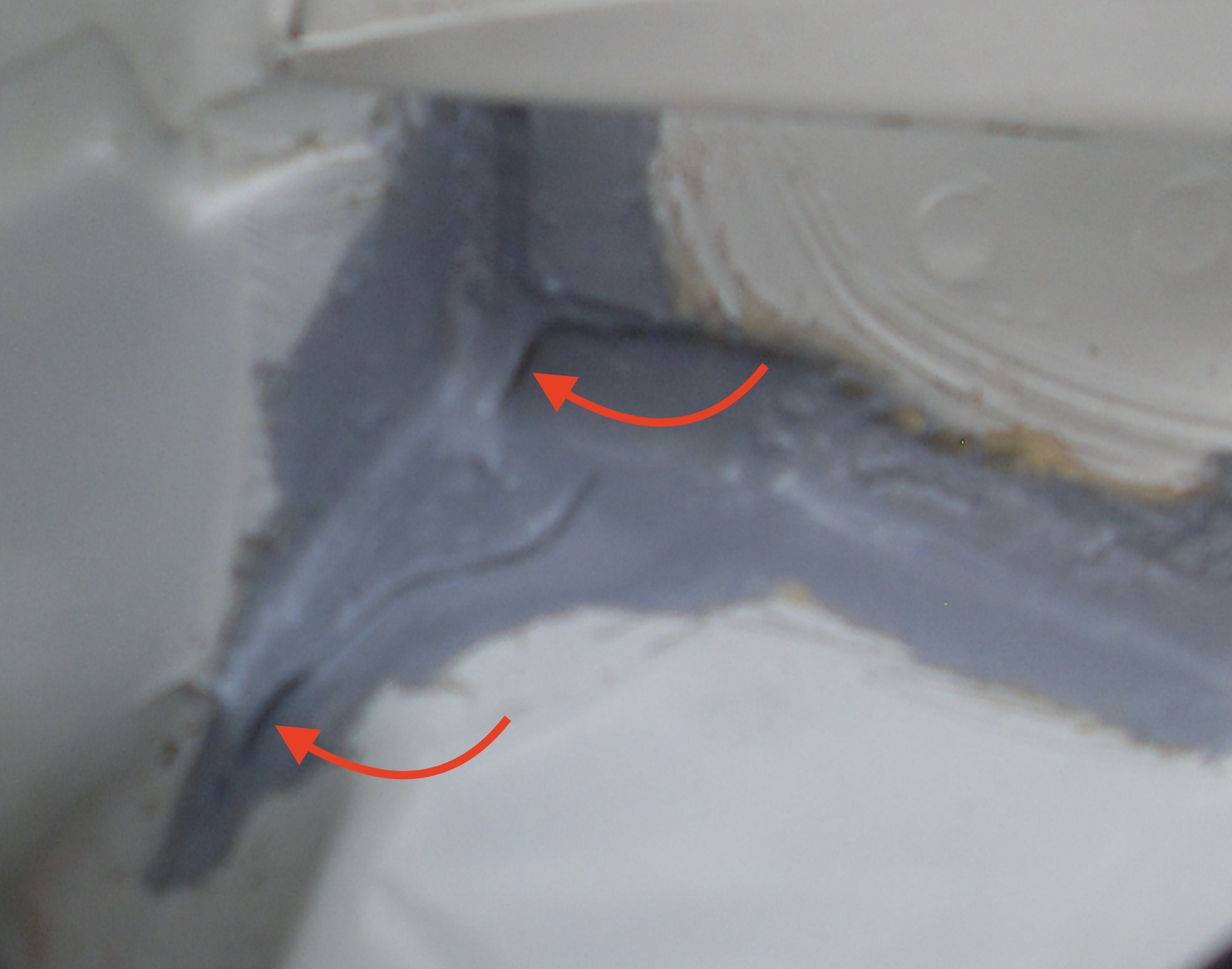

Firstly there is no way for water to get in via the roof rails as the mounting bolts do not penetrate the roof skin. See photos 1 & 2. There is a welded joint within the gutter that the roof rail covers. This is where the roof panel is welded in. A bead of sealant runs along this. This could be a point of entry but it looks perfect in my case.
The only possible area that I found where water was getting in was "somewhere" in the grey painted area in photos 3&4. There was the smallest of cracks in the sealant but I could not actually pin point the source. Needless to say I chiselled the old sealant off, epoxy primed the area, then added a bead of polyurethane sealant (too dark to photo). Tomorrow I shall run another, thicker, bead over the top and keep my fingers crossed.
If you look at photo 3, the very bottom edge of the grey area (above the strut mount) is where I think the water was getting in. Can't believe such a tiny hole can let in that much water!!

I assume the grey paint is yours... It does look like there could be a gap or two (arrowed). Remember the smaller the gap the greater the capillary effect it has so can actually draw more liquid through than a big gap would (like the nib of a pen)
Spot on.
The grey is the epoxy primer I painted on after I'd removed the old sealant.
Your lowest arrow is where I assume the water was coming in. I'll soon find out if I'm correct!!!
