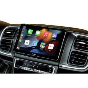

Hi and thanks for taking the time to reply.
I keep the motorhome in storage so don’t have access to take any photographs at short notice so I’ve attached a web picture of the same dash but with the smaller head unit. It’s a 2022 cab and you’re correct the 10” head unit is secured by 4 screws 2 either side located underneath the heater vents and 2 easily accessible screws at the top of the head unit. I’ve got van booked
In for a diagnostic check and investigation at my expense as the warranty has expired. Fiat will honour the warranty if there’s a Fiat fault so I wanted to check the basics, connections etc first
OK :)
Can you take out the element to which the green arrow is pointing to? I see they've remodelled the interior, but it could be whats underneath is still the same :D
In the x250 (and I assume also the x290 until 2018) it was possible to get to the connections on the back of the radio unit.
I've just checked the other thread and yes, adding anything to the installation could have made a mess :( Check the PM.
