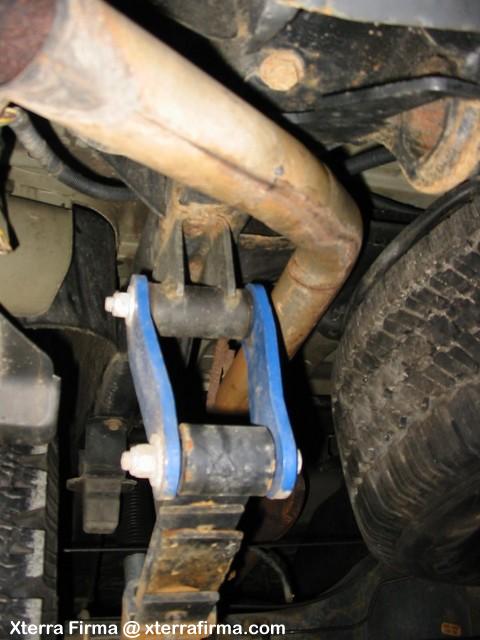

I don't know if I am understanding the doc wrong (probably) but many other 4x4s use what is called a "shackle" lift. See picture for this item(blue piece). It goes between the leaf spring and the body and can offer a 5cm lift or possibly bigger.

Oh great. That what exactly what I thought(y). Do you use some plates between axel and leaf springs? Or you just use these longer "shackles"? And is it cause of some problems or it´s without any problems?
Yes, 4x4 has some "bushes" there in the rear if I think the same rubber pieces like you. Only this can wear out faster? How ist it with shocks?

there you go the answer is extended spring shackles and fab up some drop brackets for the bottom of the shocks.as for the u/js fab up some 20mm spacers and fit them between the diff pinion and shaft.

It´s better to buy shackles or fabricate them? What do you think?
