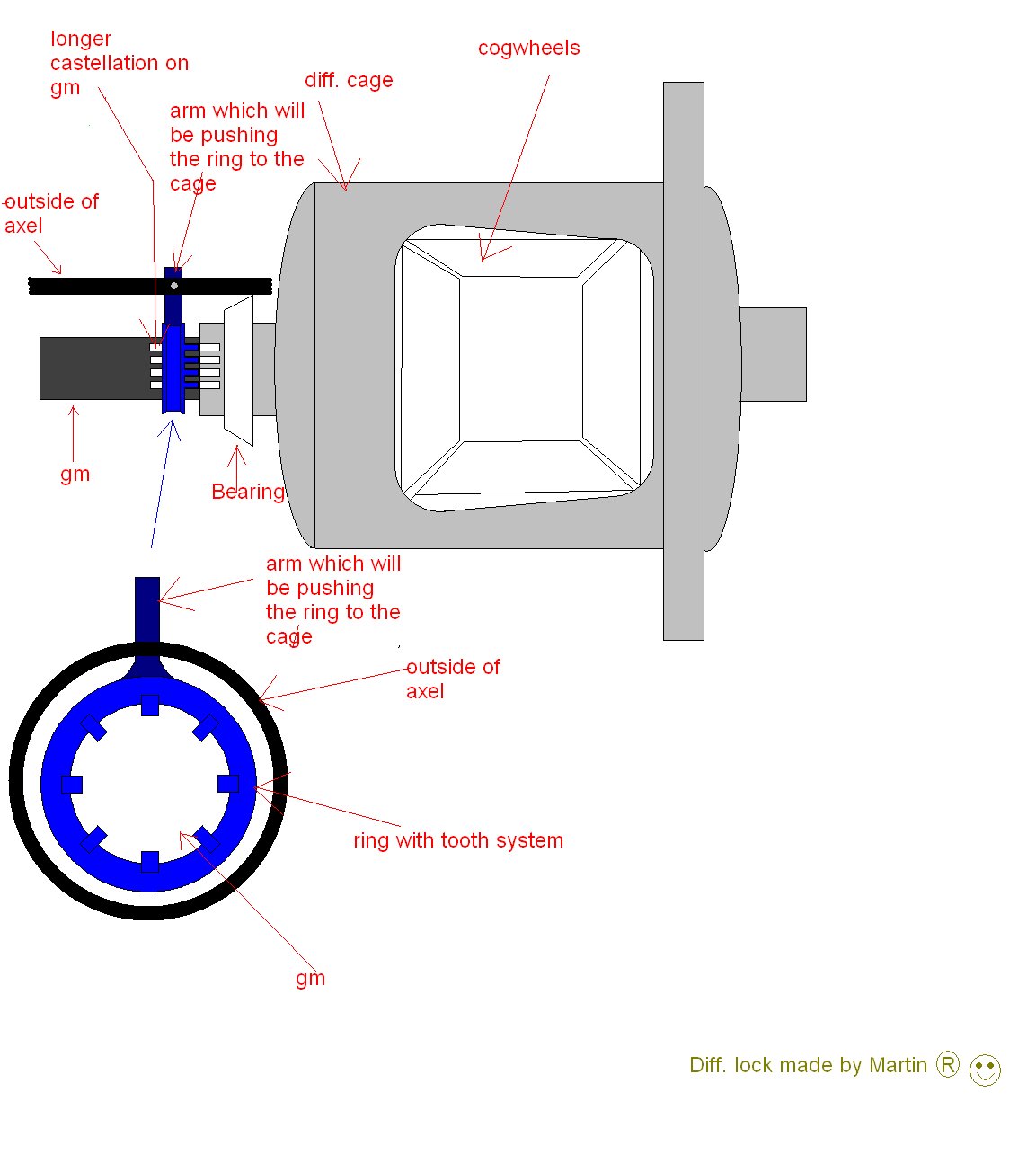

Here is my idea....maybe solution:D (I hope that is posible solution:D)
[QUOTE = Martin SK; 2281290] Here is my idea .... maybe solution:D (I hope that is posible solution:D) [/ QUOTE]
Yeah, Martin I see your idea, its great, but I think forces will be so enormous for flywheel. Dunno? As I said I am not competetive for engeneering.

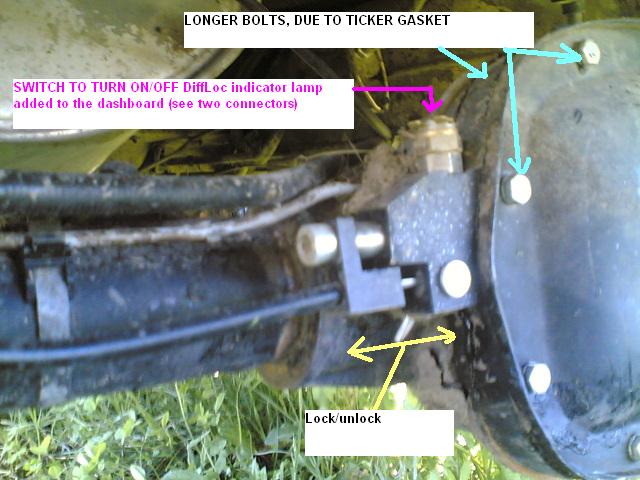

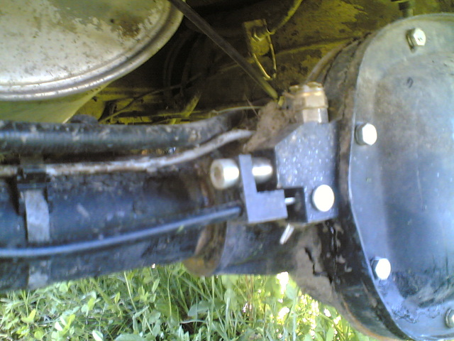

I think that this may give you some ideas:
http://www.jimny.se/locker.html
But remember that fiat panda transmission and dif, weren't made for a diff lock, so their durability will be compromised.

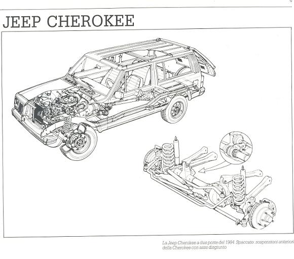

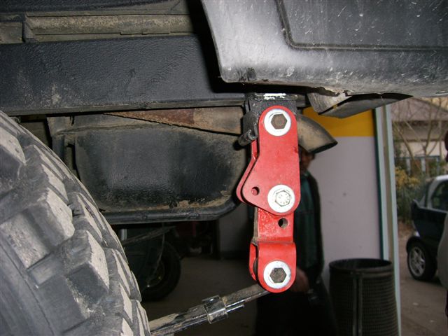

A cheap solution, is to use 2 handbrakes, one for each well
Panda4x4net: This looks nice:) but I think it´s original lock and it won´t be cheap. And that duriability is that what I am bit affraid about.
I´ve got new idea about some brake system but I have to think about it deeply and will write my plan (maybe:)). I saw it on my fathers Subaru Leone. It has some system which works: you push clutch pedal and brake (it works when car is standing downhill backwards) and then you realise the brake pedal but car is still standing like when you were standing on brake pedal. But I didn´t think about it and didn´t studiy it very deeply so I can´t say how I will make it:(. But it´s possible to make for all 4 wheels:D
Aca: very nice shackles(y)(y)(y) these looks great(y) Thanks for nice idea
