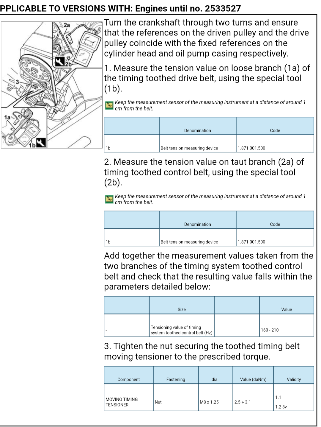

Earlier engine are tensioned by a pendulum type gadget
Later engine by a indicator built into the tensioner
Frequency method was only for around 2 years as far as I know

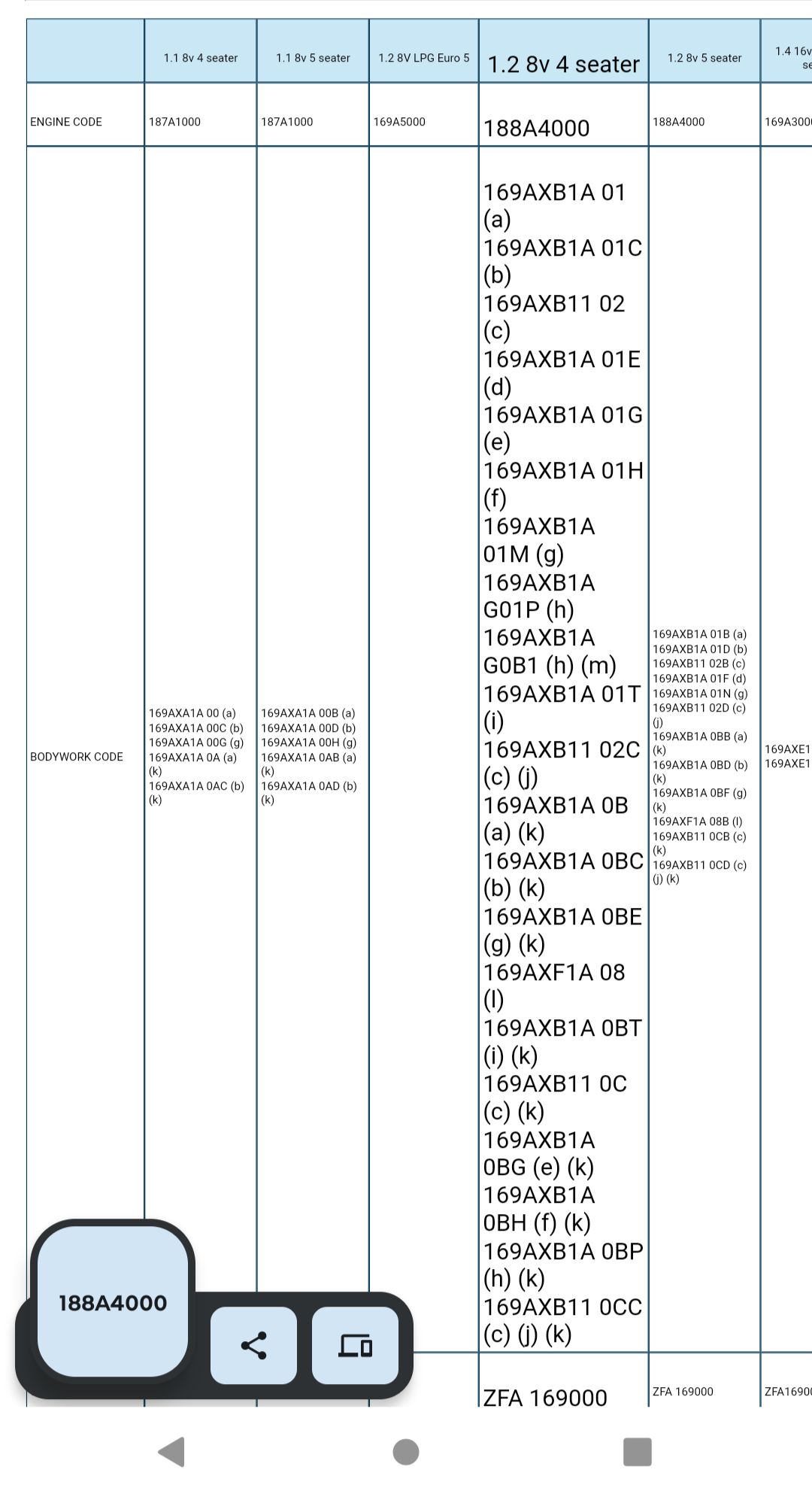

There's at least 4 different ways to time the 1.2 8v fire engines they were production a long time mid 80s till a few years ago and underwent several modifications
Frequency is the correct method for your engine
Square cap pre 2533527
Should have the narrow belt 15mm not the more common 22mm
Early engines are 188A4000
Thanks again! If you listen hard around lunchtime tomorrow you may hear me hitting the note.
Took flipping ages, bottom rad hose was a pig to coax off. And why does the back alternator bolt need counterholding in this century? Used two frequency apps and got it within 2Hz. So simple! Came down from workshop to home and about halfway back there was a horrific zizzing. Obviously a stray 6mm bolt under the belt cover. Actually a wooden handled screwdriver between fan and housing. I was sure I'd checked everything back onto the bench....
