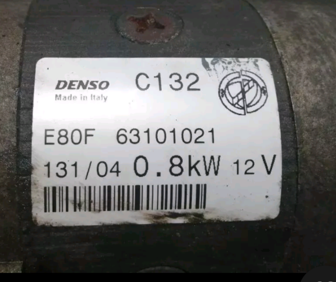

Here's a panda starter
Which works out at about 70A continuous
But it will pull over 200A for a fraction of a second
