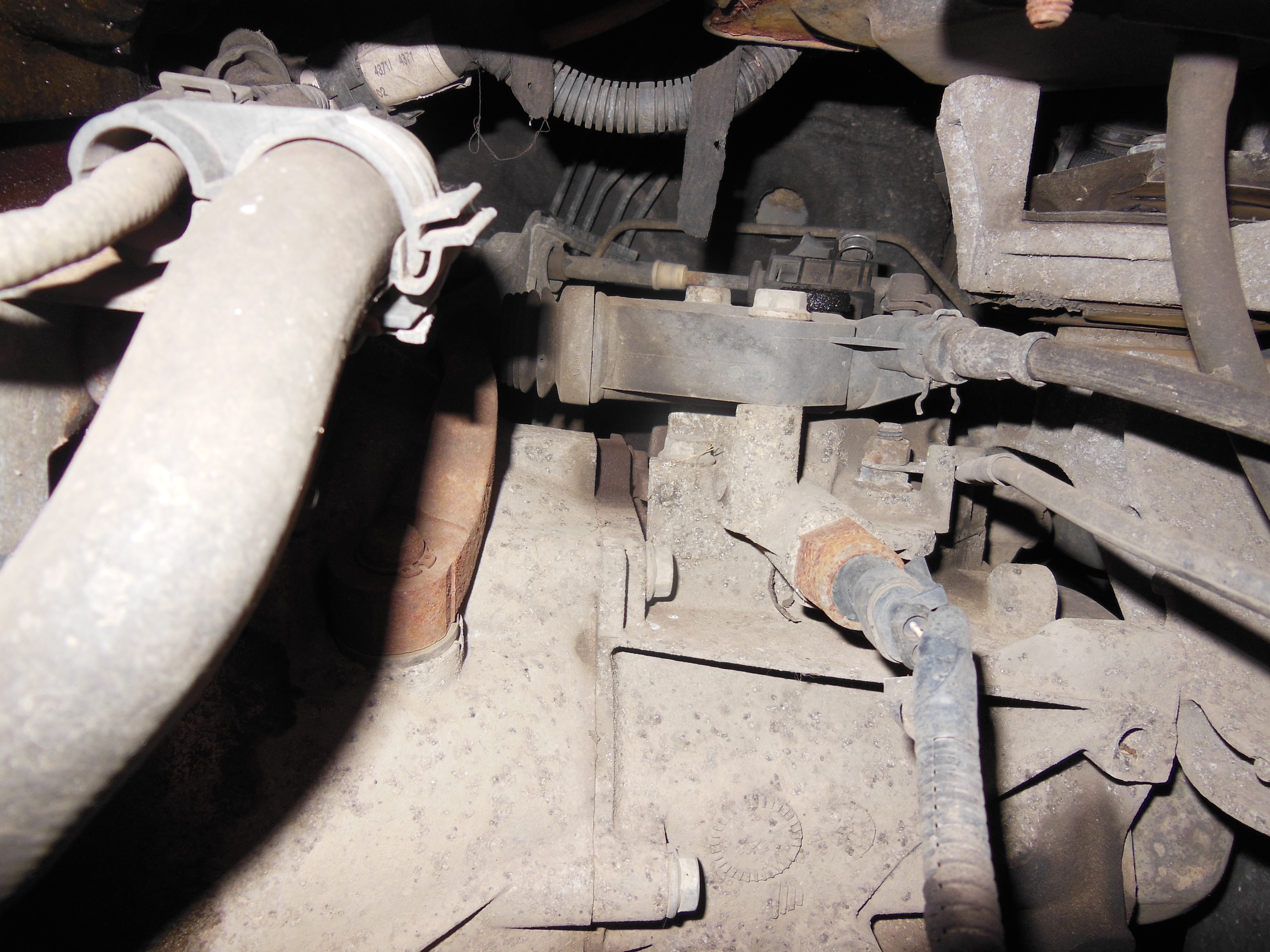

There seems to be so many different types of gearbox descriptions out there, is there anyway I can find out what the exact part code I require (most seem to be described like this 188A4.000 or 188A5.000 etc)
I'm at a lost to find the code, will try main dealers tomorrow, but do hold out much hope with them.

These are best I can do with G'box in the car, hopefully you will be able to tell from these.

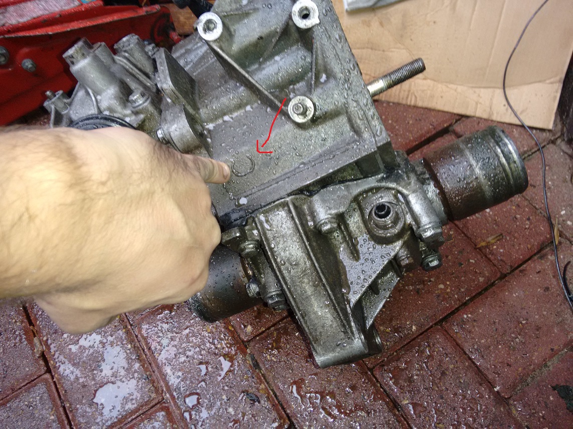

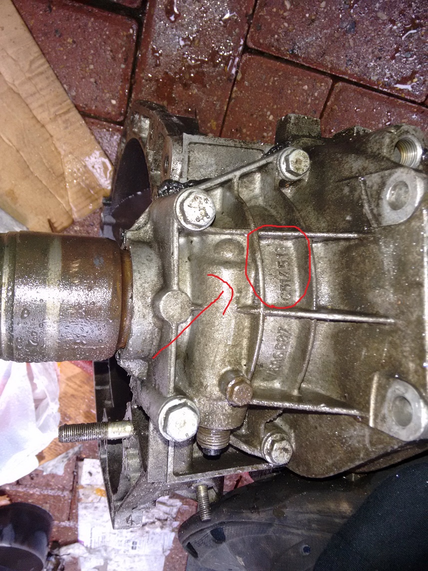

I'm running a Punto 1.2 8v engine (from a 2003 Punto 60) in my Uno and the gearbox you've listed above is the one I've used. In fact the first gearbox change I did was from a 2001 Punto 1.2 8v. As long as the engine is the Fiat F.I.R.E 8v engine (1999-2006) the box above should be fine. Any subtle revisions can usually be swapped across from your old gearbox.
The box you're looking for should be marked "C" and have a 514 code on it.
Thanks for the info, where would I find the
"The box you're looking for should be marked "C" and have a 514 code on it" on the gear box please.
Cheers:confused:
The "514" code is located under the gearbox.
The "C" marking is located on the area of the gearbox that faces the passenger seat. It is also in a difficult position to see.

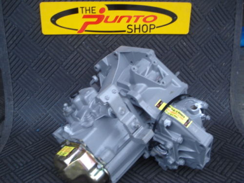

The only way you're going to get a guarantee that the box has been reconditioned to a high standard and that it won't die on you is to get one from a decent supplier. One that will offer you a 1 year warranty etc.
I haven't used these guys but if I was going to spend some decent money for some peace of mind I might look at buying one of their boxes. They seem to specialise in Punto's. Why not give them a call. I'm sure they'll be able to confirm what gearbox you'll need.
