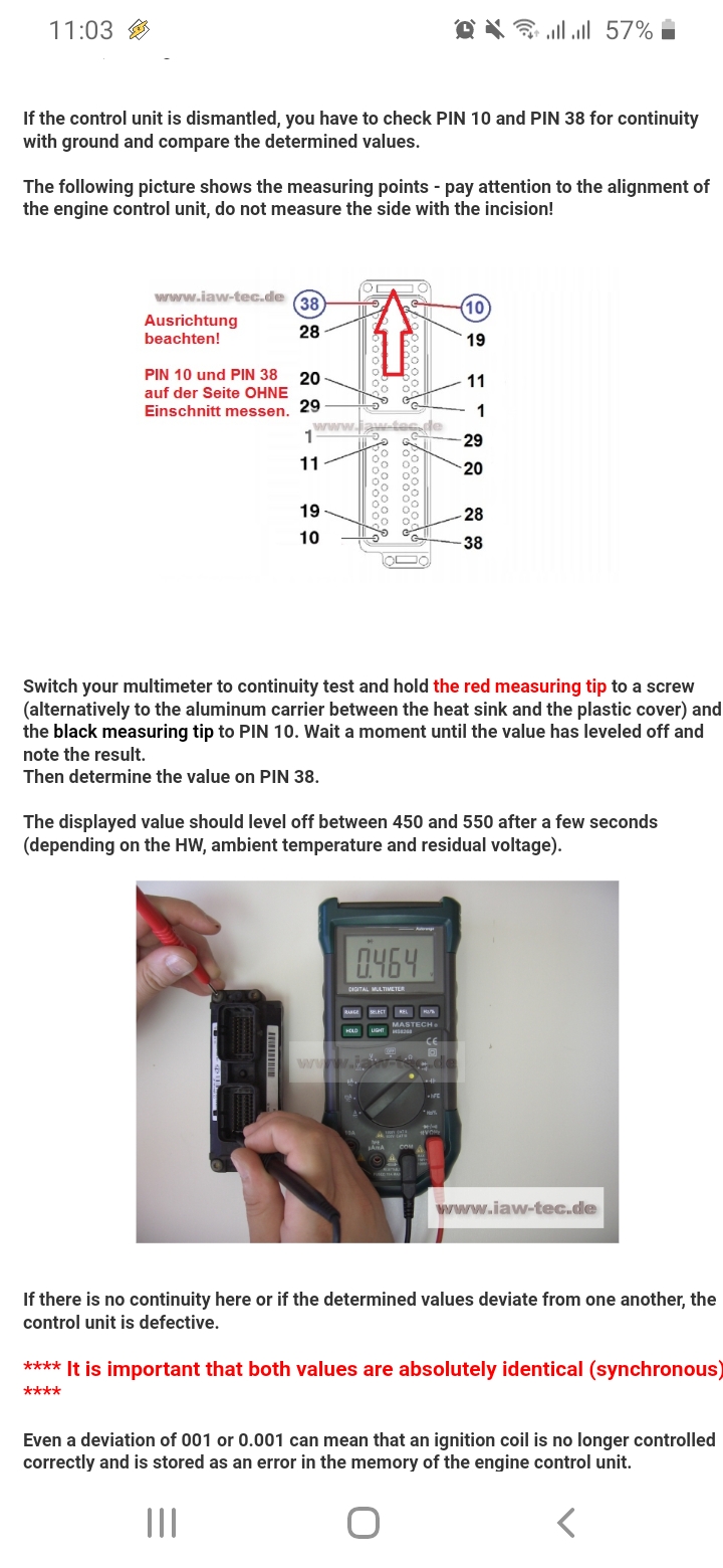

At mine, I also tested it with a testing lamp when the engine wasn't running properly. I probed the lines that go to coils and started the engine. And the (+) is always on, 12 V, but the (-) one is the one that goes intermittently. On the good circuit (coil no. 2) the lamp lit intermittently the 12 V light, on the other one (coil no.1), only the 6 V.
