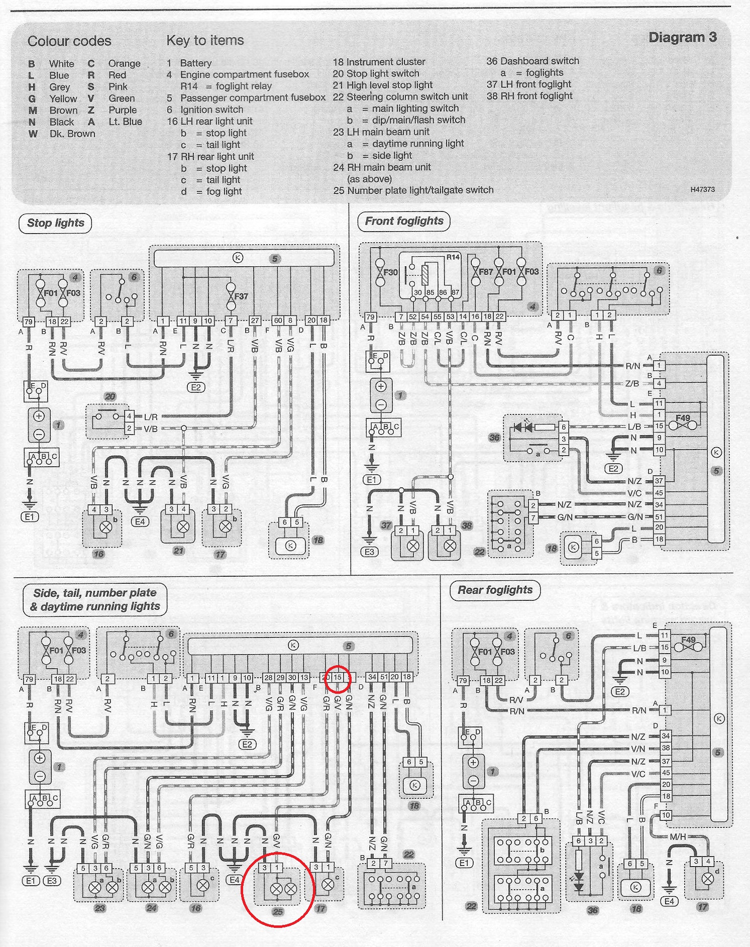

Checking the Haynes Manual (I noted the disclaimer regarding information available at time of print) I followed the wiring diagram below - acknowledgement to Haynes Publishing.
As can be seen the circuit runs from connection '15' on the Passenger Compartment Fusebox (5) to position (25) the Number Plate Light unit and Tailgate Lock Switch (not shown on diagram) and circled in red my me.

What is the meaning of the symbol on the schematic for the fuse box (5) in the circuit? It's not mentioned in the key for the diagram nor is there anything like it in the Periodic Table of Electronic Symbols. It's also on (18) the Instrument Cluster. And just an observation - I'm sure a connection block (using sprung copper contacts) could have replaced the wires in the flexible conduit, positioned in a bottom corner of the Tailgate assembly. Making the Tailgate work as a switch - when closed, power is fed to the wiper, high-line brake light, window heater, number plate lights with only the washer fluid pipe flexing in at the top.

if you are referring to the small to the small k symbol seen on the bcm/fuse box drawing its my understanding its Fiats way of identifying an electronic unit which is linked to the can-bus system which is borne out by the fact its also on the speedo unit 18 and sunroof 55.
