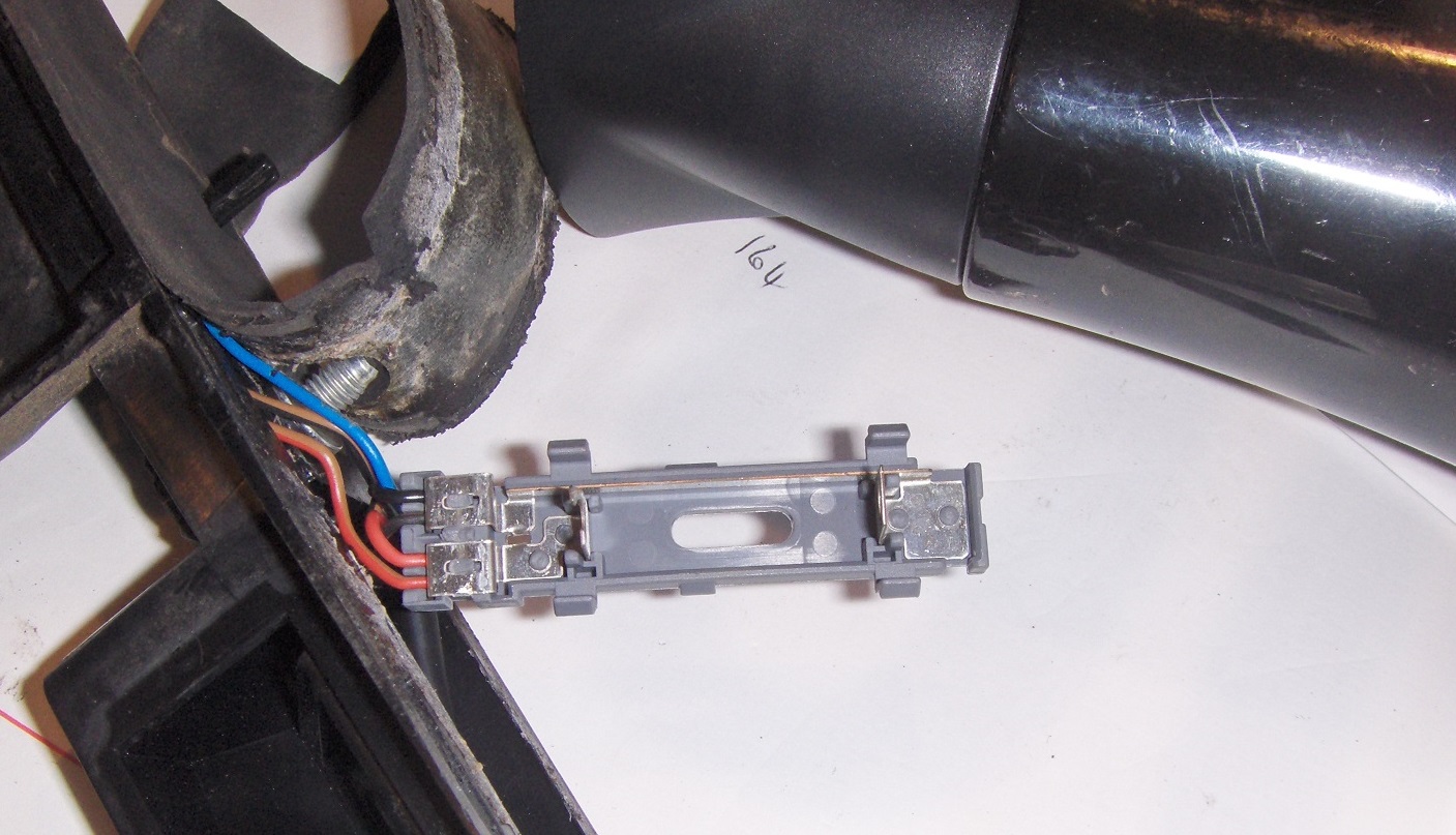

Guess what? Yep, during the recent cold damp spell, that yellow warning light on the dashboard showed its face again with the,' number plate light not working' warning. Of course I checked the connector first and that was good and tight. So removing the unit again and putting the terminals across a battery - nothing! I pulled the light/tailgate lock unit apart to find a rubber gasket in the way of progress. This was carefully peeled back halfway along the unit (from the connector end) using a hairdryer and craft knife. Heat the gasket to soften the adhesive then slice between the plastic moulding and the underside of the gasket with the knife. Work slowly and all will be revealed! Note: I could have just sliced into the gasket to reveal the lamp holder but seeing all the muck washed down between the back of the light unit and the tailgate - if any water got into that plastic section, it would just sit there and cause more problems. Anyway, after managing to get to a point I could access the lamp holder, I stopped peeling the gasket and unclipped the lamp holder (4 clips).
This is what I found:
From the photo you can see, The hairdryer (sorry about that!) The part peeled gasket and the grey festoon lamp holder. Now able to access this quickly highlighted the fault. The red positive wires to the terminal end of the lamp holder had good continuity. The ground/earth wires black & black with brown tracer were very high (over 100 Ohms) and giving an unstable reading. Both readings taken from the main connector to the terminal ends.

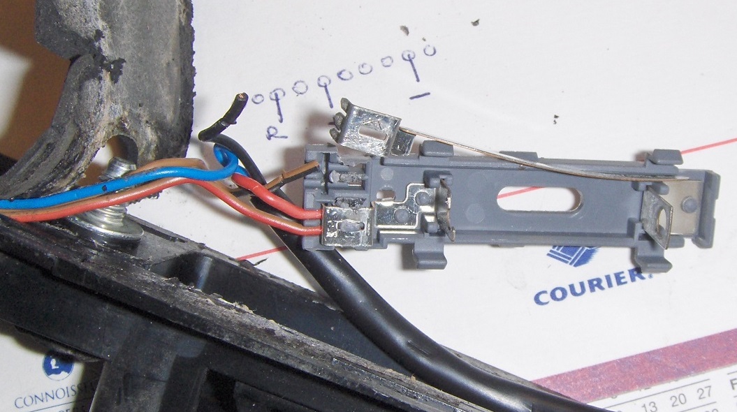

Here I'm removing the ground attachment to the terminal. I heated the plastic blob locking it in place with a small (18watt) soldering iron and levered it out with a small screwdriver. You can also see the crocodile clip from a 'Helping Hands' that is very useful during this operation. As it came apart, you could see the difference between the two wires. One had been half-stripped and the other, not stripped at all and just relying on the tapered slot to penetrate the insulation - probably a Friday afternoon job at the factory?
I now swung that end of the terminal plate clear and stripped the ends of both cables. I tinned the end of the wires but couldn't get a good fit in the terminal. In the end I went for a 'Belt & Braces' job answer, and bent up that centre finger at the cable end of the terminal plate, tinned it and soldered the two ground wires onto that - see below.
I finished off by squeezing it back into the plastic moulding with the tip of the soldering iron and it held ok. Clipped the lamp holder back into the main assembly, inserted a lamp and connected the battery - all worked well, so I then carefully re-laid the gasket.
