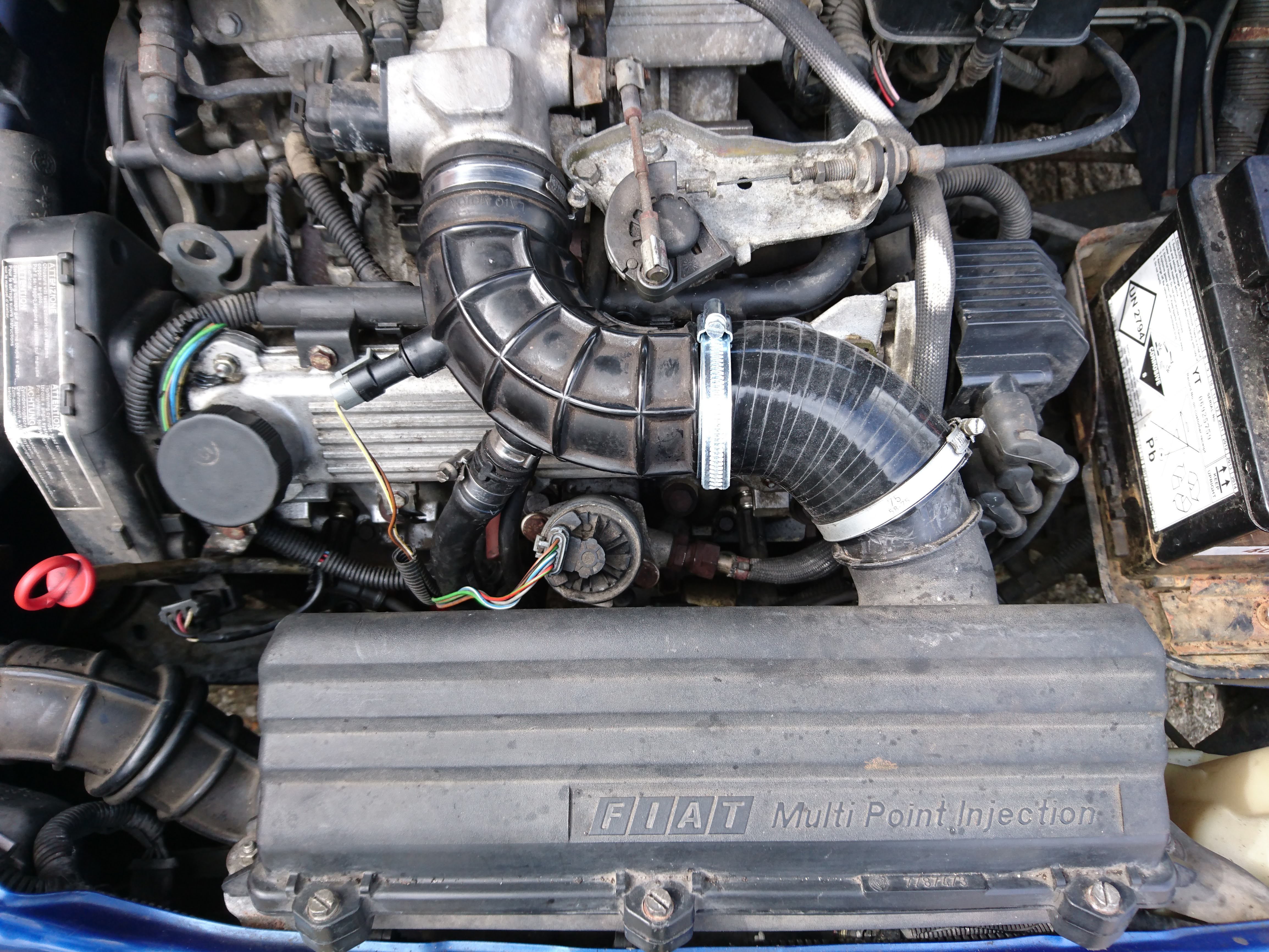

Here is my 'good enough' bodge from years ago, it is not glamorous 😂
That Throttle linkage 🤣 typical Italians using multiple parts where one would do.
Yes it is quite the marvel of unnecessary engineering, not as bad as my mk2 Panda's which did a full 180º turn for some reason, causing it to eventually snap on the A3. Fortunately there was an alternate throttle linkage & cable available which funnily enough went straight from the pedal to the linkage rather than make the elaborate turn
