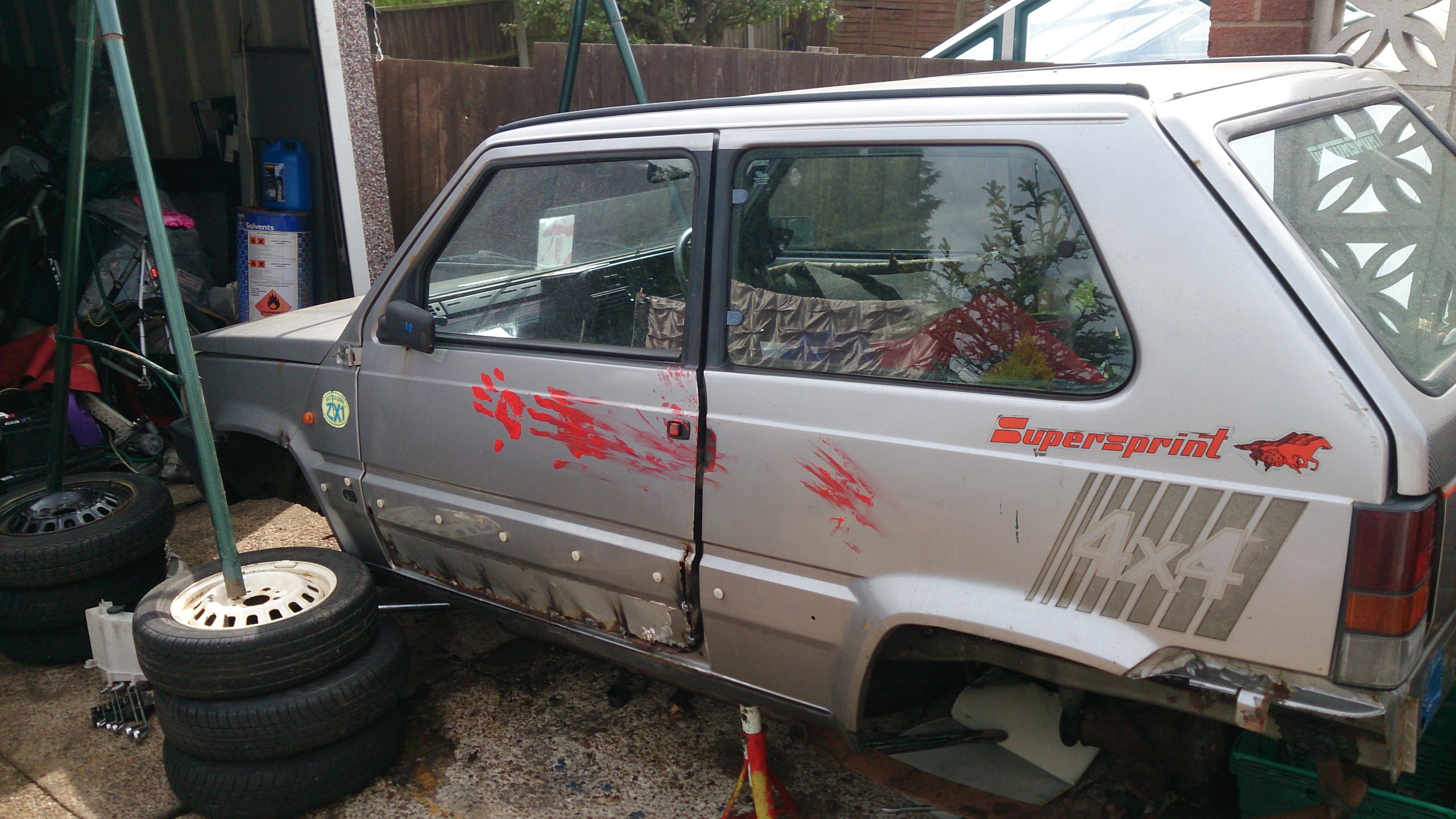

First off. i need to get the panda all well and good.
a few things are broken... the exhaust, the front suspension on the passenger side, both rear dampeners are rusted out, the doors are shot but i will try to fix them, the gear stick is really loose and all the roller bearings have dropped out, the wiring is a mess (mice attack!), there are no brakes.. and i mean no brakes, and lets not forget the underside rust.
so today i started by stripping out everything inside the car to get a good look at the floor pan and clean it all out (Dragon Man style!) i found the usual rust: the boot floor is a mess, but easy fixable, a seam has gone just behind the drivers seat anything forward of that seems to be OK, and the back of the sills are just gone so i will need to rebuild that.
the engine runs.. the vac advance line has split so its a bit rough on tickover but it seems good. the fuel tank seems good.. all the 4x4 stuff seems good.

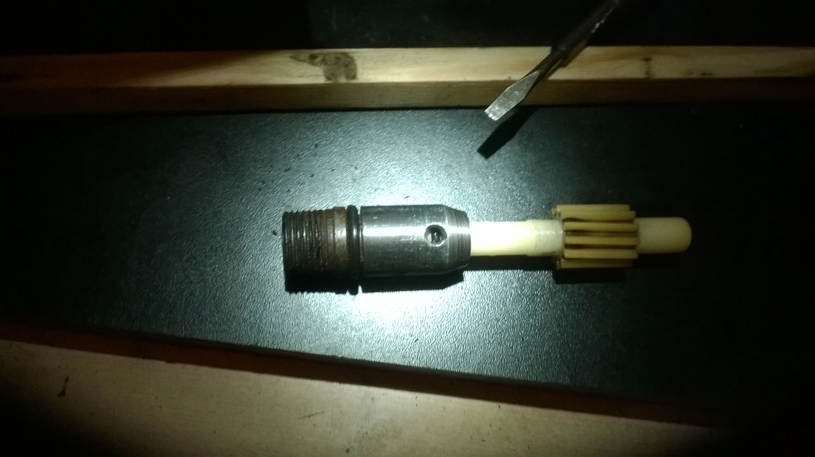

i also found out how to fix the annoying leak from the speedo drive on our panda gearboxes
check the video out for a bit of a talk about it, and how to fix it!. firstcar-Y10
{{Edit}}
that video messed up. for some reason i had no audio on it?! anyway im going to have to remake the whole damn video again.
to fix the speedo drive you have to undo the little alen key bolt from the side where the speedo drive is, and use something like some long nose mould grips to clamp onto the threads (low down on the threads) the speedo cable screws onto.. then leaver it out by pressing down on the mould grips.. the whole thing you screw the speedo cable on will come out of the gearbox along with the plastic gear that picks up the speed from the front diff.
on the shaft theres a little rubber washer, that will need replacing... replace that and no more leaks from the speedo drive :D
that is how you fix it!
Yep, I'd got that far, but whenever I try to replace the spindle with the new O ring on, the hole for the fixing screw takes a chunk of rubber out the side of the new ring. Maybe I just need a slightly thinner O ring, I was looking for a reasonably tight fit.
theres another o ring inside on the plastic spindle.. that is the one i find that passes..
besides, the outer O ring does not go down far enough to get damaged by the fixing bolt hole..???
the one on mine does not...
This O ring: (on the white spindle)
This hole:
Don't know if yours is different?
mine is the same.. but it does not chew up the washer.. id file it out..

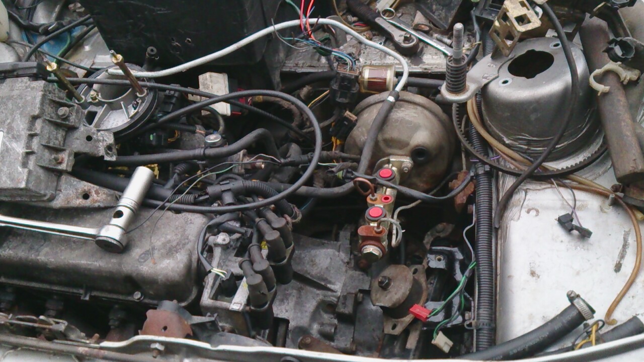

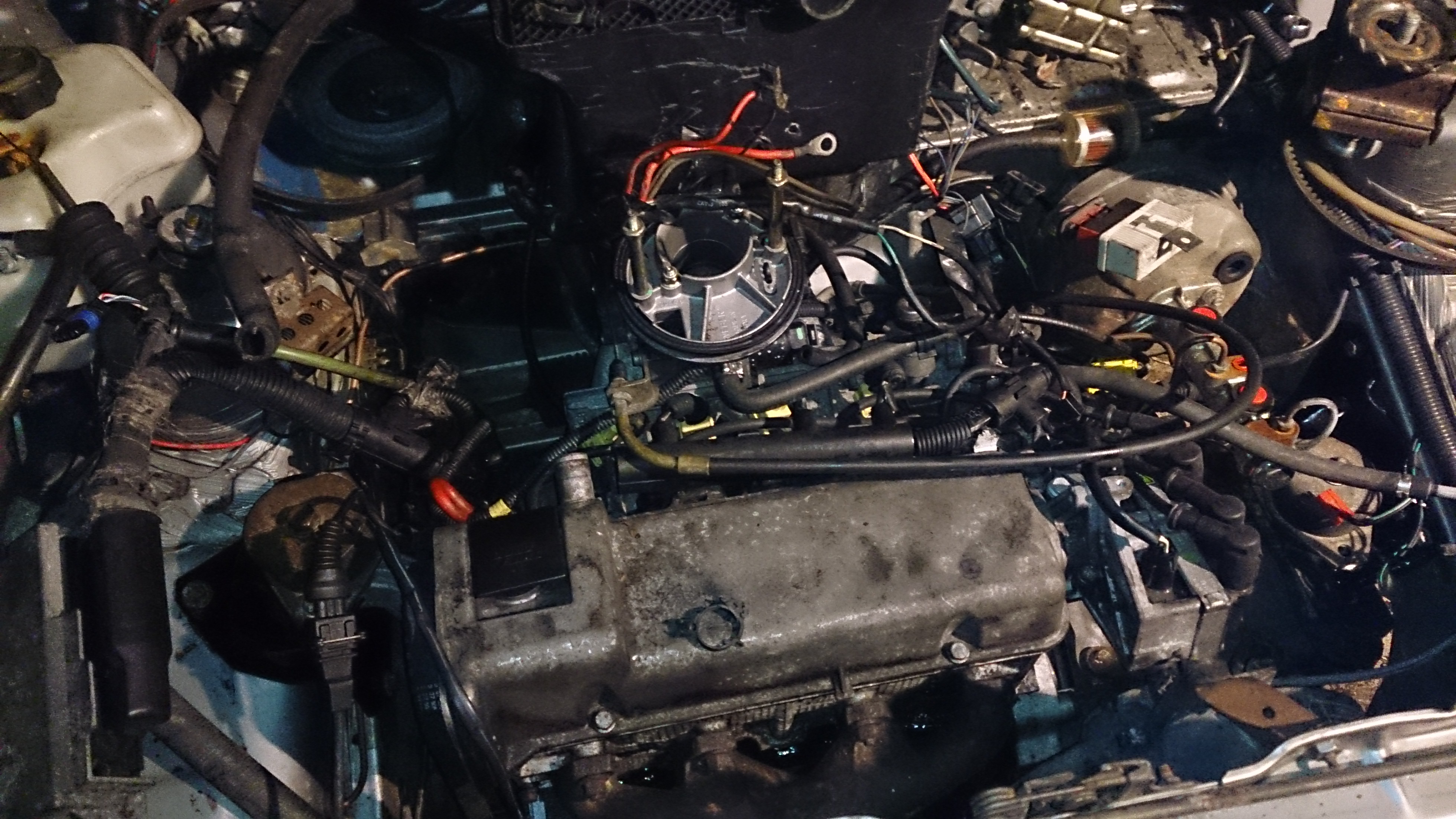

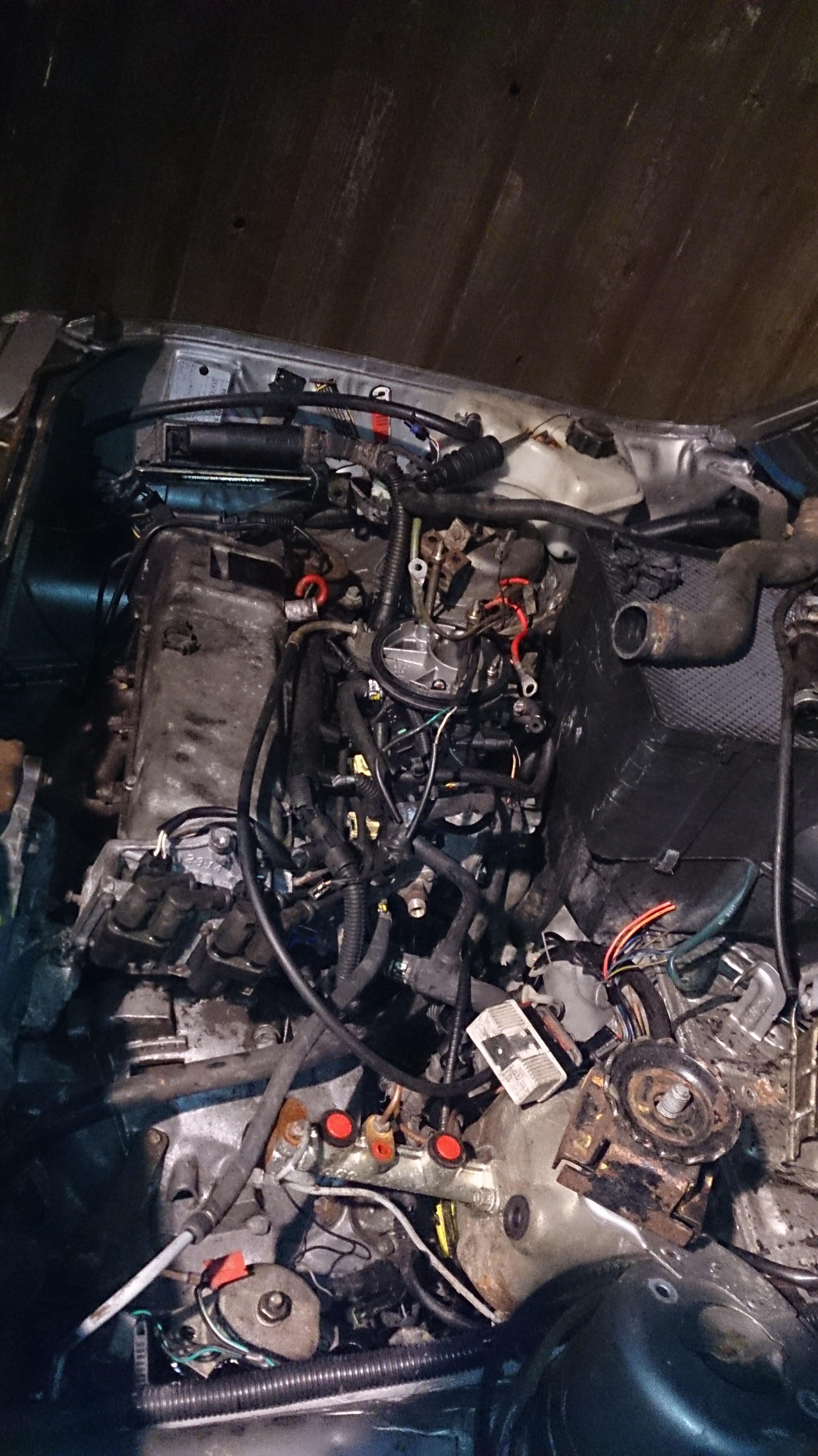

fallouts engine is all wired up! i am using the 6F ECU from off a 899/903cc cinquecento (no immobiliser)

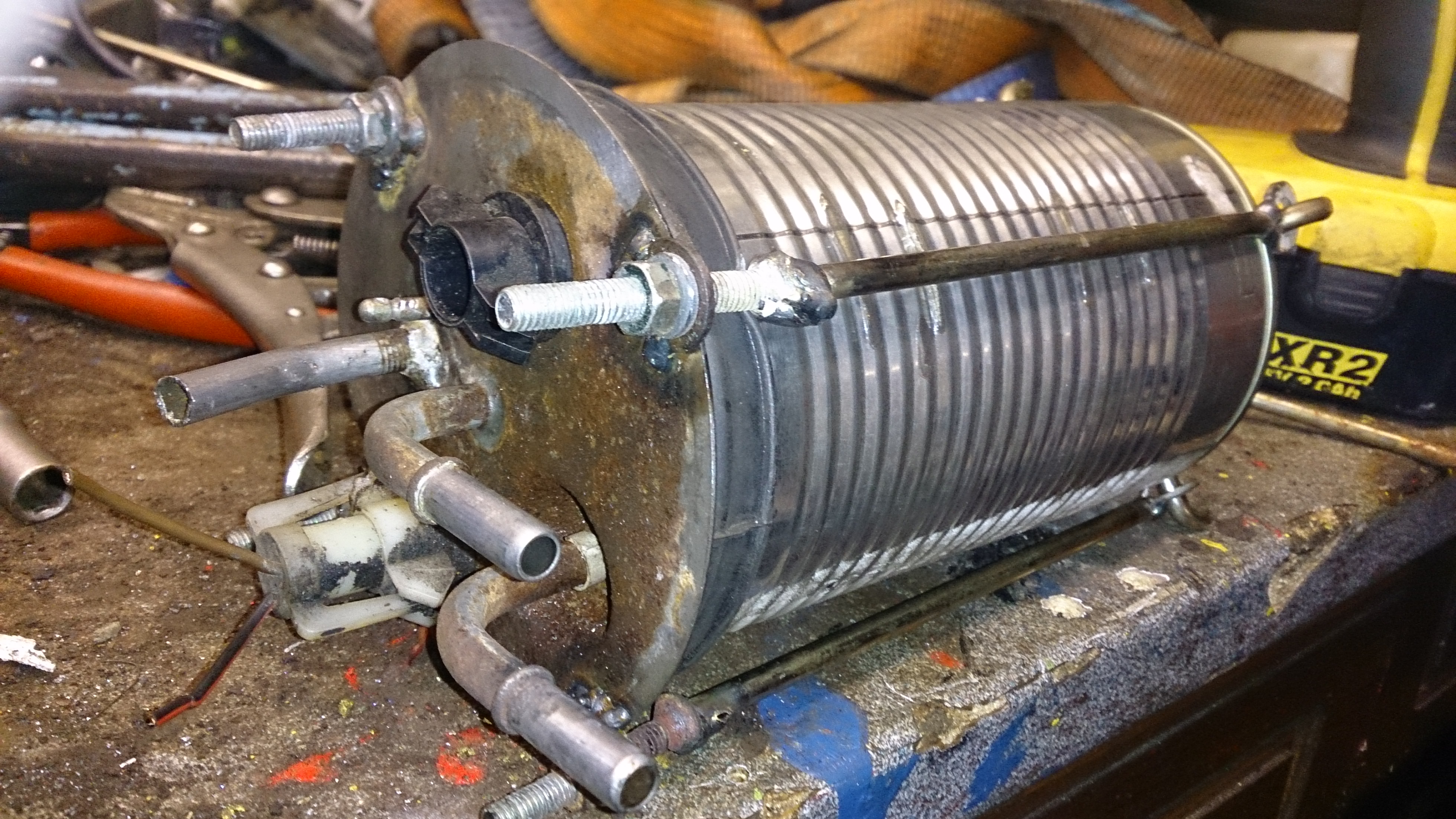

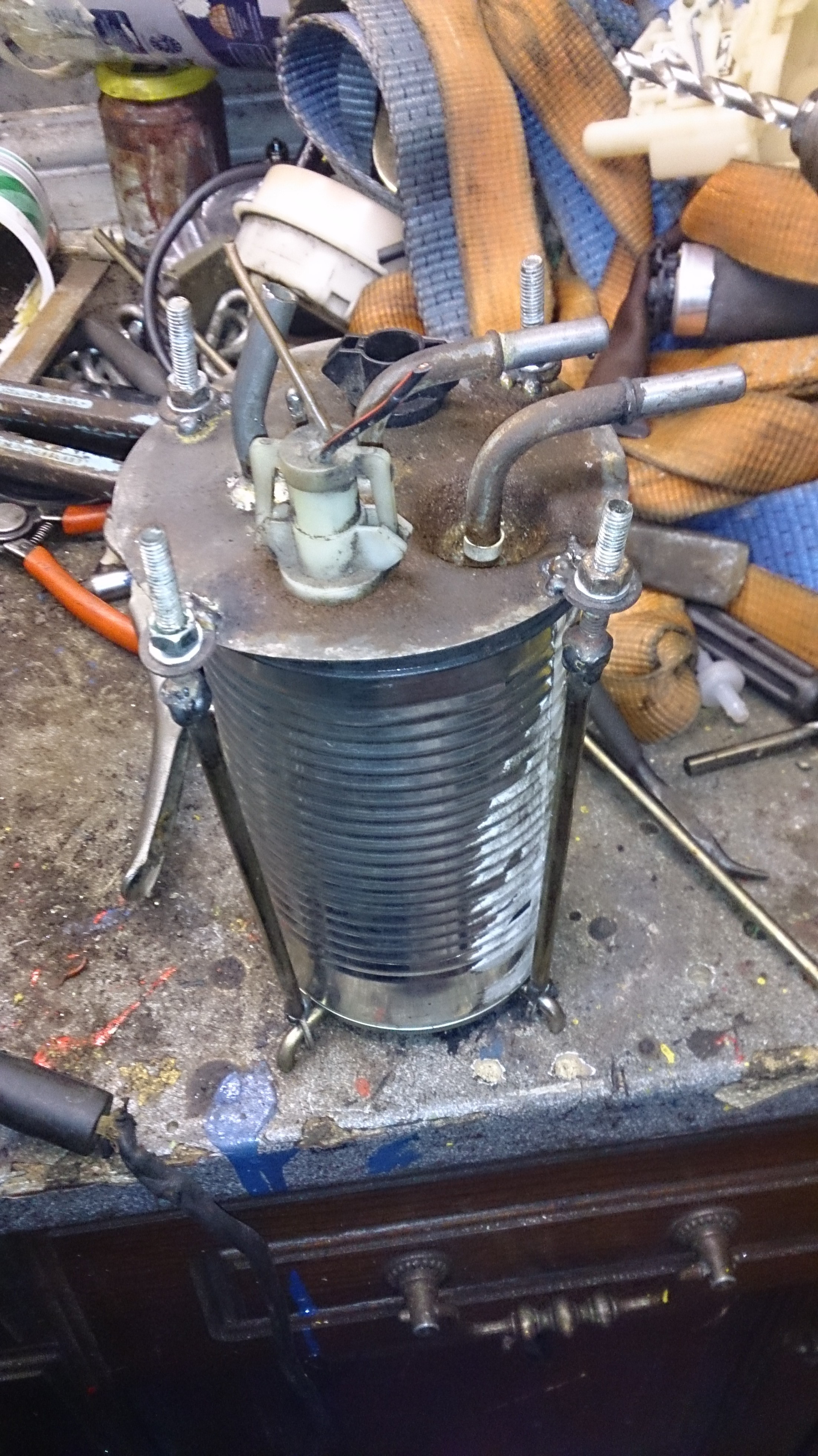

i have but one setback.. the fuel pump.
theres no way in hell i can fit it in the panda's tank.. its just too big.
does anyone know of a car (one that i can find in the scrap yard) that has a high pressure in line fuel pump?
theres no way im spending anything more than £20 on a fuel pump and even at that i will be looking for a cheaper way to get one.
it sux how everything is in tank now days :(
