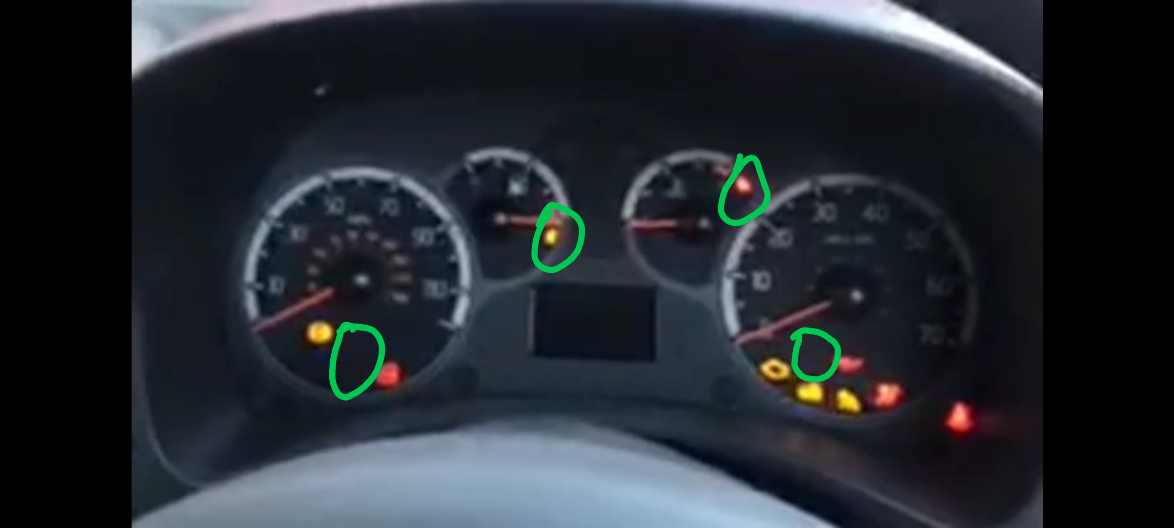

Quite a big difference in the three video clips
This one
No battery charge light until cranking
No clock display at all
Oil light stays on much longer
No brake test bulb
Are they consistent if you start the car several times
Battery and brake are significant as both need to correct for the steering to work

It’s the same each time

it was cold start so oil light may have took longer. Display screen is mostly off and has been for over a year may be 2 years. Comes on intermittent but the power steering light has gone back off
At the power on self test
They don't look the same to me
Vs
If electronics are dead, generally it stays consistent, occasionally they are temperature related
Generally damaged wiring, dirty connectors, poorly battery are often much more random in nature
Clock not working intermittently is very unusual, I know of two cases and you have both
Do you have both keys on the same keyring
The fact you have the clocks, battery, brake, abs, steering lights, all doing odd things points more to an underlying fault than the EPS in itself

The remote key played up so we use the ordinary key as easier,they arnt together
