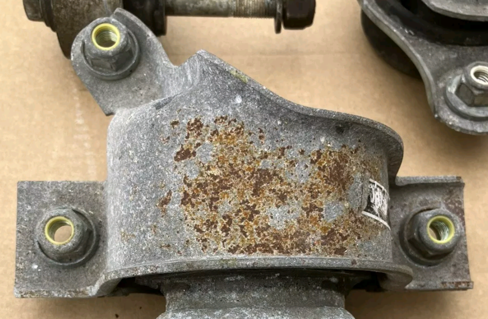

Try battery plus to battery plus
Battery negative of the other car to the drivers side engine mount, this bit that actually bolted to the frame
Start other car and test a few times
