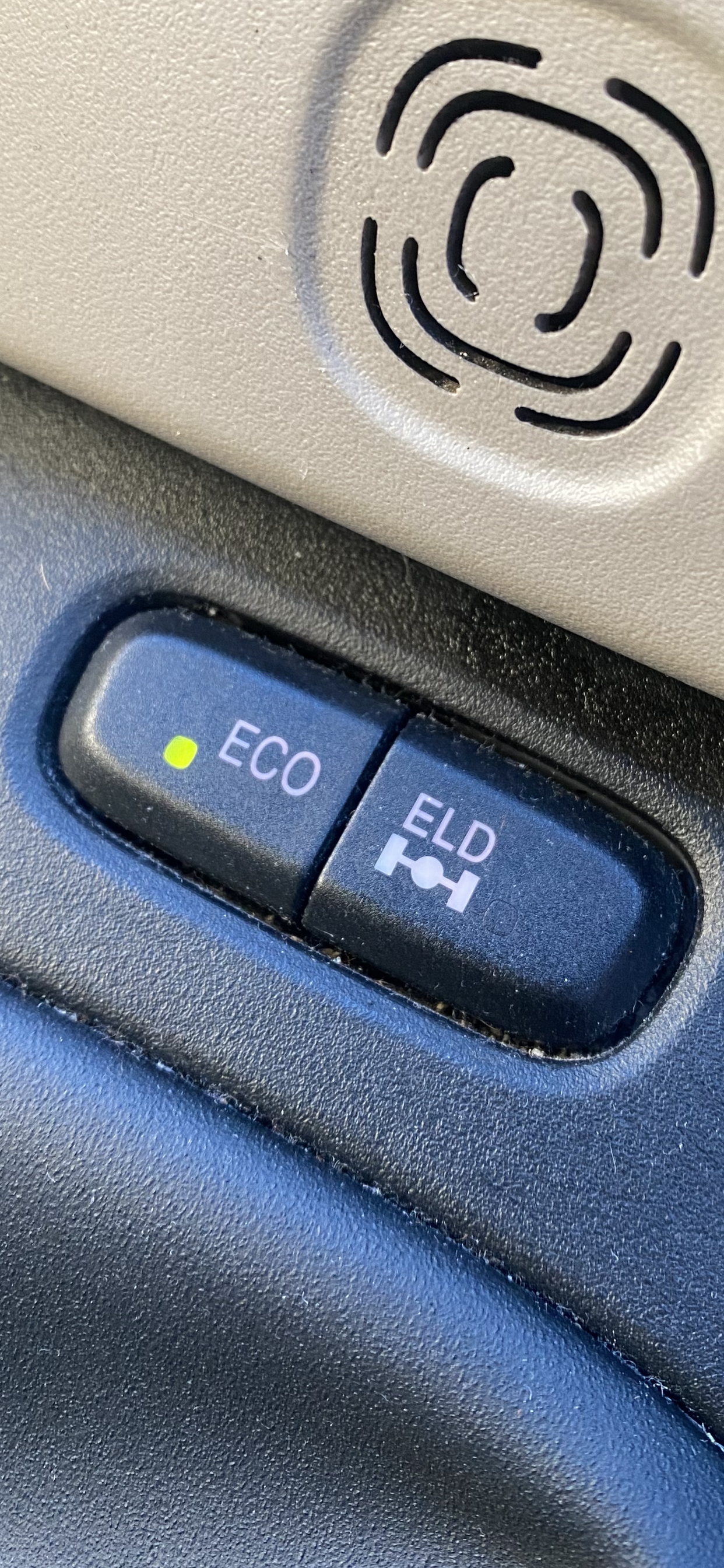

Piccy attached of the switch in question, it’s a 2013 — 312A2000
That’s an idea on the wastegate stuck as there might be a boost pressure sensor that can cut out the ignition, I’ll have a look, appreciate the reply’s … 👍
