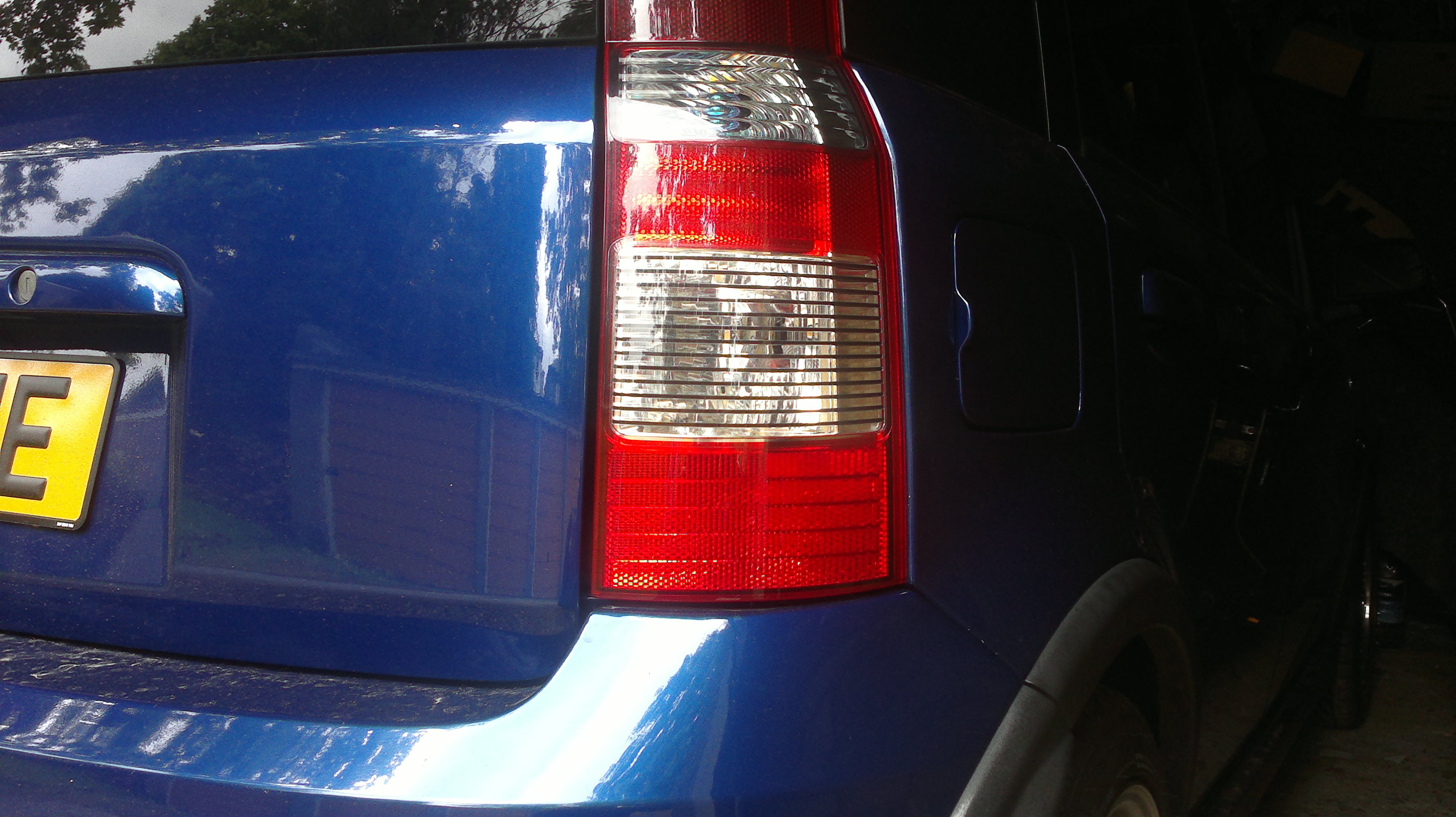

Right then a have done the clear rear fog light mod! and I am soooo happy with the results and it cost only £10!!!
This is a great mod to do to balance up the rear end of your panda!

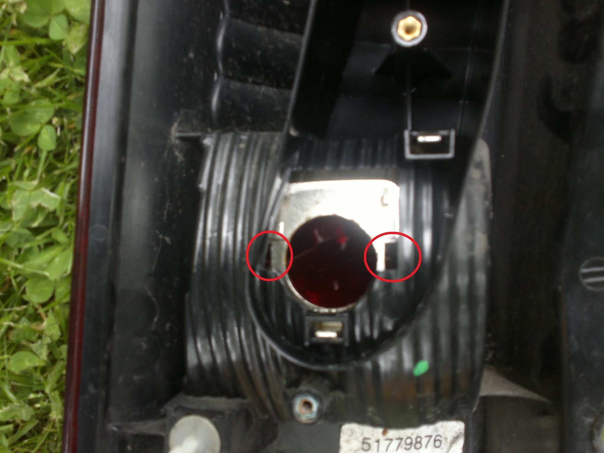

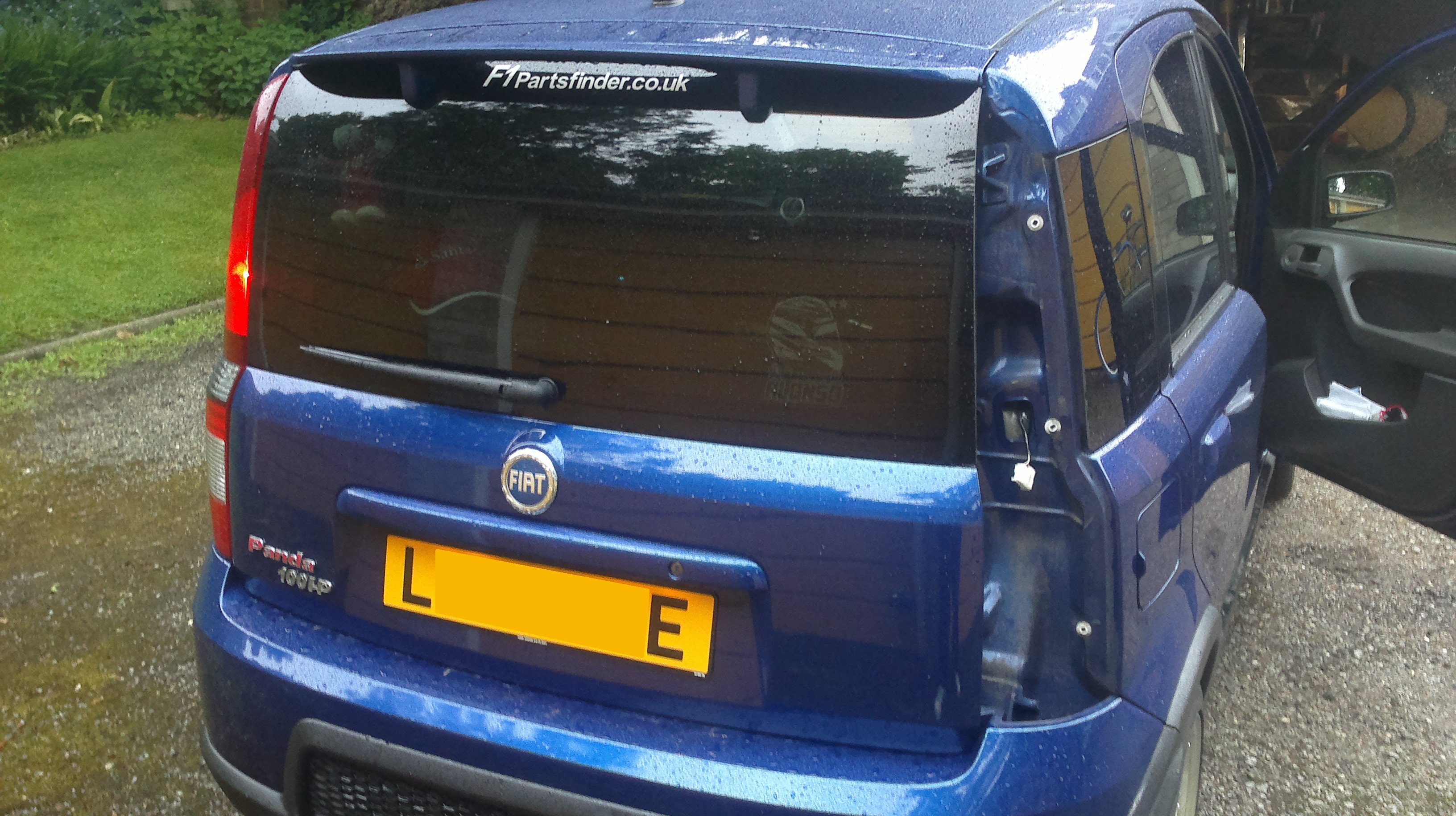

Step 1 remove the rear light cluster,
Step 2 unclip the red bulb cover which then leaves it lose in the light units itself (it is to big to just pull through the bulb hole booo)

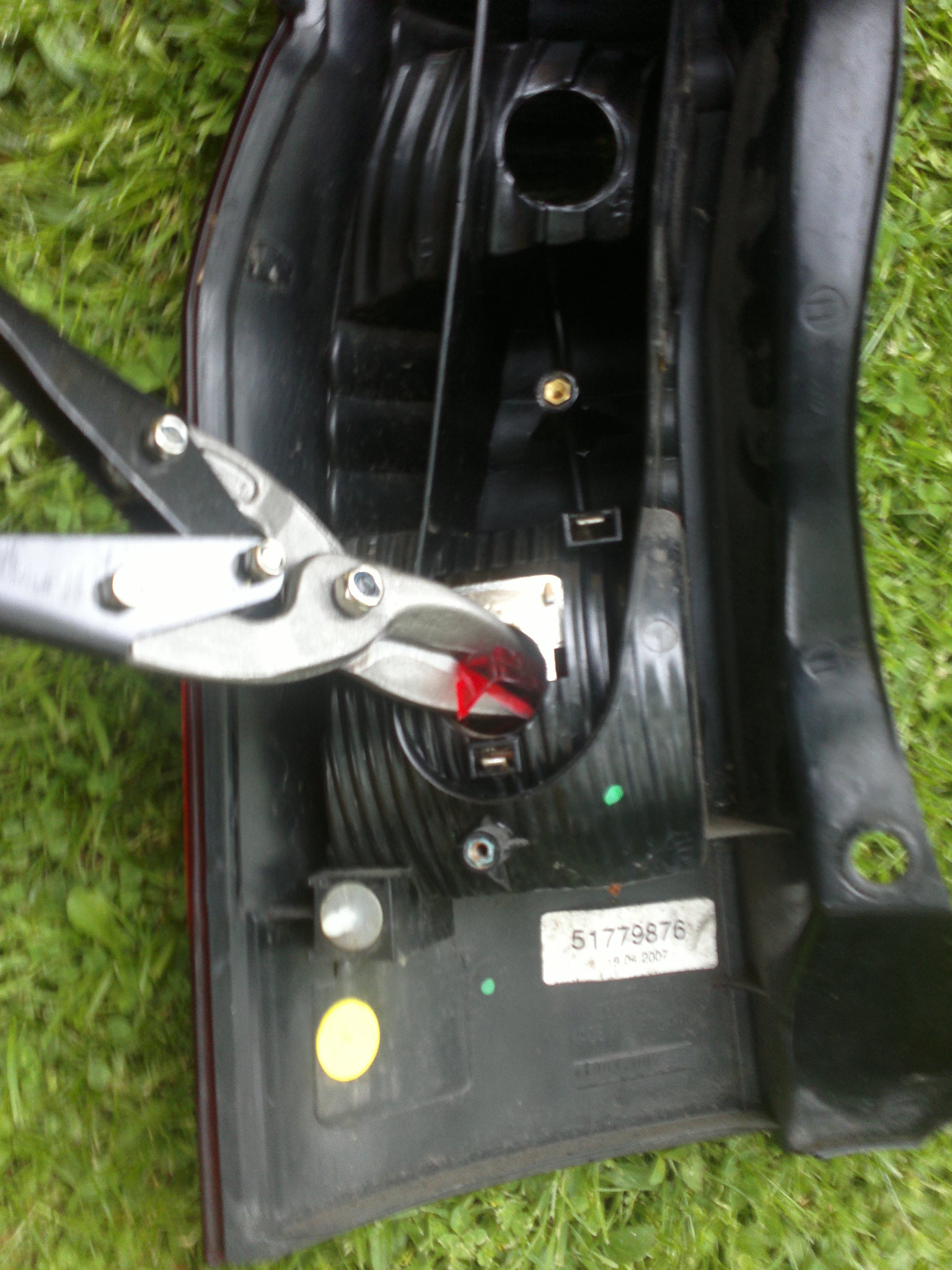

Step 3 use tin snips to start to cut up the cover http://www.ebay.co.uk/itm/171047706859?ssPageName=STRK:MEWNX:IT&_trksid=p3984.m1439.l2648 this takes about 5 min take your time and you will cut it down to small enough sections to pull out through the bulb hole!

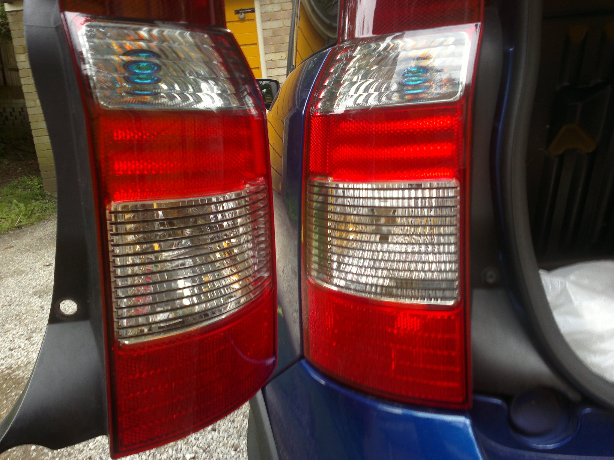

Step 4 Fit silver tinted red bulb and stand back with satisfaction! :D
Before
After
