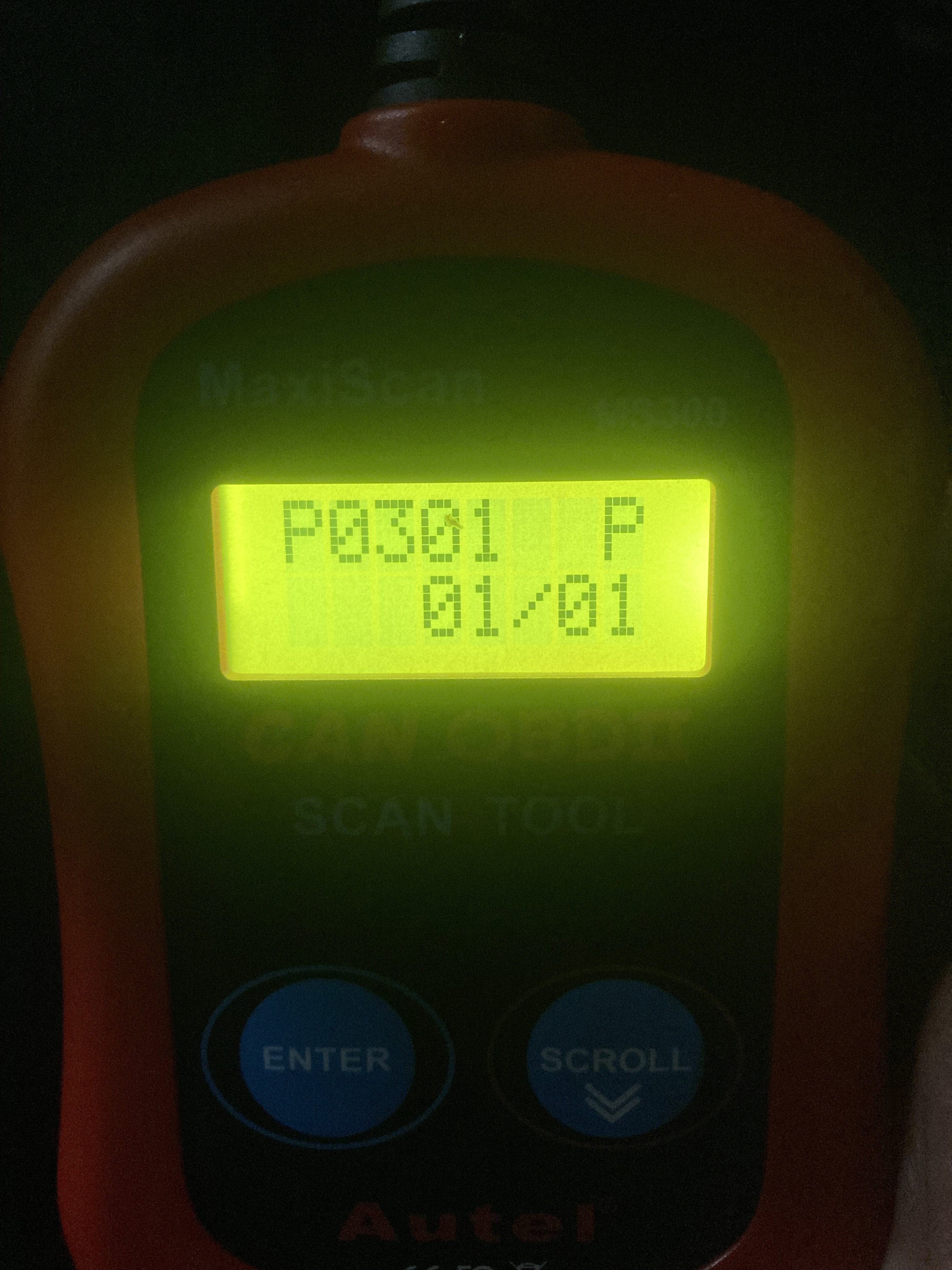

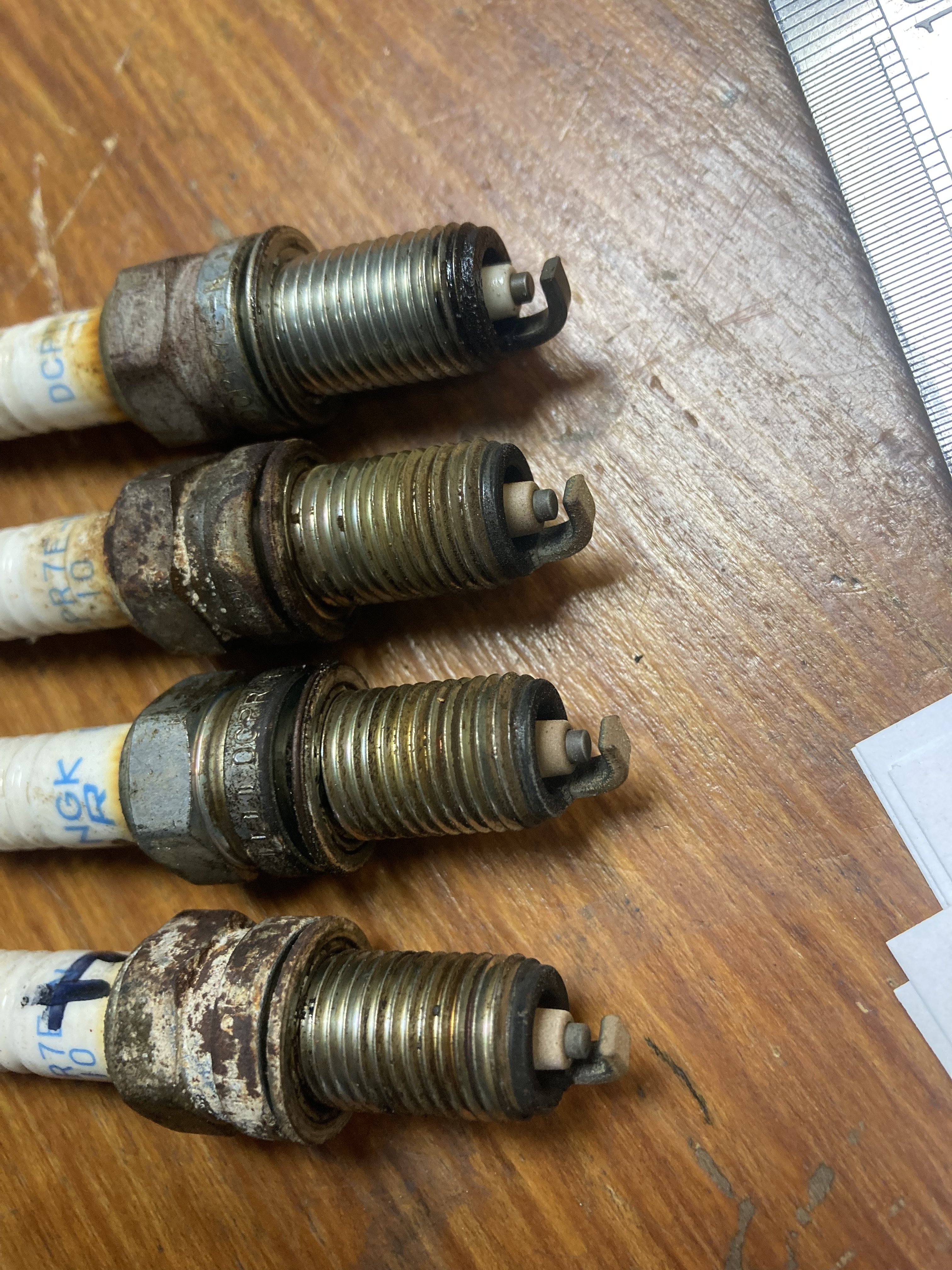

So I popped out to the shops Sunday morning and I was greeted with a lovely misfire! I plugged in my diagnostic tool and got a p0301 code with points to cylinder 1.
All the coils were replaced last year so I thought that’s odd.
I took the air box off and it looked like the clip for coil 1 wasn’t pushed home fully with a bit of a push it clipped on.
The fault code was cleared and I thought happy days.
I went out for a test drive and nope still a miss fire underload from 2nd gear onwards at about 2,5k rpm but no warning light this time or no fault showing.
I then swapped out coil 1 for a good old one I had and still the same issue.

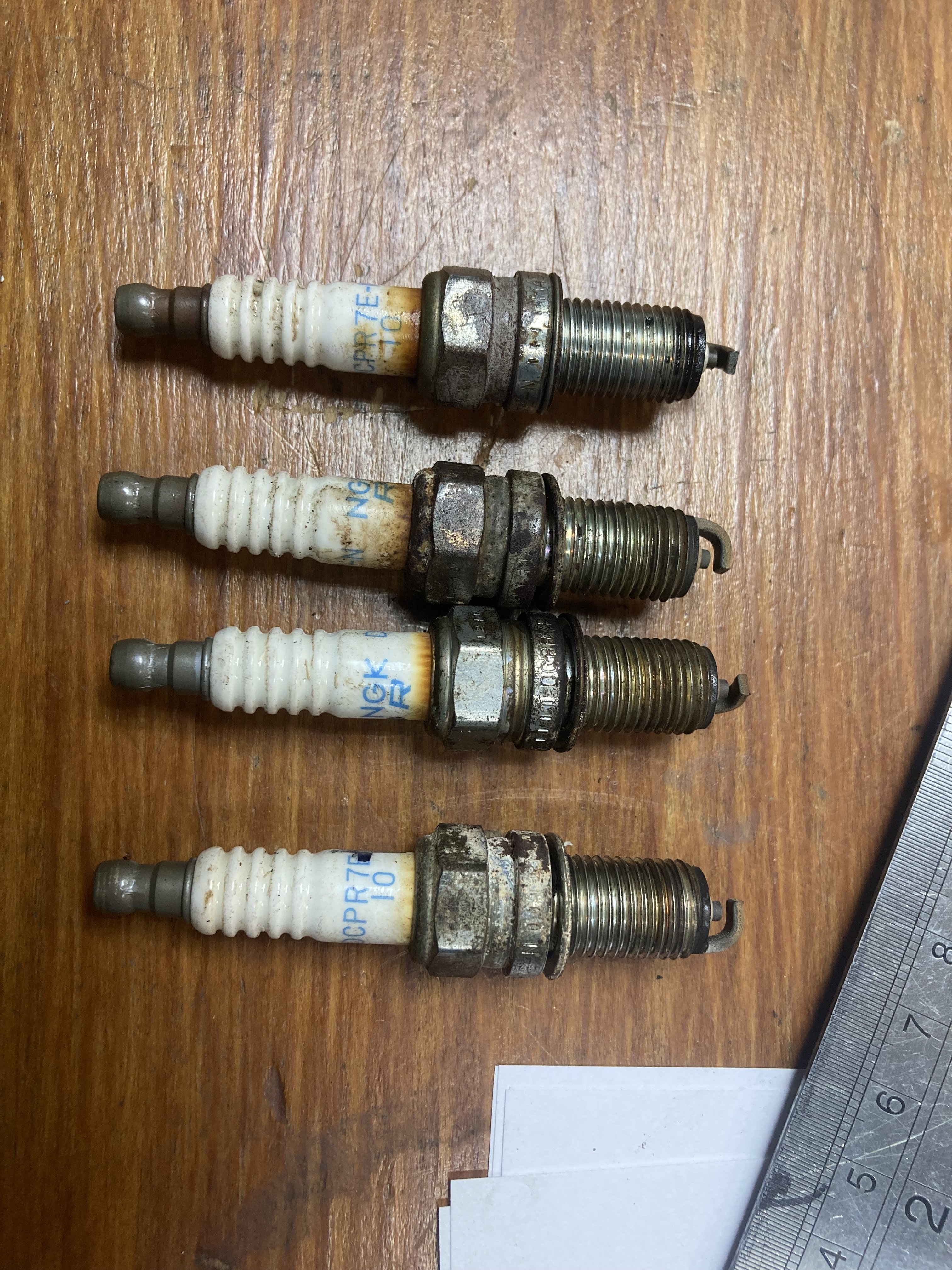

So it could be a plug (I didn’t remove it as literally hate doing spark plugs with a passion) but it looks abit rough from the top (think it was replaced in 2022) but
I did feel driving it last week under hard acceleration it almost feeling like it was tightening up.
So I got it fixed today! when I bought my panda back last year I could see in the service history it had a big service in 2022 where the plugs were apparently changed.
I hadn’t bothered to do them as they were only a couple of years old.
I took the car into DTR and Charlie (top bloke there) had a fight on his hands to remove spark plug number one as it was firmly stuck!
As you can see by the pictures they are all ****ed, my guess is they are the ones I had replaced at Fiat in 2018 and the garage never actually changed them in 2022!
Anyway a new set of NGK’s have been fitted and the Pandavan is driving like a new car!
The lesson don’t always believe the service history!🇮🇹🐼💙

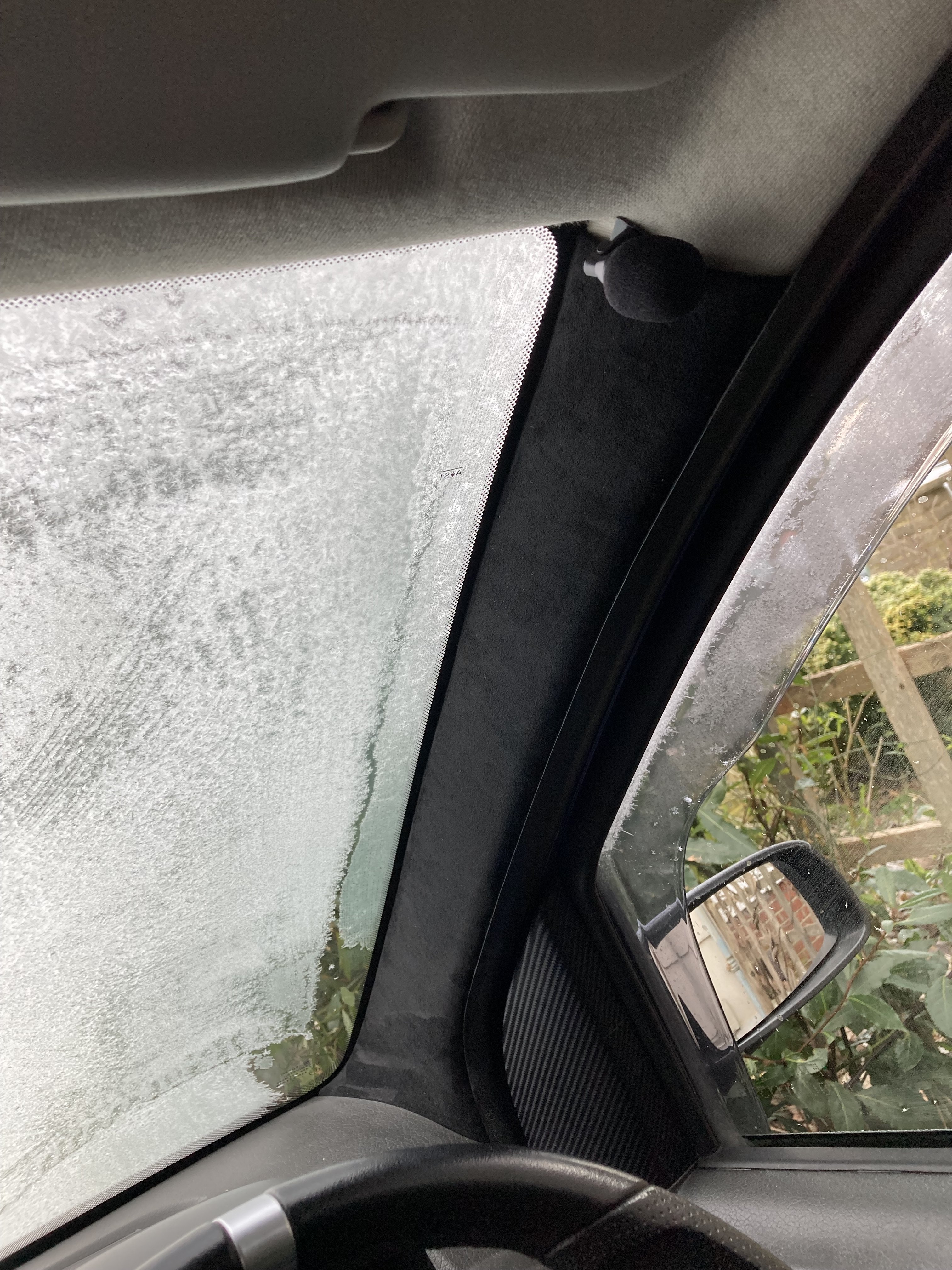

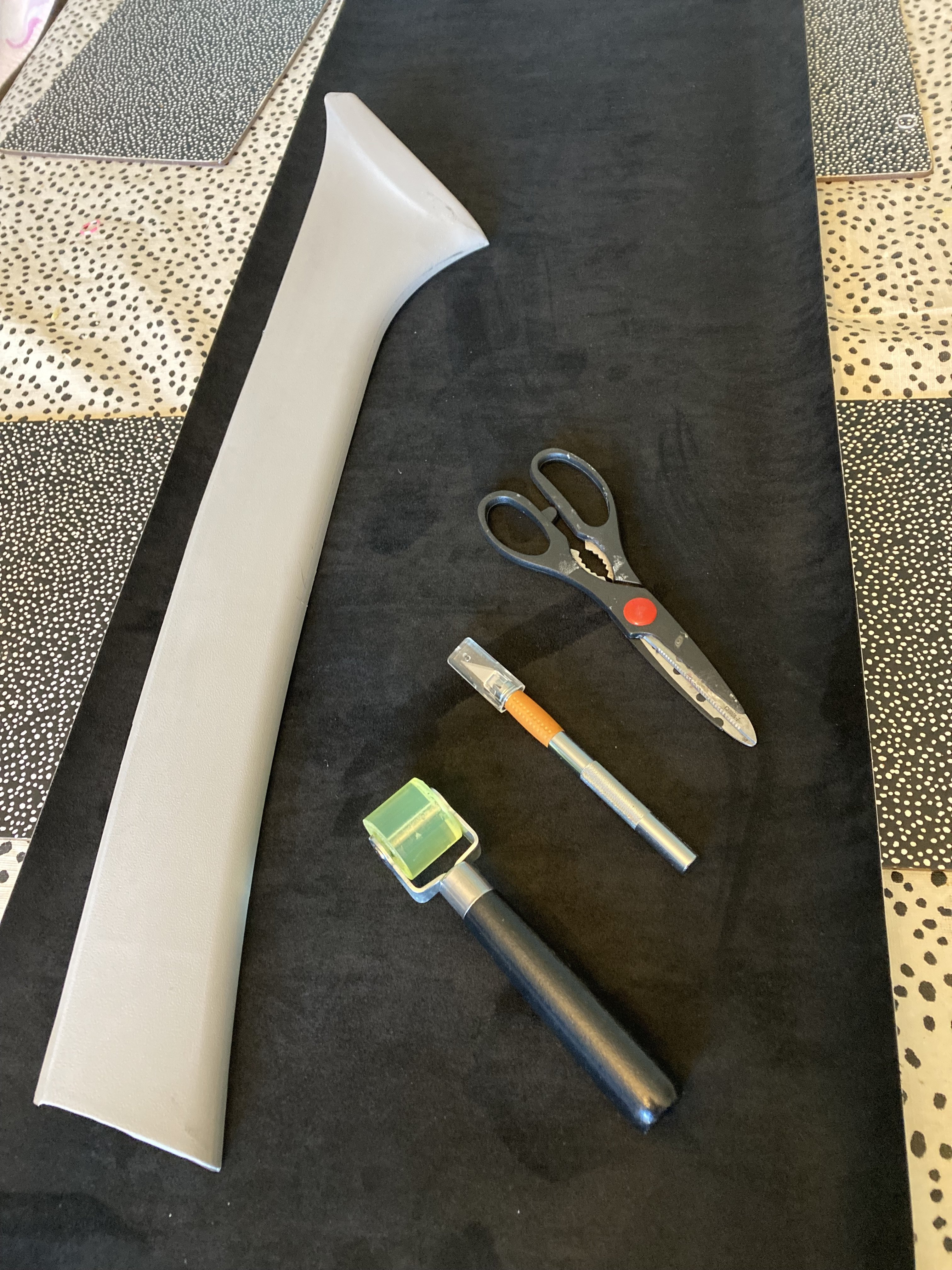

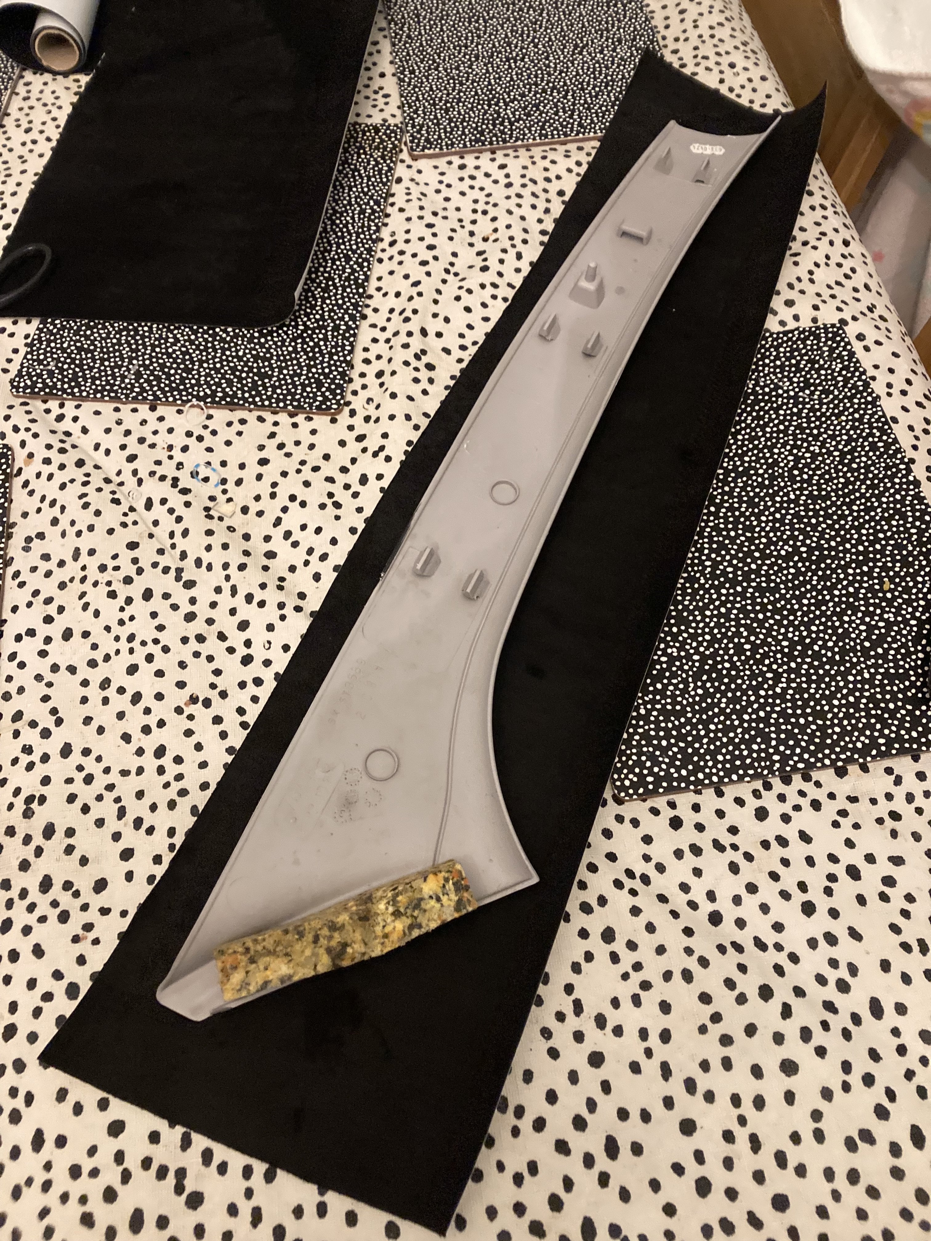

I don’t think the photos do it justice, I’m so happy with how the A-pillars came out with the suede covering. Who knows how long it will last but looks great!
Next job is the roof liner! 🐼🇮🇹💙

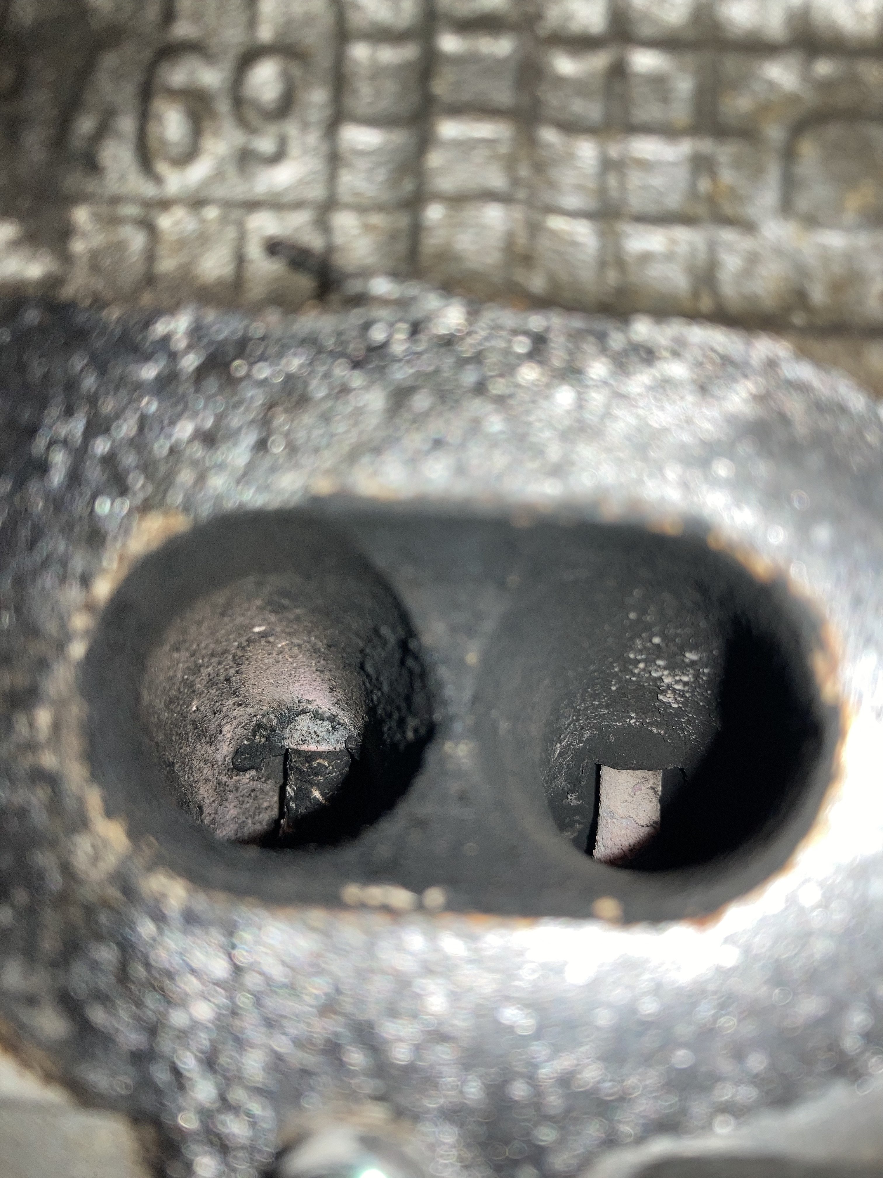

Sorry for the lack of updates, so the garage came back and basically condemned the engine as uneconomical to repair due to the compression being low on 3 of the cylinders potentially pointing to piston ring issues on top of the head gasket issue.
The cost for them to go in and investigate by taking the head off and then them finding out it is a bigger issue wasn’t worth the risk.
I thought this might be the end for the pandavan as basically I now have a car with a scrapped engine!
I am happy to report I’m currently in the process of fitting a new 63k mileage engine thanks to Ryan Lynch for saucing.
Pictures and a full write up to follow!
A big investment but I think the car is worth it!

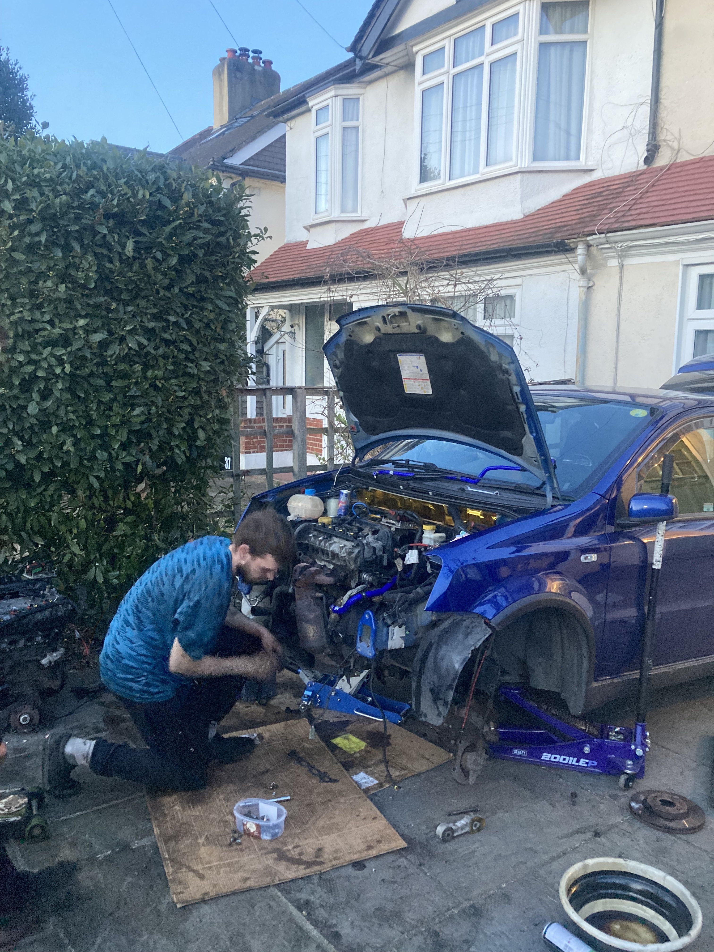

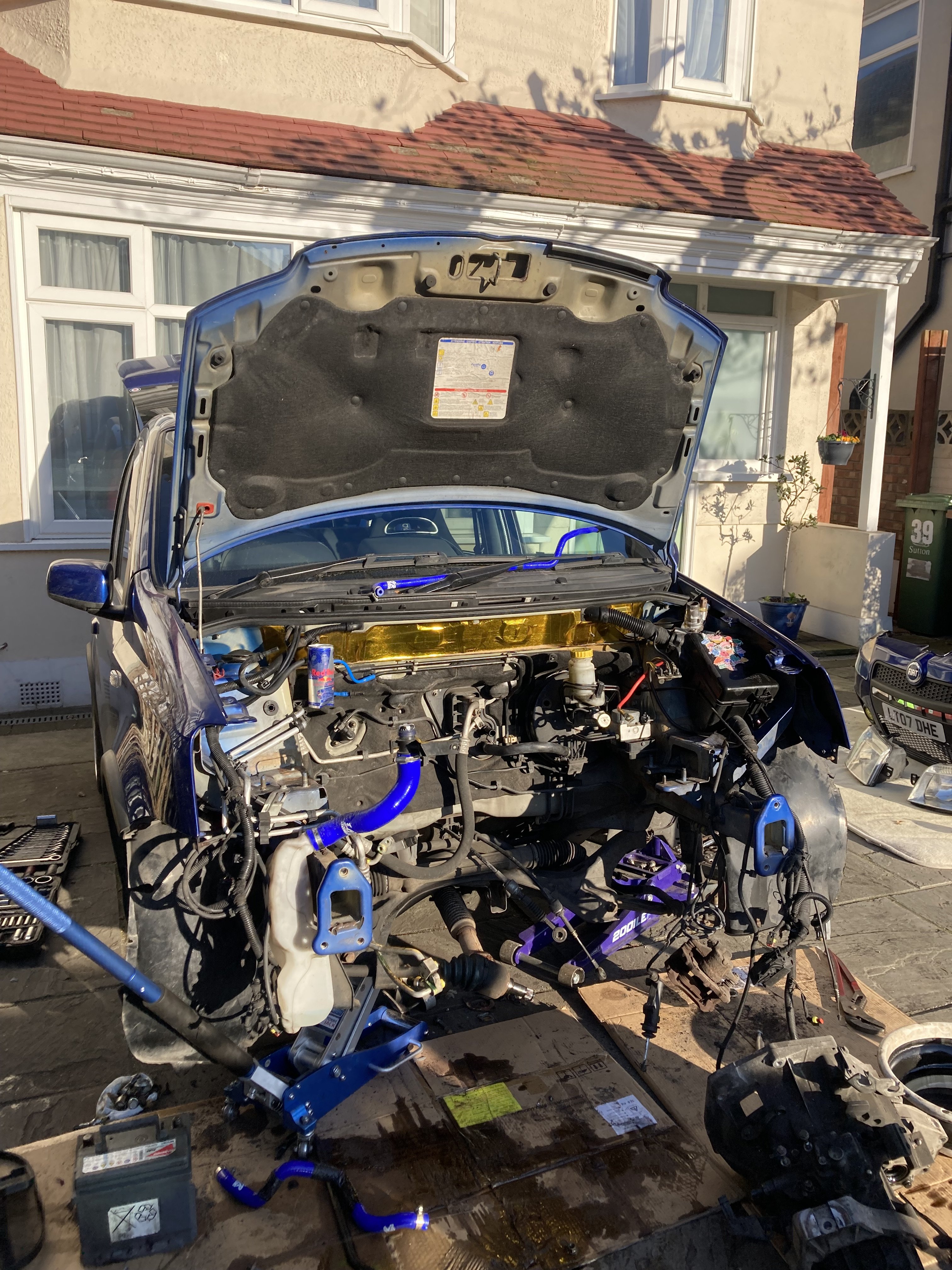

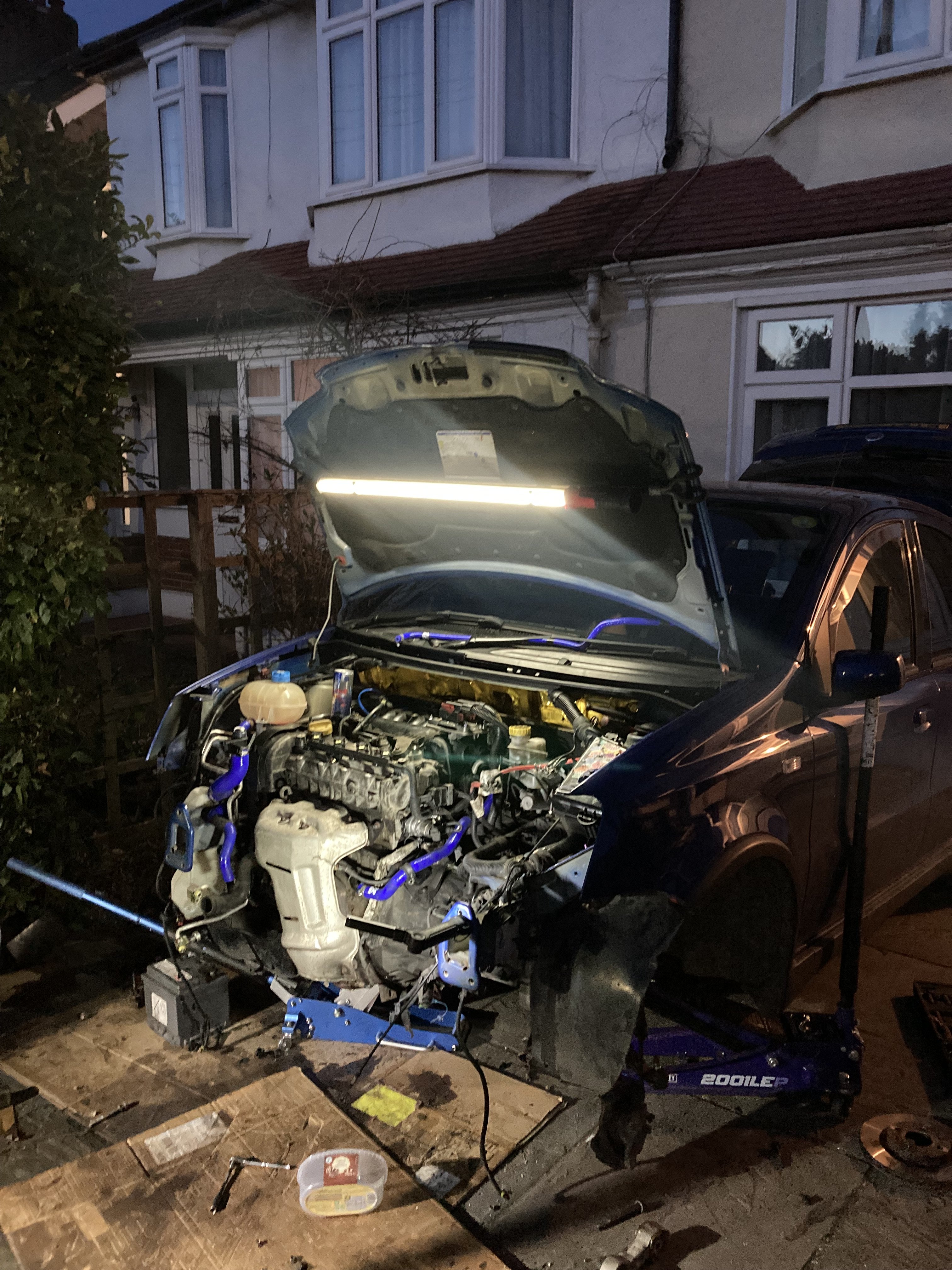

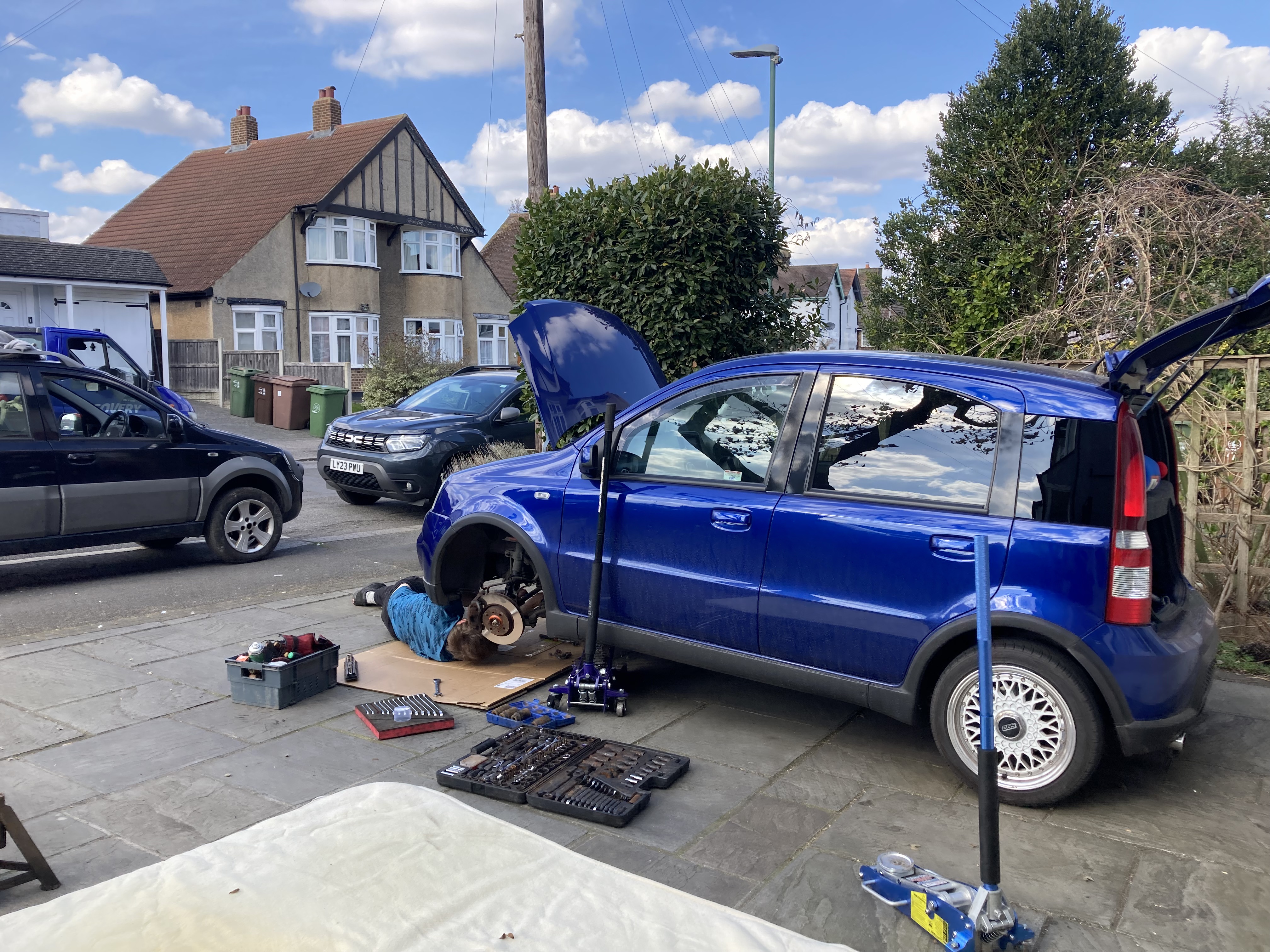

So the new engine is in! I would like to say it went really smoothly but with all things Fiat it did put up a little fight here a there.
The main issue we ran into was at some point the hub nuts had been done up so tight to the hubs the drive shafts could not be freed, lucky for me Ryan Lynch had a spare set but they were at his house 5 hours away!
Day 2 lead to the new drive shafts being fitted and I’m happy to report I have a panda back to full health.
While the engine was out I took the opportunity to do the following bits:

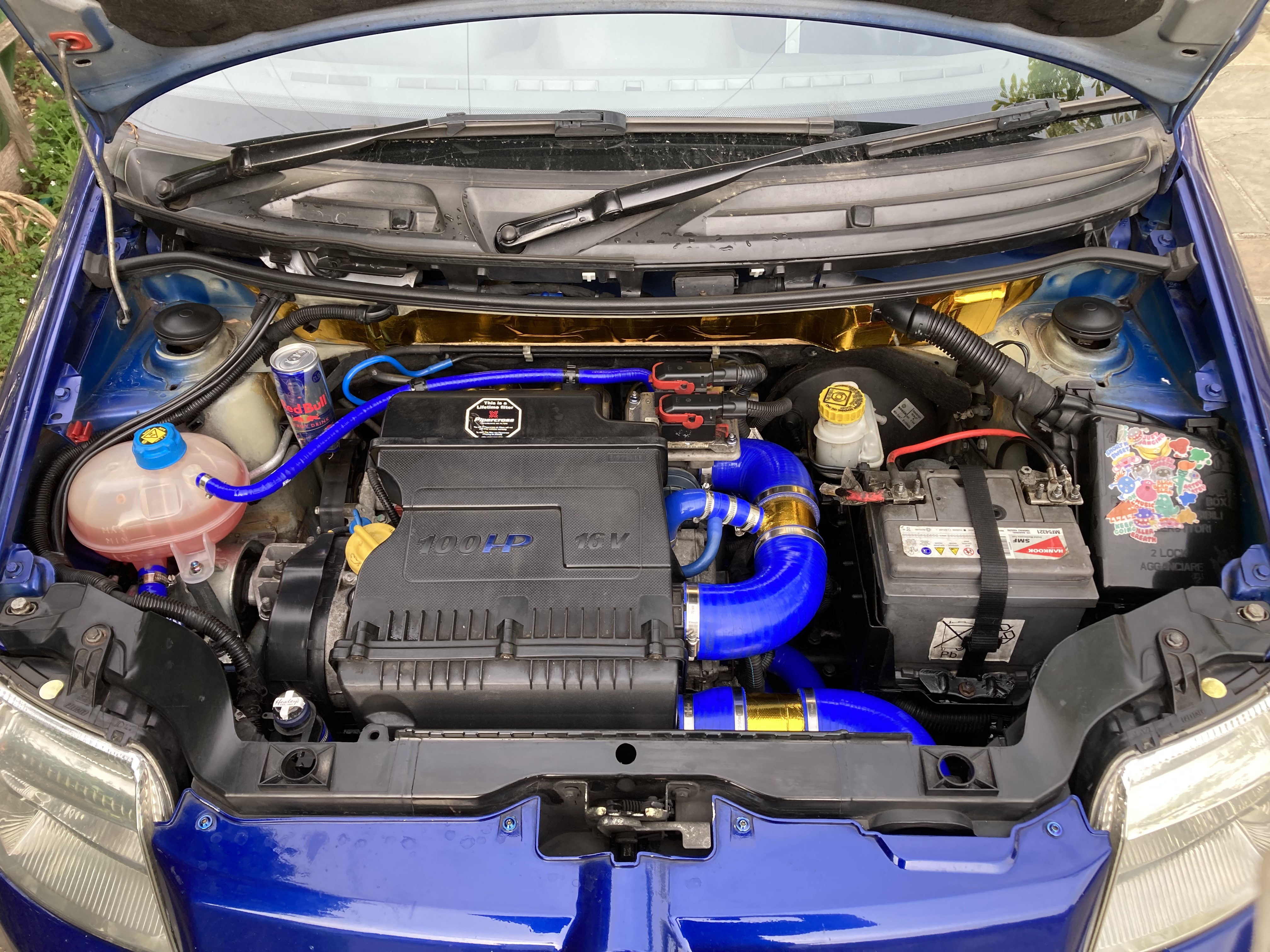

New clutch fitted

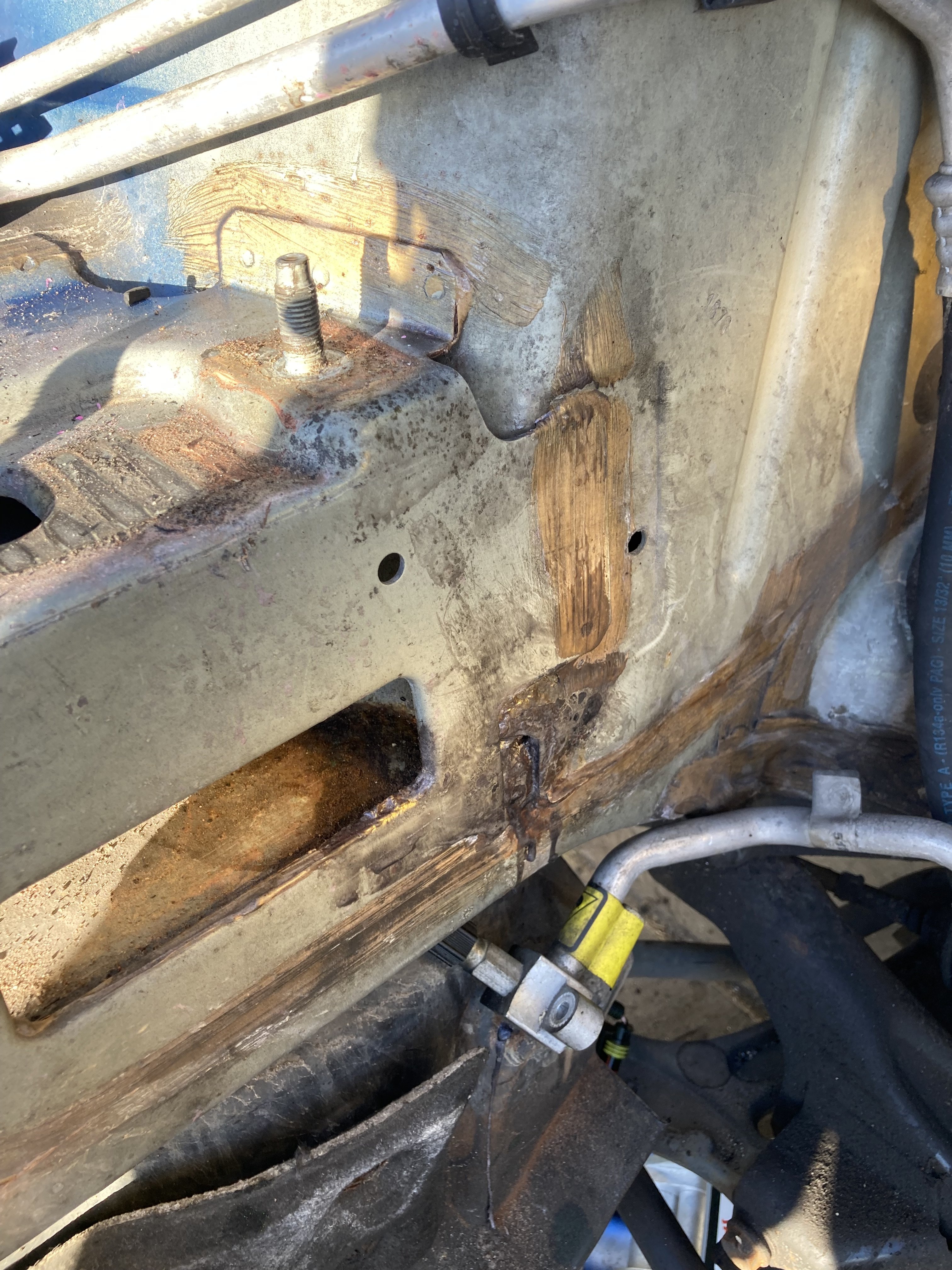

Rust treated engine bay
Reconditioned the wiring that was left in the engine bay

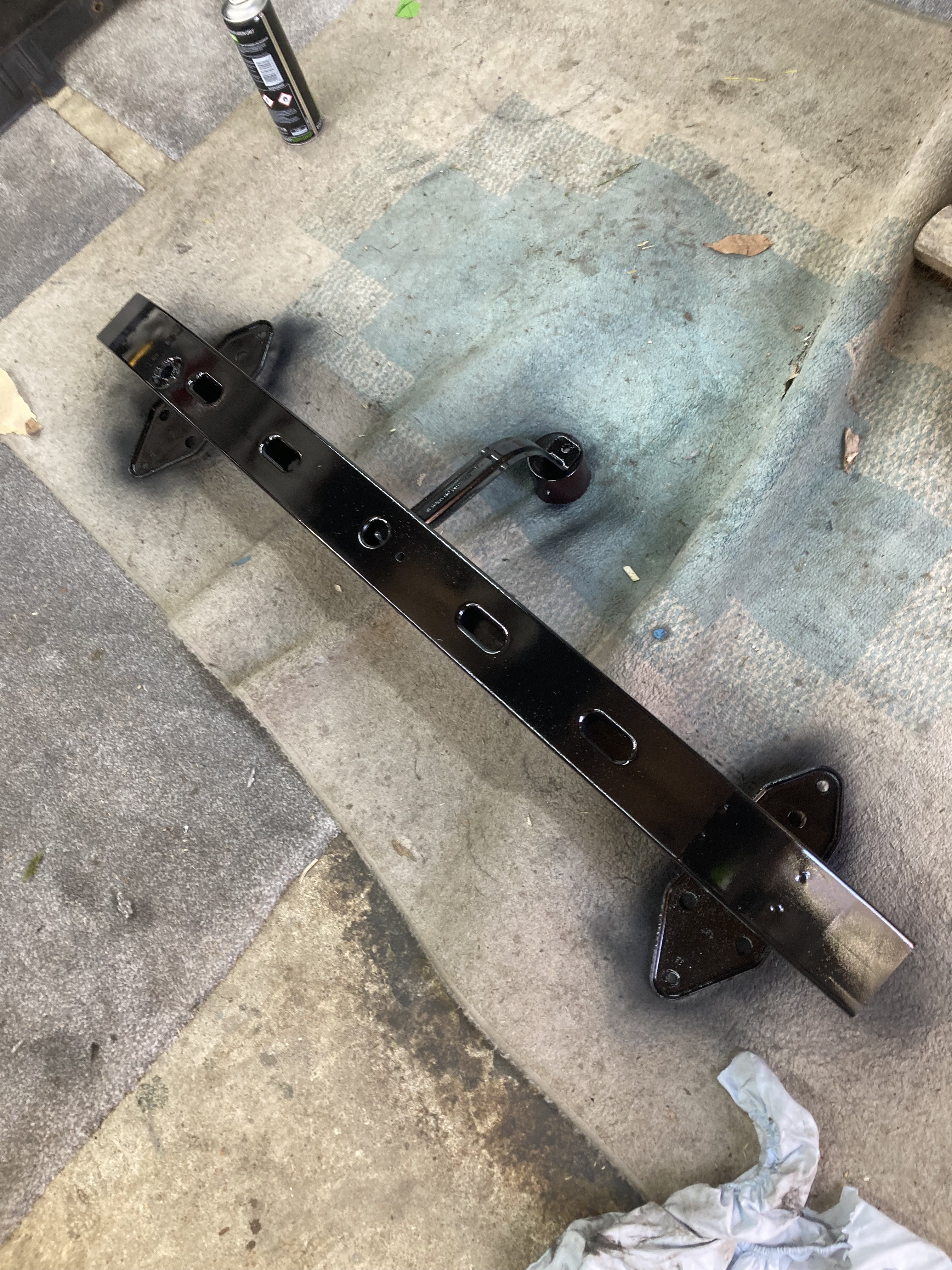

Painted the front crash bar
Fitted the correct bumper clips and mounting clips.

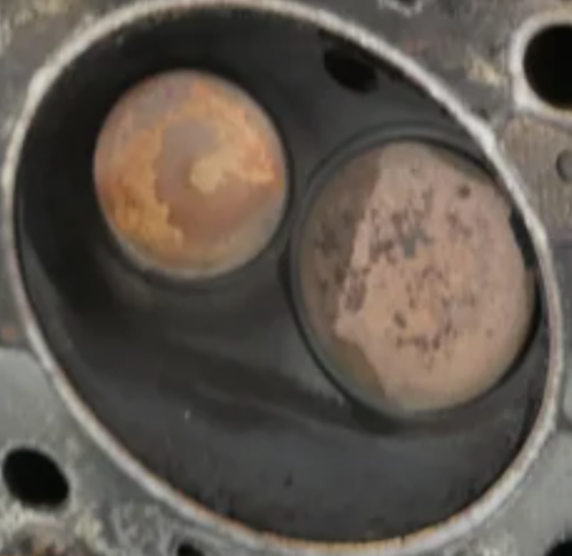

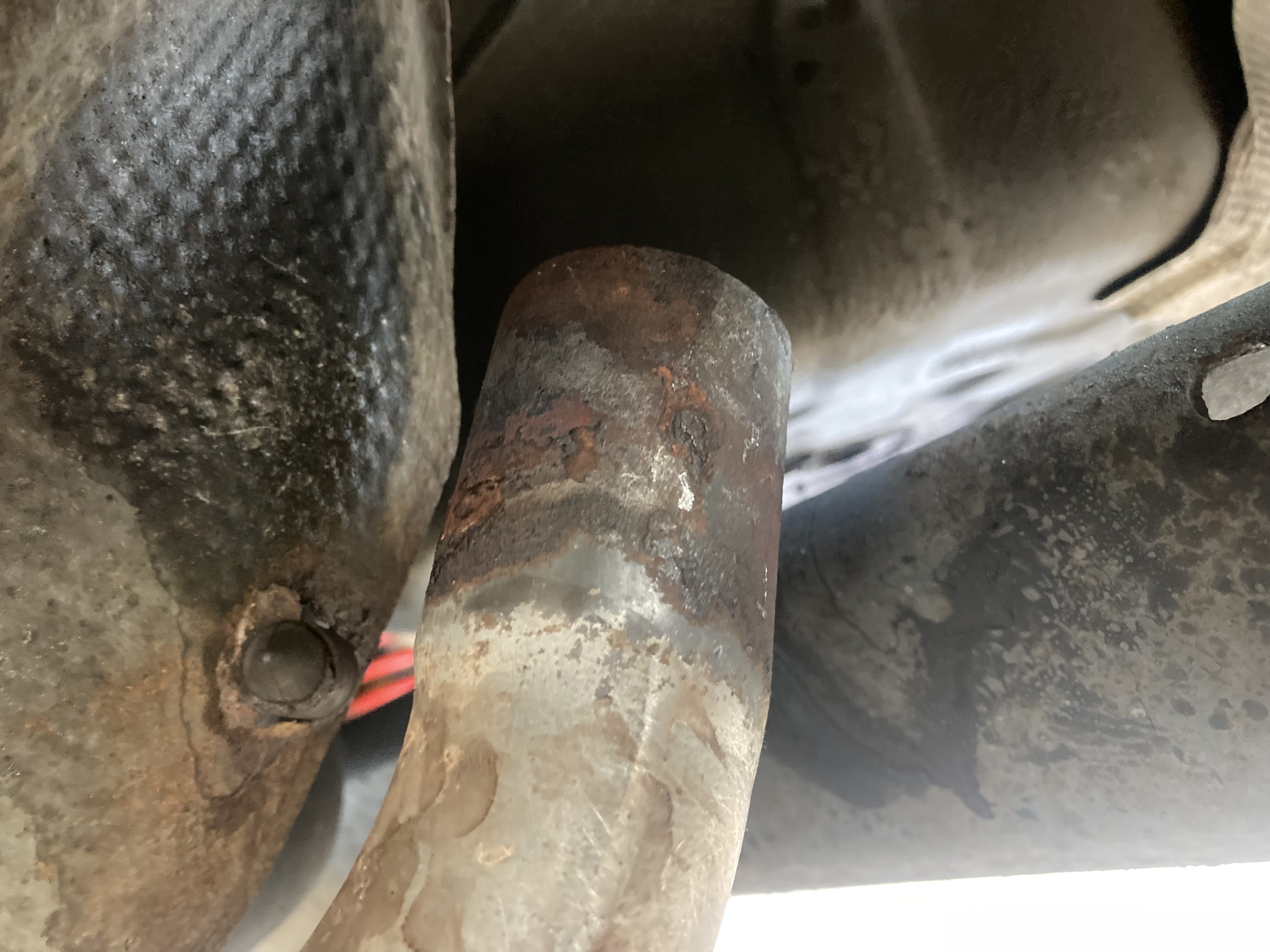

I haven’t had a chance to take the old engine apart but looking at the exhaust port for cylinder one you can see it was burning antifreeze and there is pink marking at the top of the chamber also the valve looks horrible, also the cat and down pipe were very wet!
I have a few little tidying jobs to complete but overall I’m super happy with my 63k mile engine! It’s like having a new car 🤣

The drive shaft hub nuts on my Multijet were "impossible" to move, then I realised the socket was not seating fully onto the nut. I ground down the socket (Impact type was all I could get) until it fitted to the nut base flange. It came off easily with a 600mm breaker bar. The issue was poor fitting of the socket, not the fastener being excessively tight.
Hi we could get the hub nuts off it was trying to get the drive shafts out of the hubs which was the issue 👍

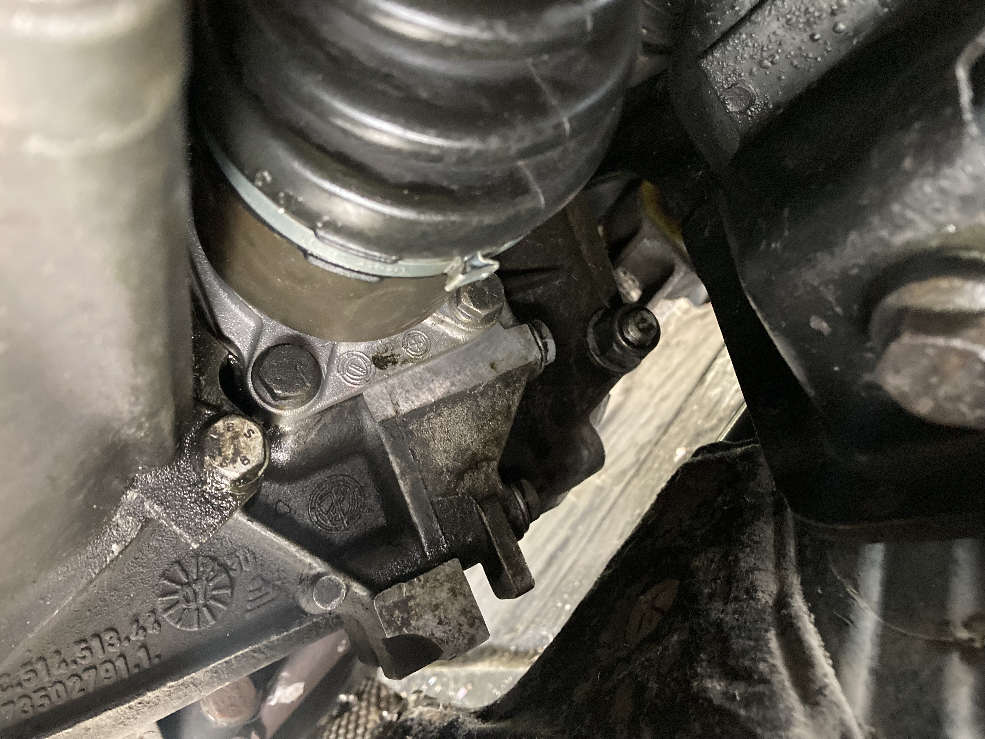

One little issue I had was the drive shaft oil seal was leaking a tiny amount, a quick trip to DTR and a new seal and o ring was fitted.

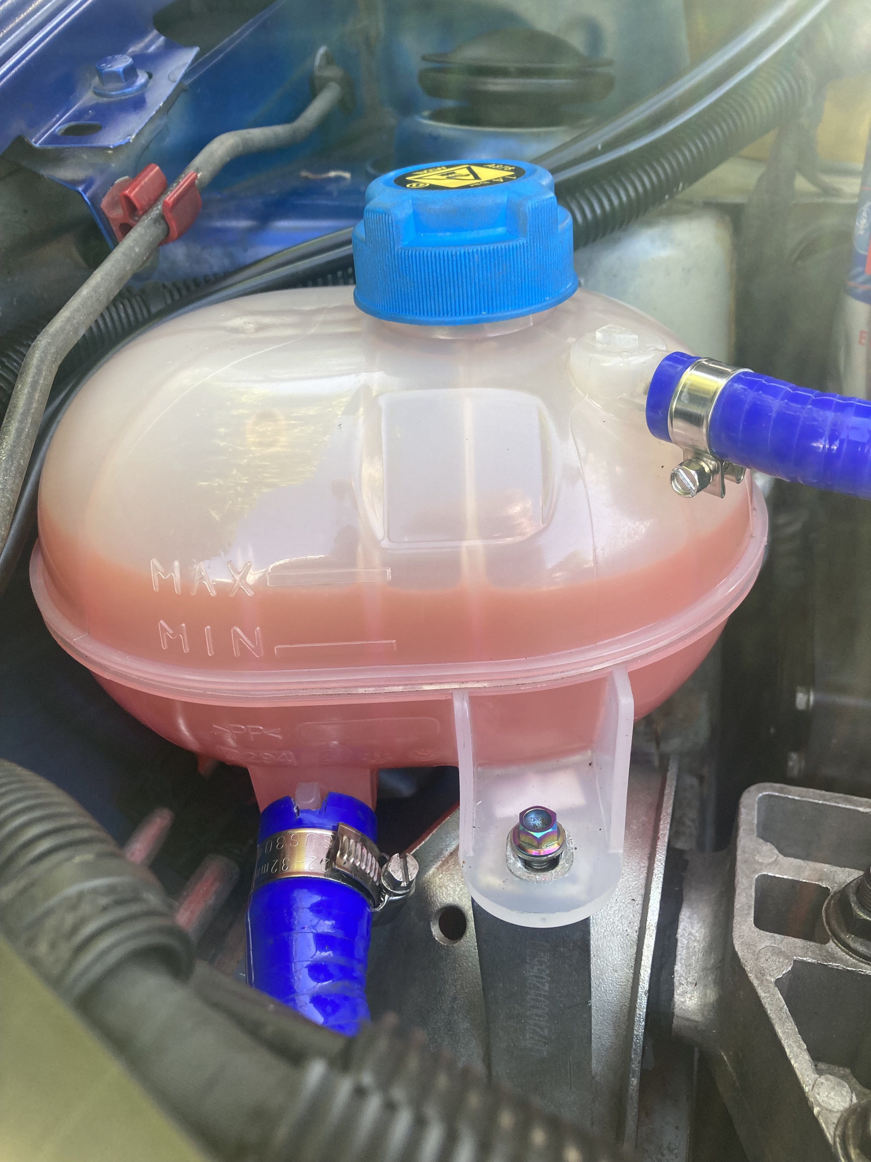

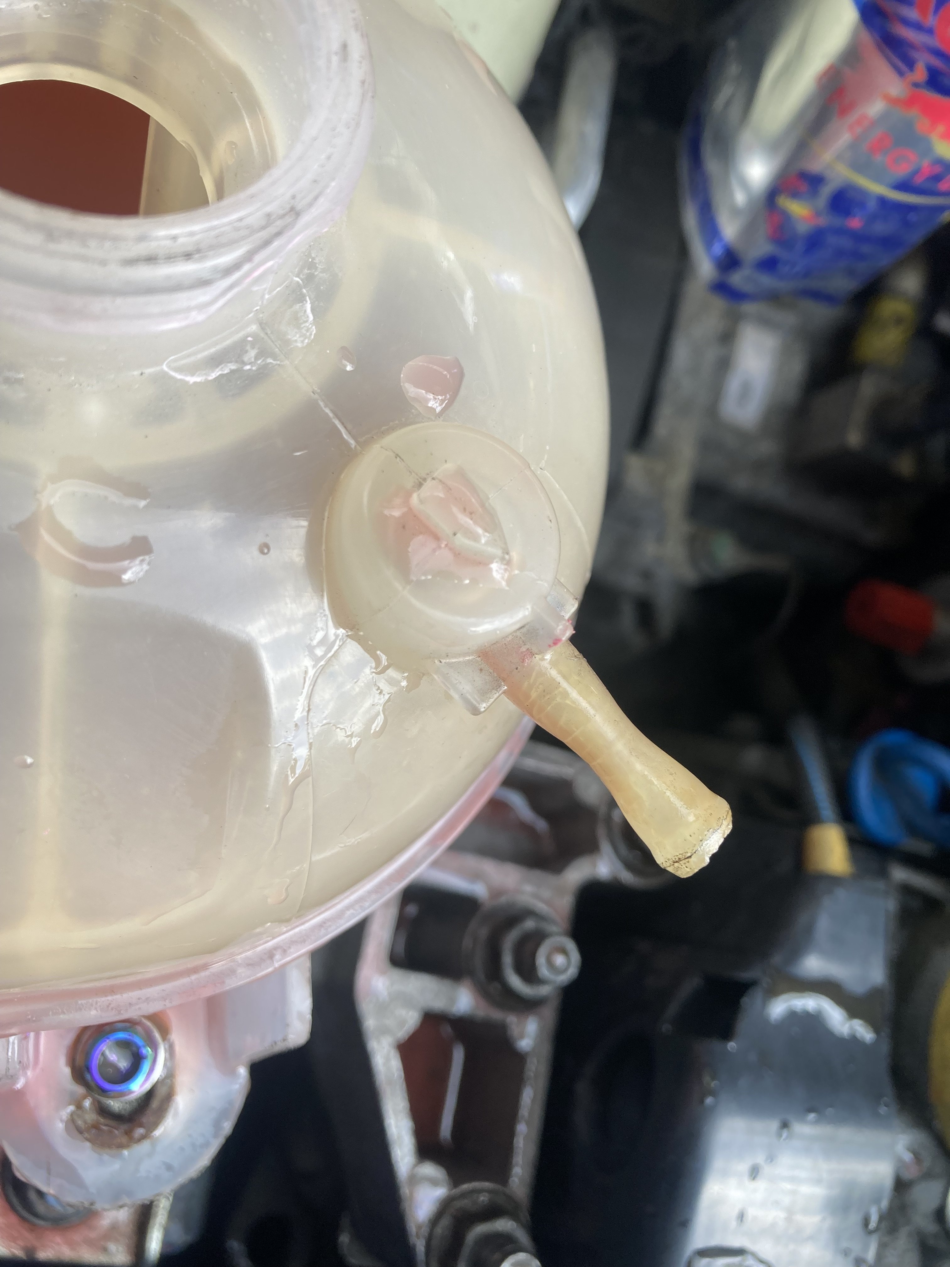

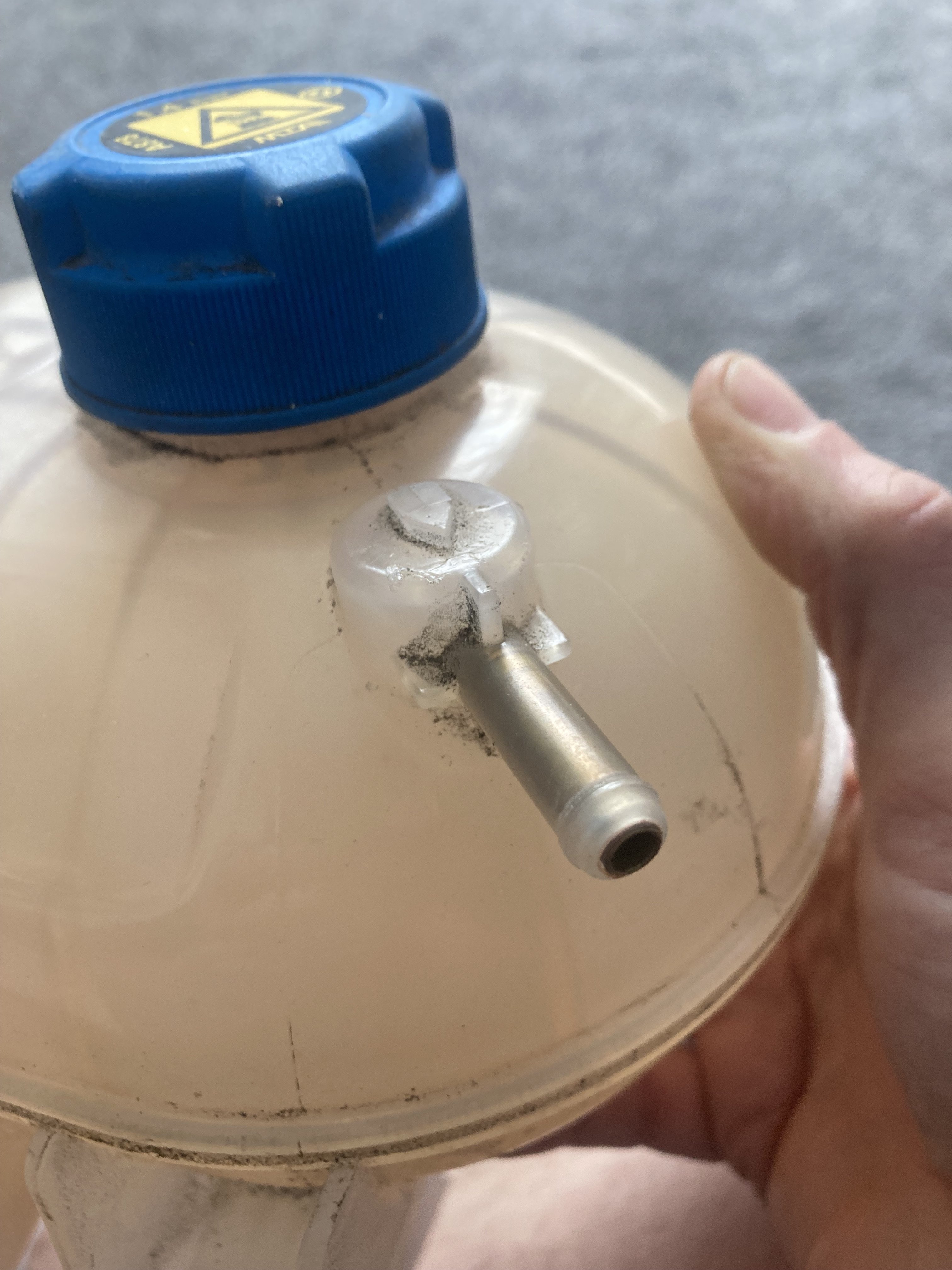

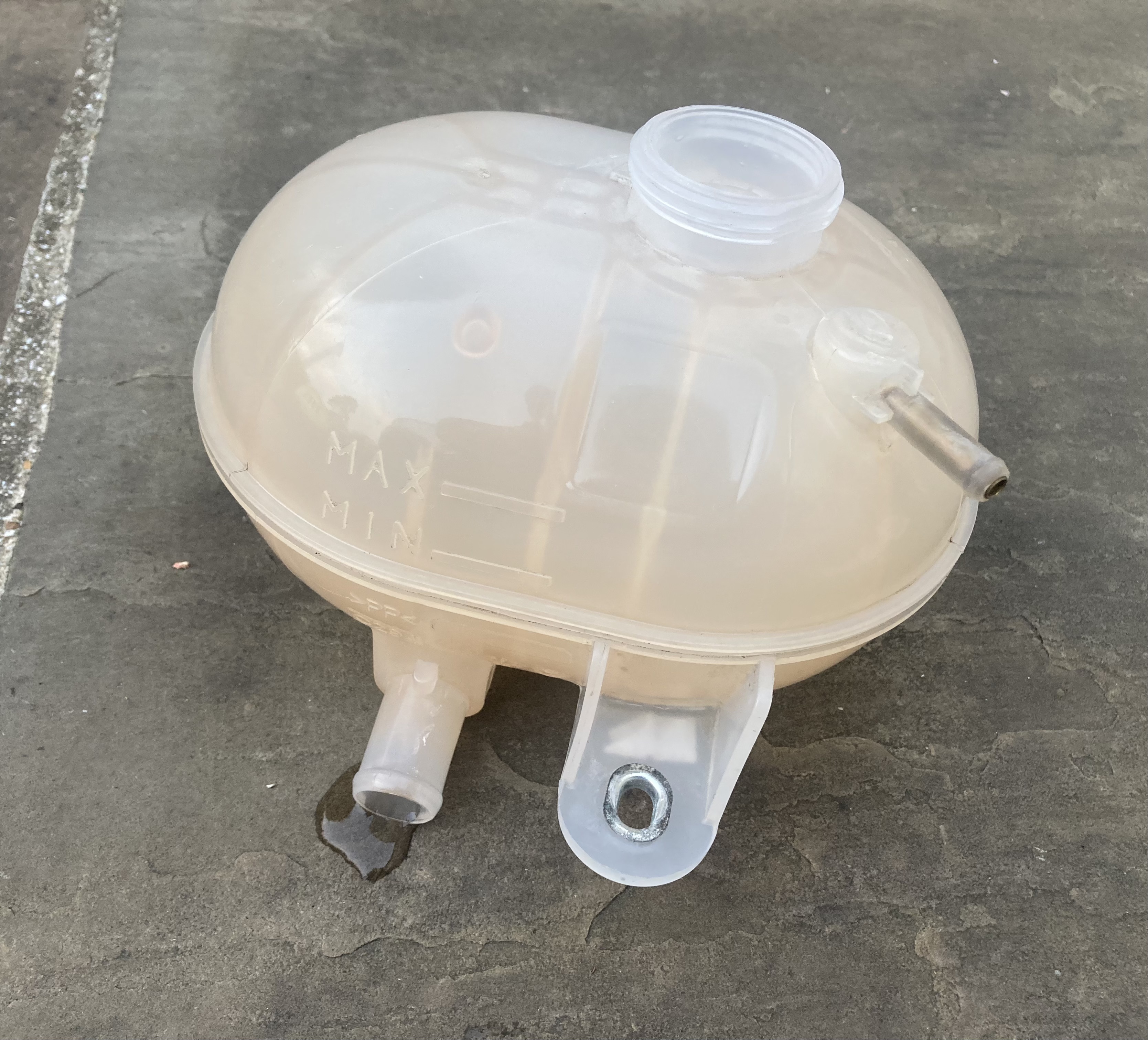

Everyday is a school day! To my surprise I had started to lose a bit of water again, on investigation water was leaking from the top connector on the coolant bottle.
It seems the connector had clasped on itself and it wasn’t proving to be water tight under pressure.
I managed to find a second hand 500 abarth bottle with the all important copper insert which gives the pipe more internal strength.
I’m pleased to report all is good now!

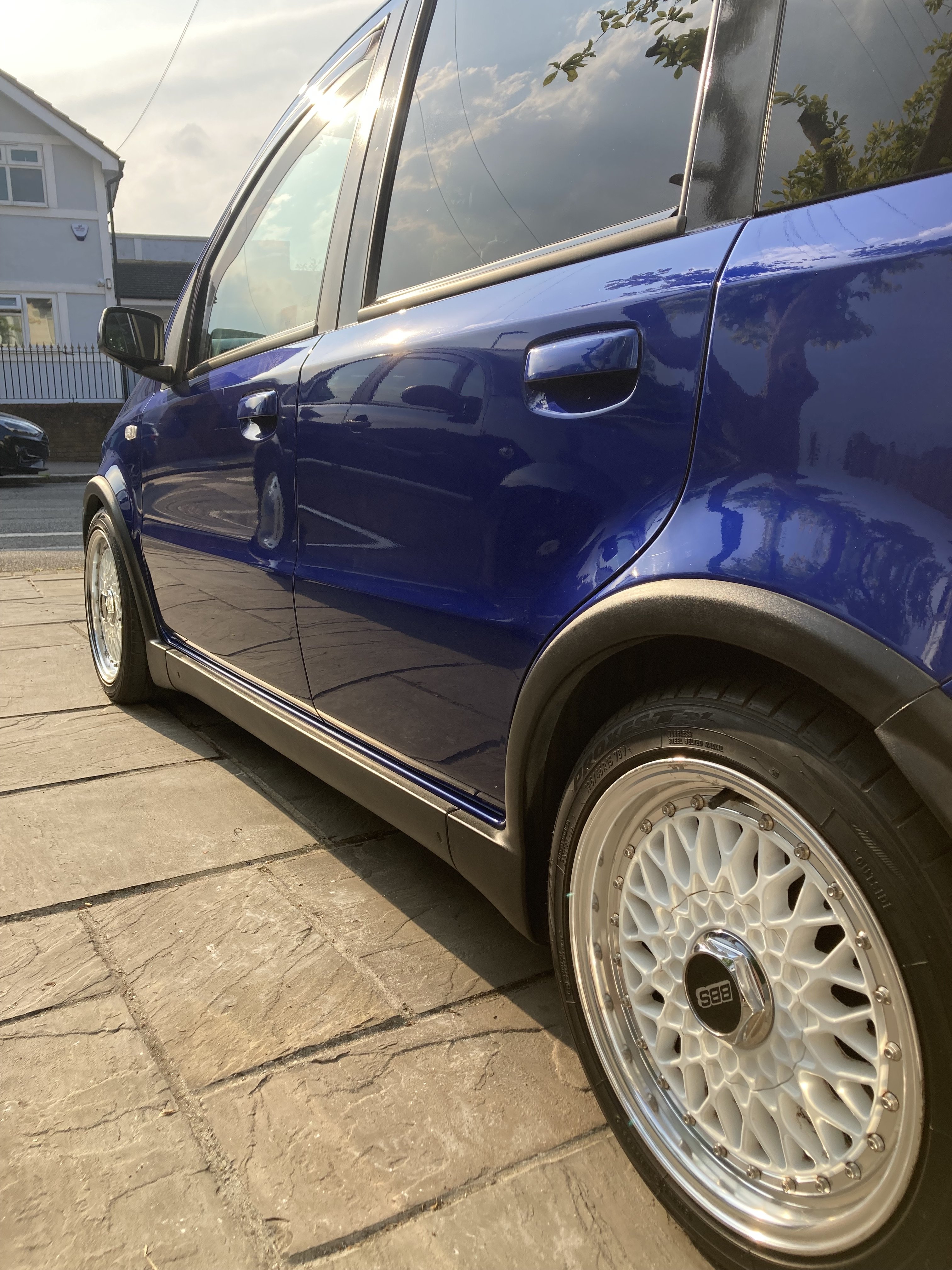

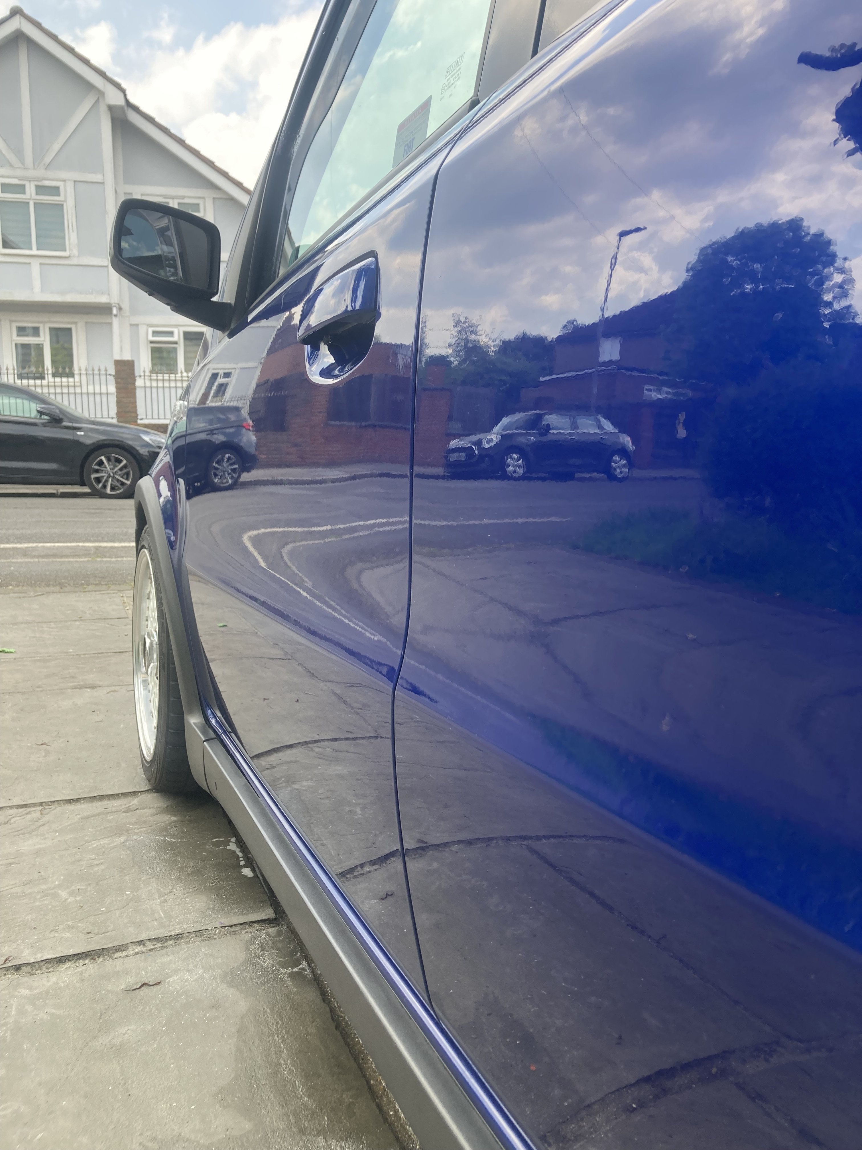

Sorry it’s late but last Friday I did my traditional pre autoitalia deep clean on the pandavan!
This gave me the opportunity to use my auto fitness polisher and wow the results are amazing, unfortunately I ran out of time and probably got mild sun stroke due to the light polish on the car took 5 hours start to finish.
You could see if you had the time and the space if you spent 2 days doing it the paint work would come up probably better then new!
