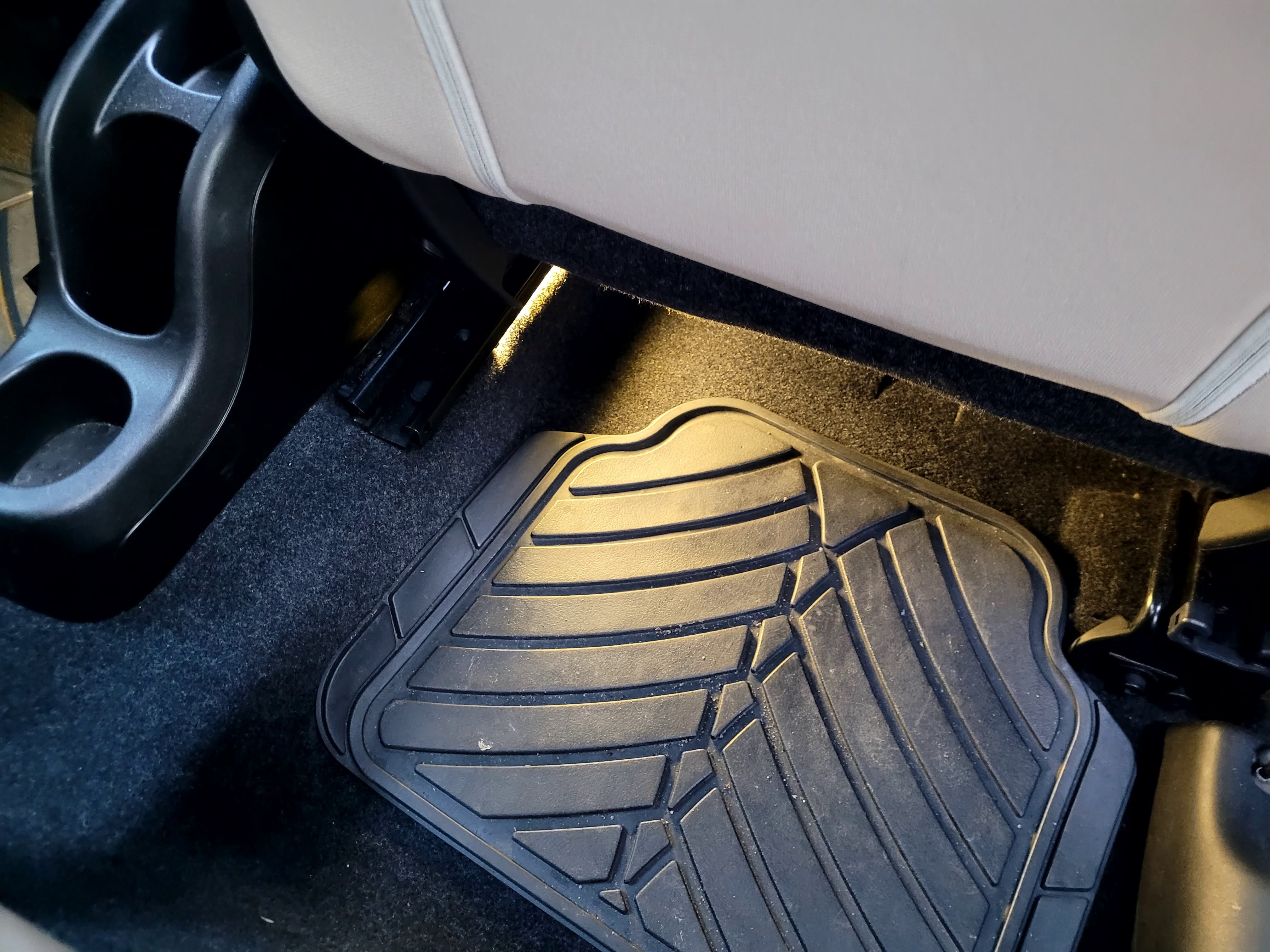

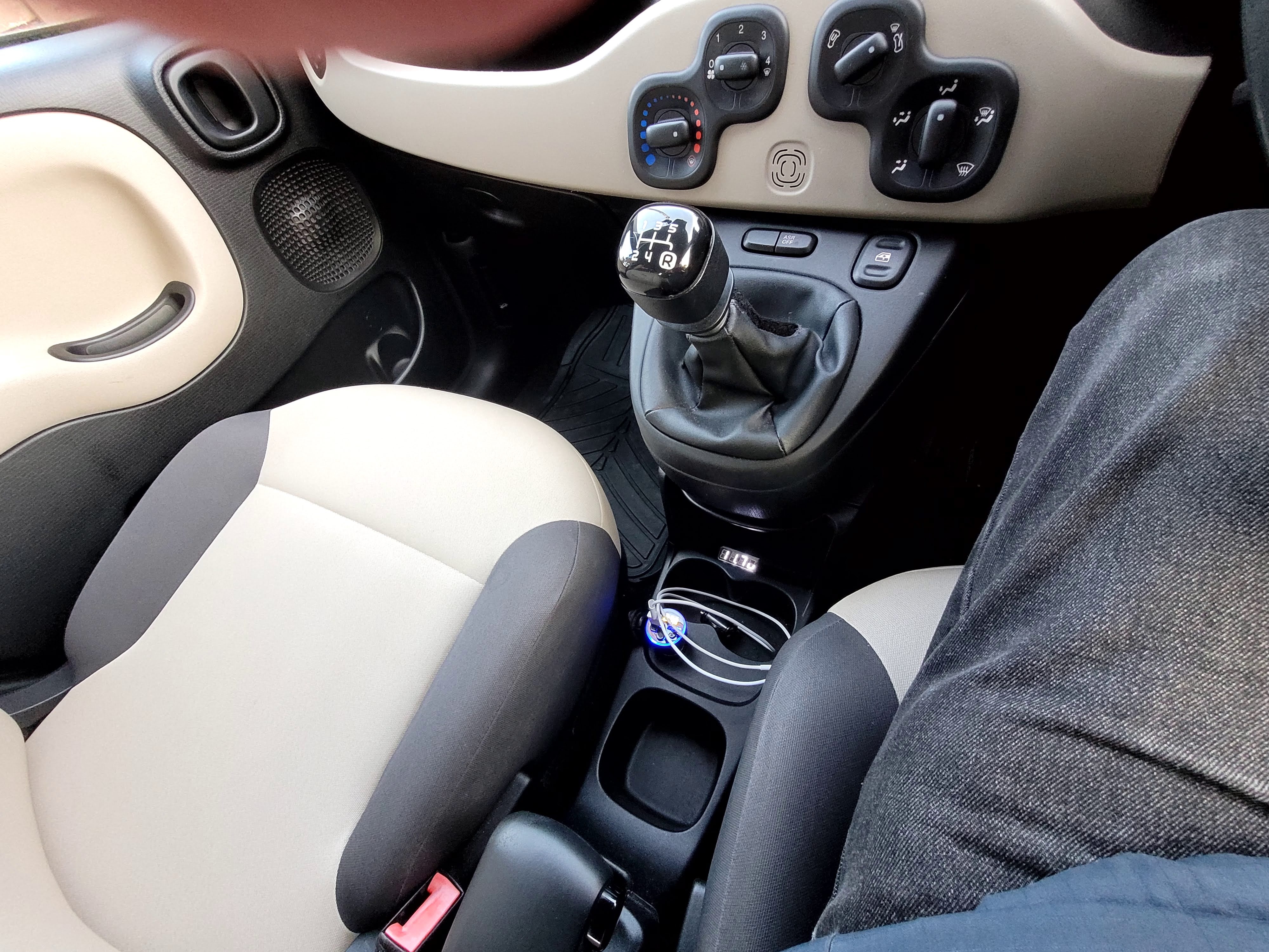

So far added floor lights and additional lighting on rear pillars, ideal for Winter. additonal lighting in boot.
LED indicator bulbs and number plate lamps.
Fiat Clutch switch on/off to select on the go added.

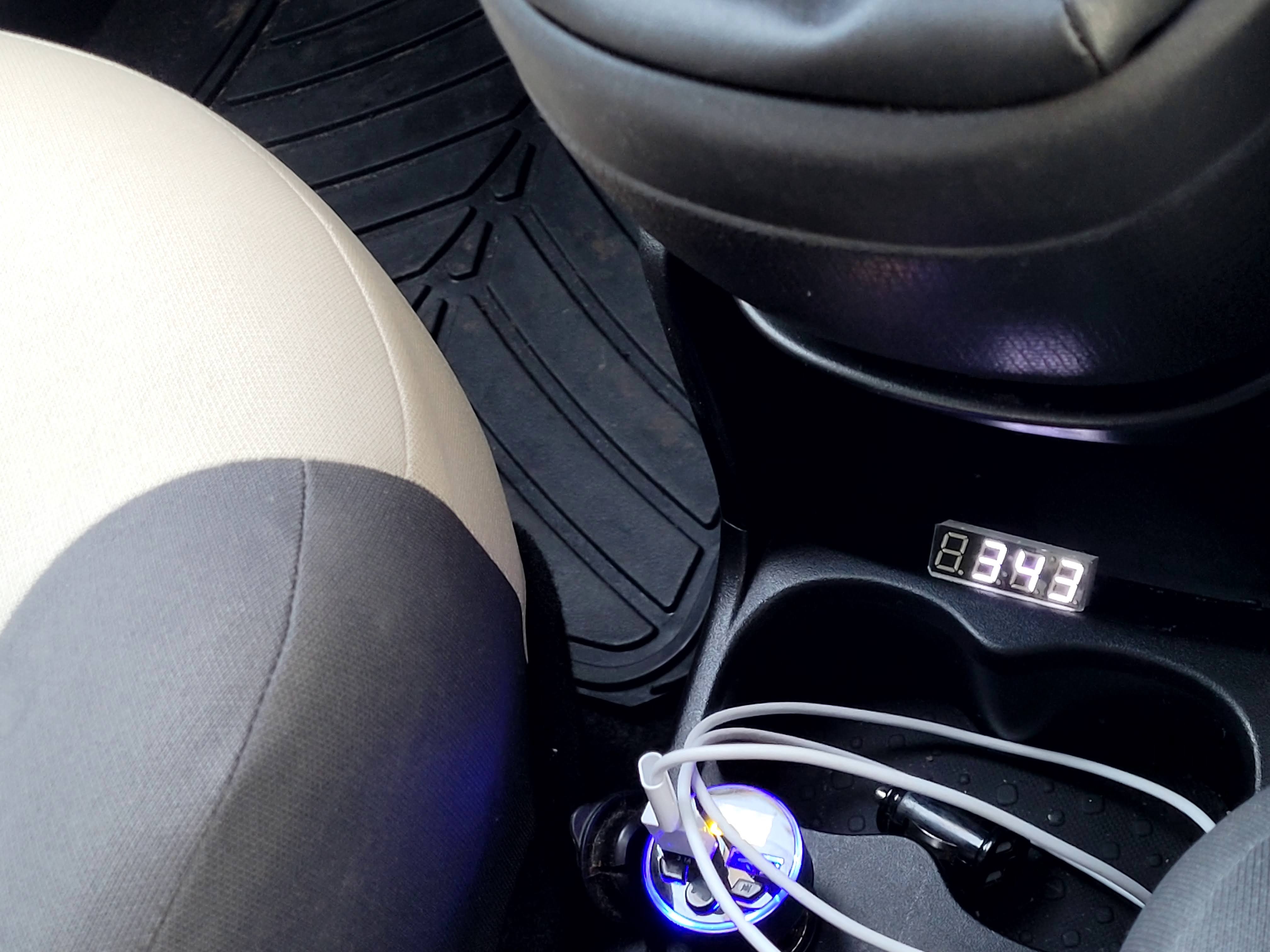

Time / Ext temp / Batt voltage display in console
Will add auto Lights/headlamps and lights on when R/C unlock in the next few months as the weather improves.
A few snaps

With winter just around the corner here, can you share some details of how you wired up the foot well lights please? The designers seem to have trimmed a few corners, proper interior lighting being one of them!
Great 👍.
We like our Panda as well.
I found the panda very dark at the back, so added 2 shoulder lights and lighting for the footwells. All are led so draw less than the original filament lamp.
I created a loom for the floor light fed from the front centre light and routed down the left screen pillar and along the centre console.
The loom for the roof has to avoid the airbags so goes across the middle. All wires wrapped in anti-rattle flame retardent tapes as the manufactures use.
It makes a big difference to the light level in the back seat area.
