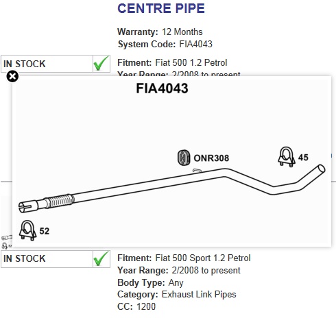

Had a quick look on shop4parts and didn't see any exhausts listed but came across this supplier. No idea what they're like but they're cheaper than OEM.
http://www.onlineautomotive.co.uk/Fiat_500_Exhaust%20Back%20Box.aspx
Click on exhaust link pipes
If you are unsure about keeping your 500 what does fastfit charge for the part or can they supply one ?
Also in relation to modified parts & insurance premiums it was mentioned on the FF that if you get a letter from the 'Exhaust supplier' that there's no performance increase it shouldn't increase your premium. Replacing mild steel with a longer lasting stainless steel is hardly a modification.

Same happend on my bravo, got the whole center section replaced inc flexi joint and an engine mount for £130, i did call fiat and they quoted £185 for the part, im sure its not dealer only, the panda uses the same exhaust right?
