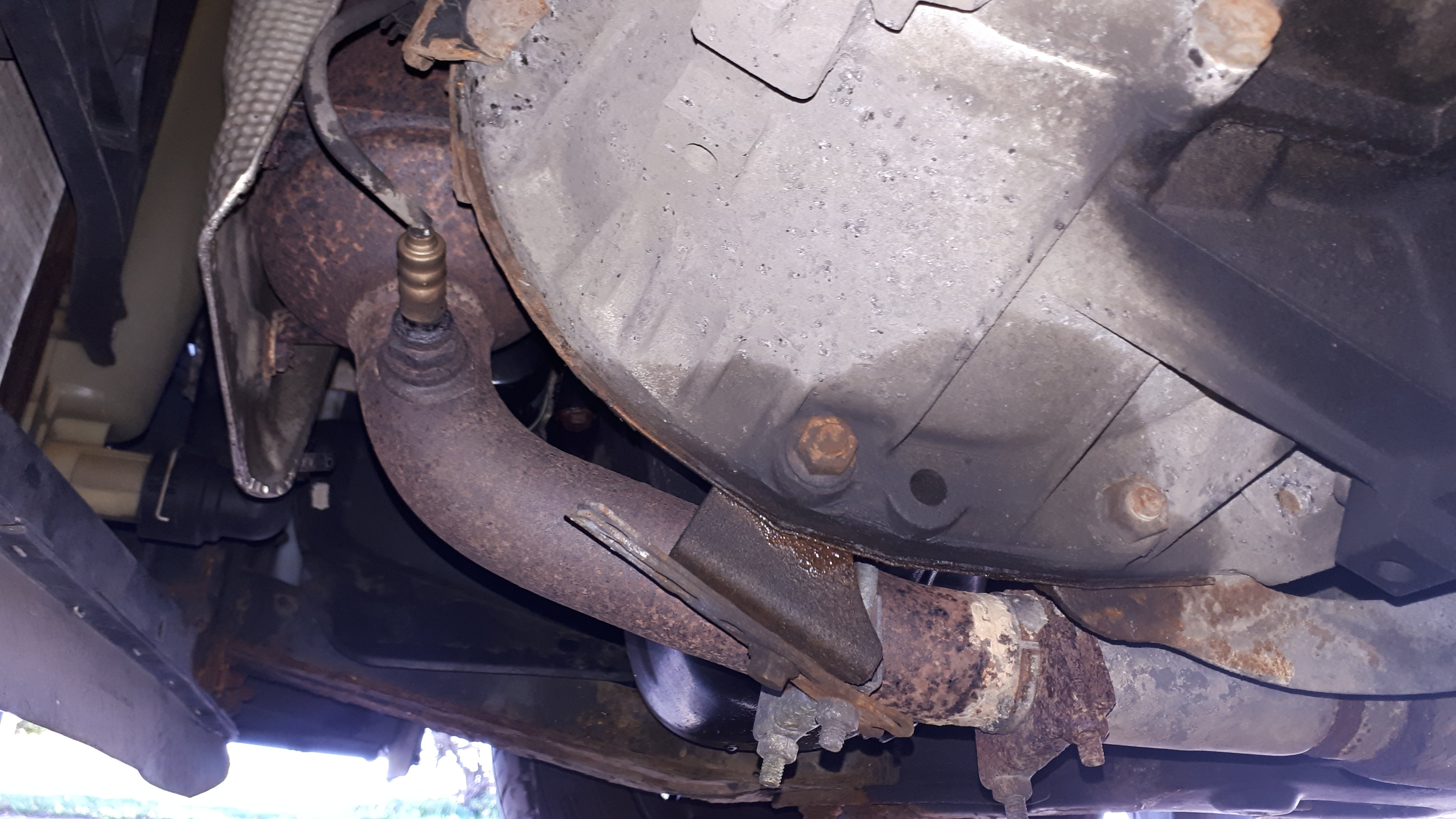

Is the front pipe to gearbox clamp still there? If not it could be the lower manifold bolts
That one's not the original!
Here's an OEM bracket.
It's in two parts; one attaches to the maniverter, the other part attaches to the gearbox. It's the part attached to the maniverter that usually corrodes, OEM replacements are readily available and reasonably priced. The part that attaches to the gearbox is harder to find, although fortunately it is usually OK.
But any combination of brackets and clamps which firmly holds the pipe in position will do just fine. It's important to secure the pipe properly at this point, or the exhaust will overstress the attachment at the manifold and may break the studs and crack the maniverter, and they're not cheap!
When refitting, covering it with anything that's greasy and reasonably heat resistant may help delay the inevitable.
Thanks all. Had a look last night and although my clamp looks a bit different to yours (I note prev comments about it often needing to be replaced), it seems pretty solid. I gave the exhaust a good yank and it didn't budge. There are small leaks at the entry to the flexi-joint (a hideous bolt on affair for my sins) and around a weld around a sensor attachment hole just after the cat. I have a stick welder which tends to blow holes in things that are thin and was considering getting one of those cheap flux core welders from Lidl to seal things up, as they look a bit more delicate. I imagine welding with the sensor in place would be foolhardy and don't know how easy the sensor would be to remove and then re-attach after. These leaks are small though and I suspect that's not the source of the problem. Although perhaps things get significantly worse once everything heats up. I've yet to look past that sensor, at the cat and manifold. Cheers.
