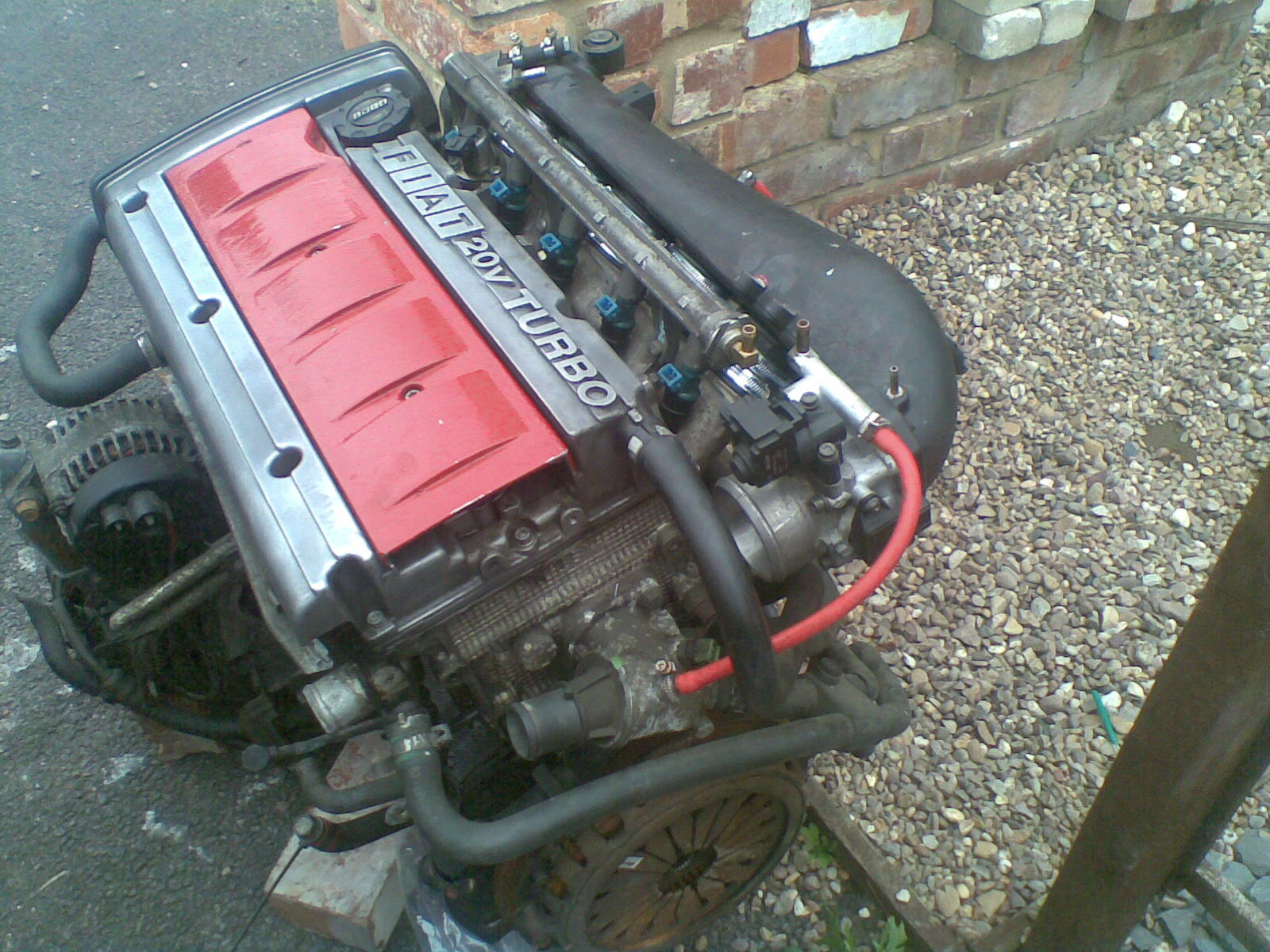

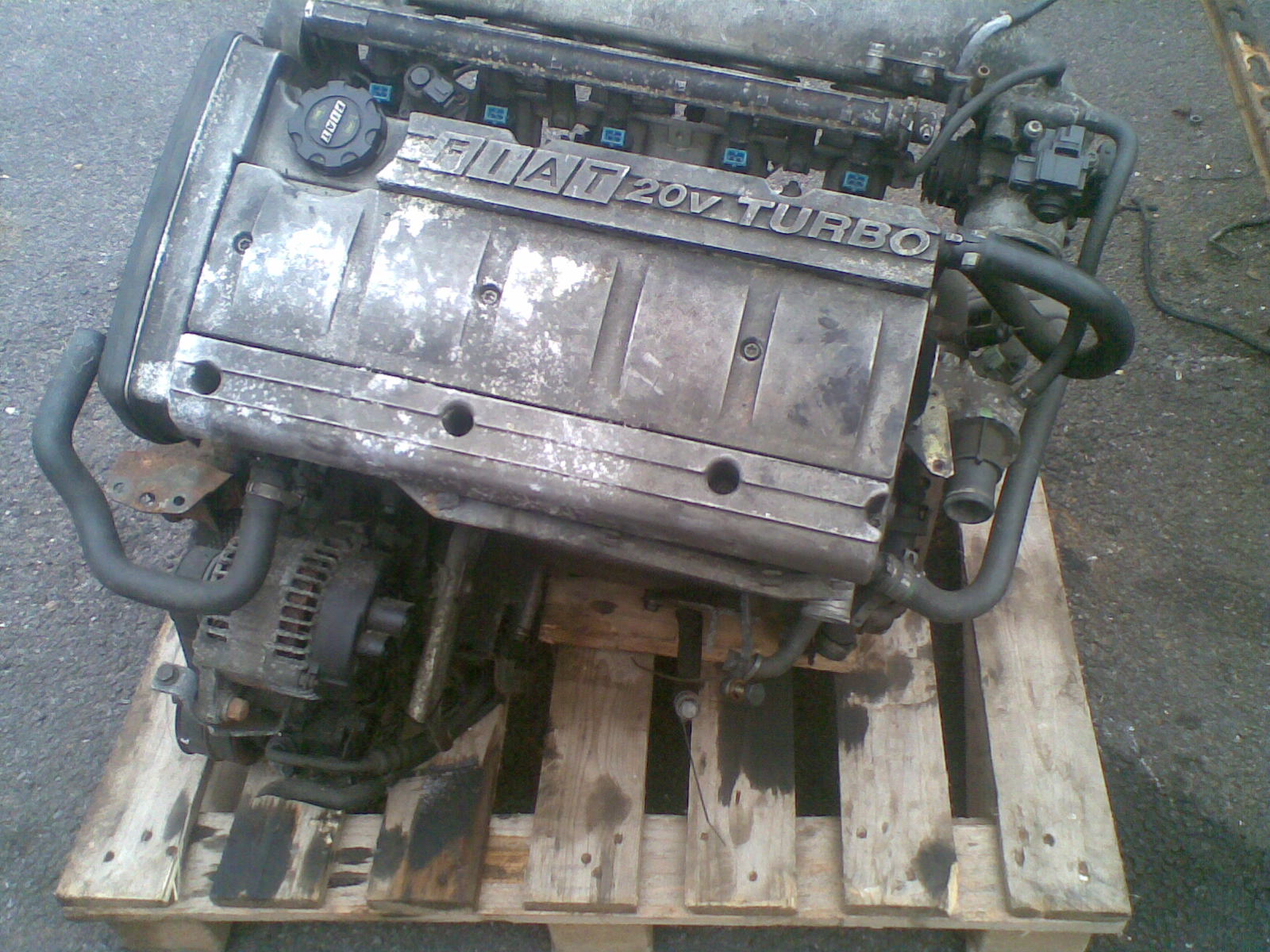

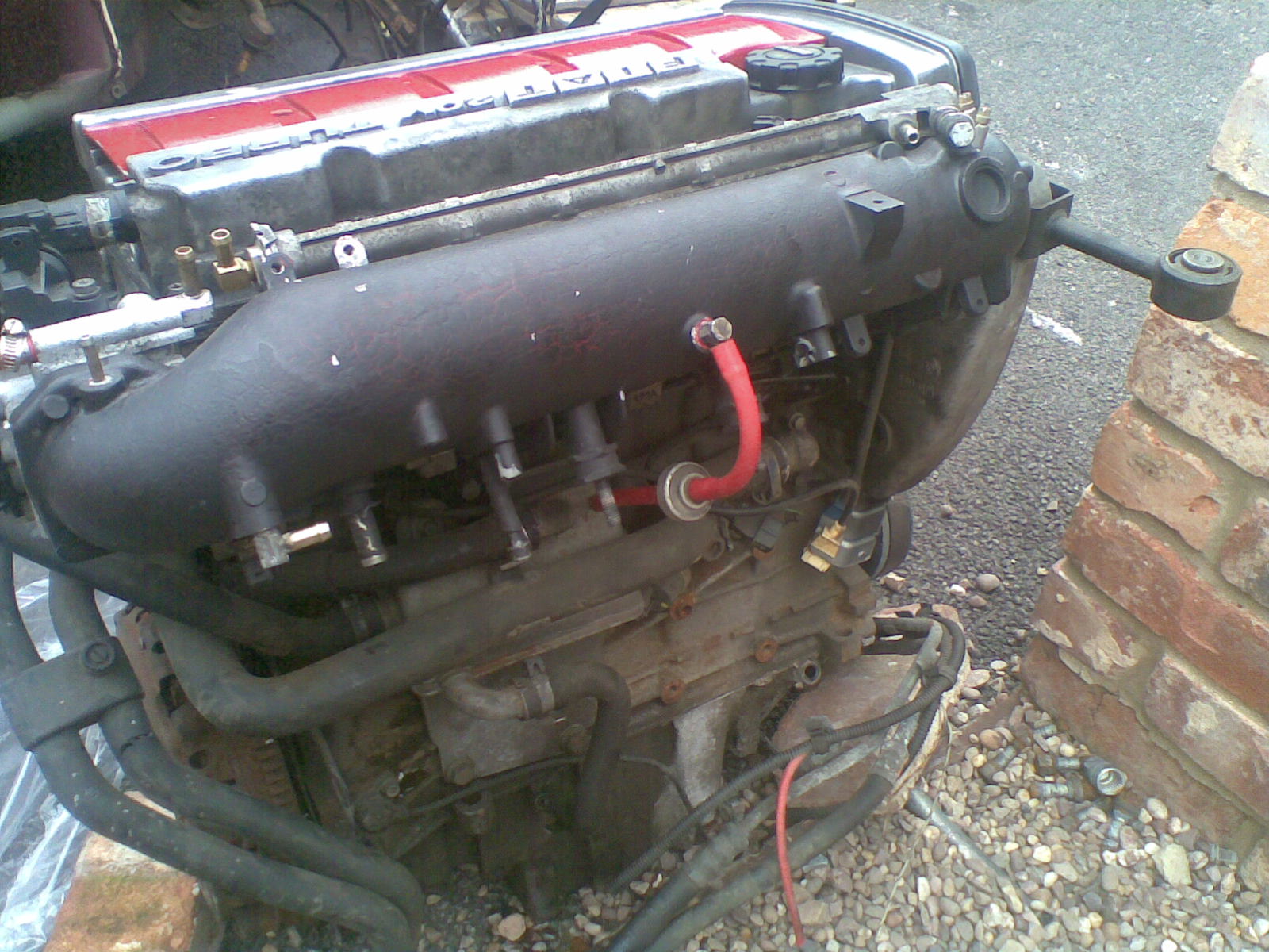

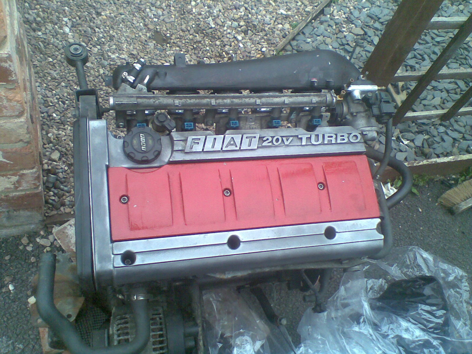

Well had a chance to make a start on the new engine today.
Firstly stripped the old inlet off. put mine on, noticed that the old inlet had also been matched to the head.

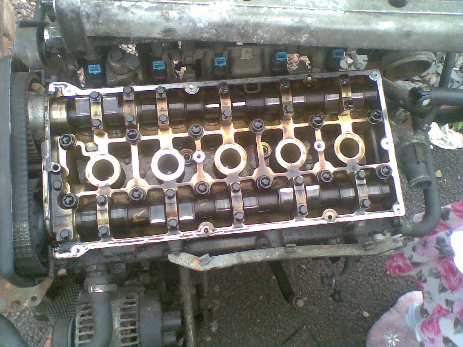

Had the rocker cover off to clean it and couldnt believe how clean the head was.
swapped two hoses for red silcone ones.
Replaced the original NGK R's for the iridiun ones.(y)
