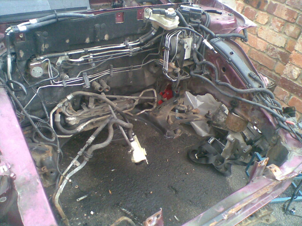

Here is the poor thing as it stands lol, half the car is in my room lol.(y)
