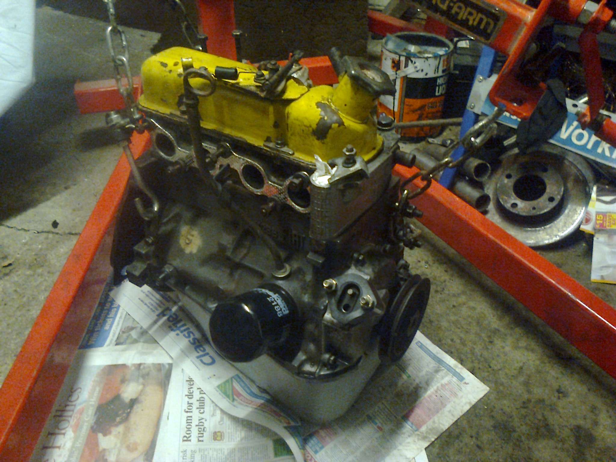

OK today I basically just put the engine back together having checked the valve clearances yesterday. I re-timed the engine and she is running fine again. I touched nothing else apart from removing and refitting the rocker cover to check valve clearances

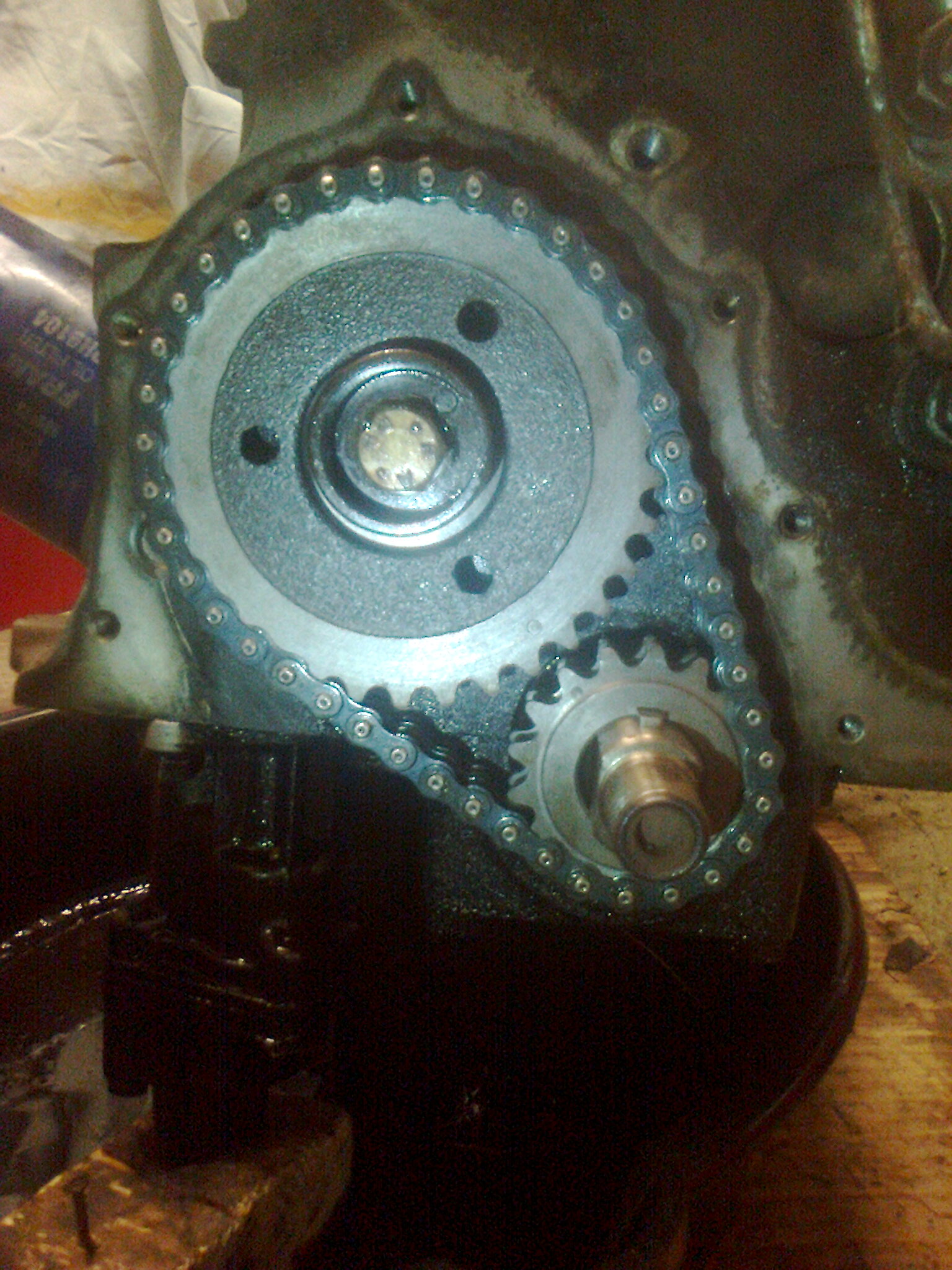

What do people think to timing chain stretching? I will re-check the timing next time the backfiring happens to see if the timing has changed...but I don't think the timing chain would be a big problem at 50k miles. Should be good for 100k I would have thought. But I also have a new one of these waiting just in case.
