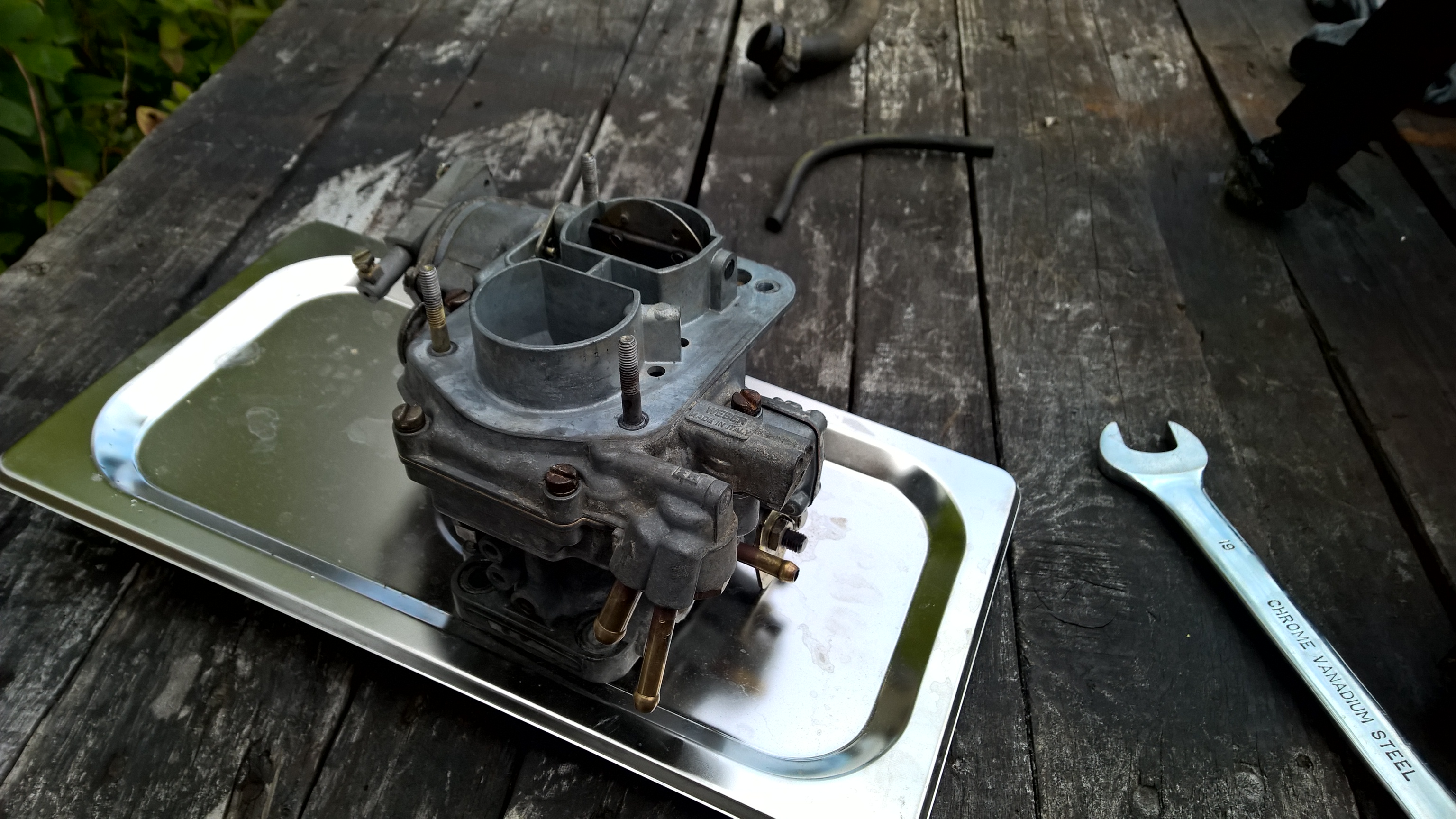

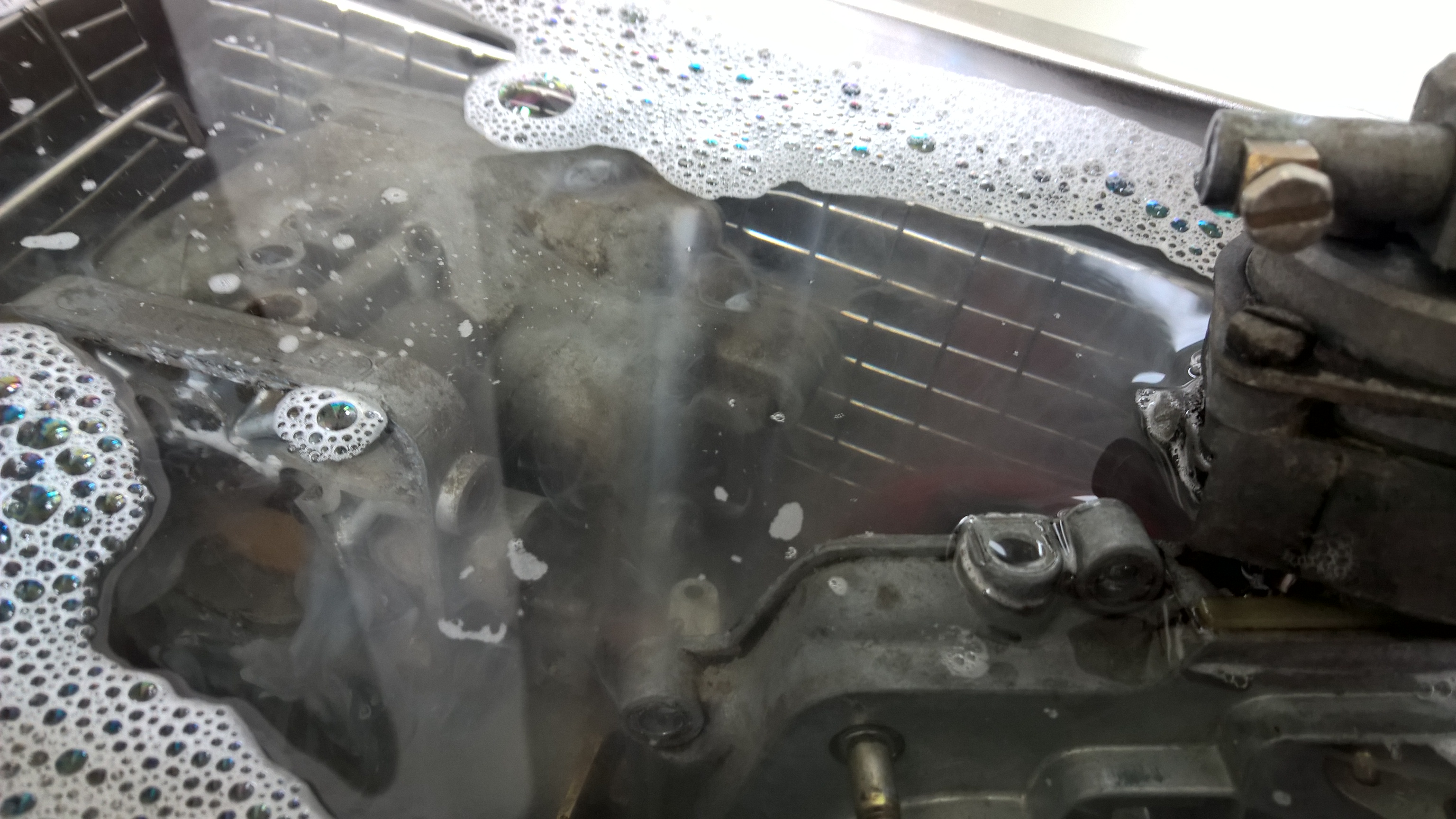

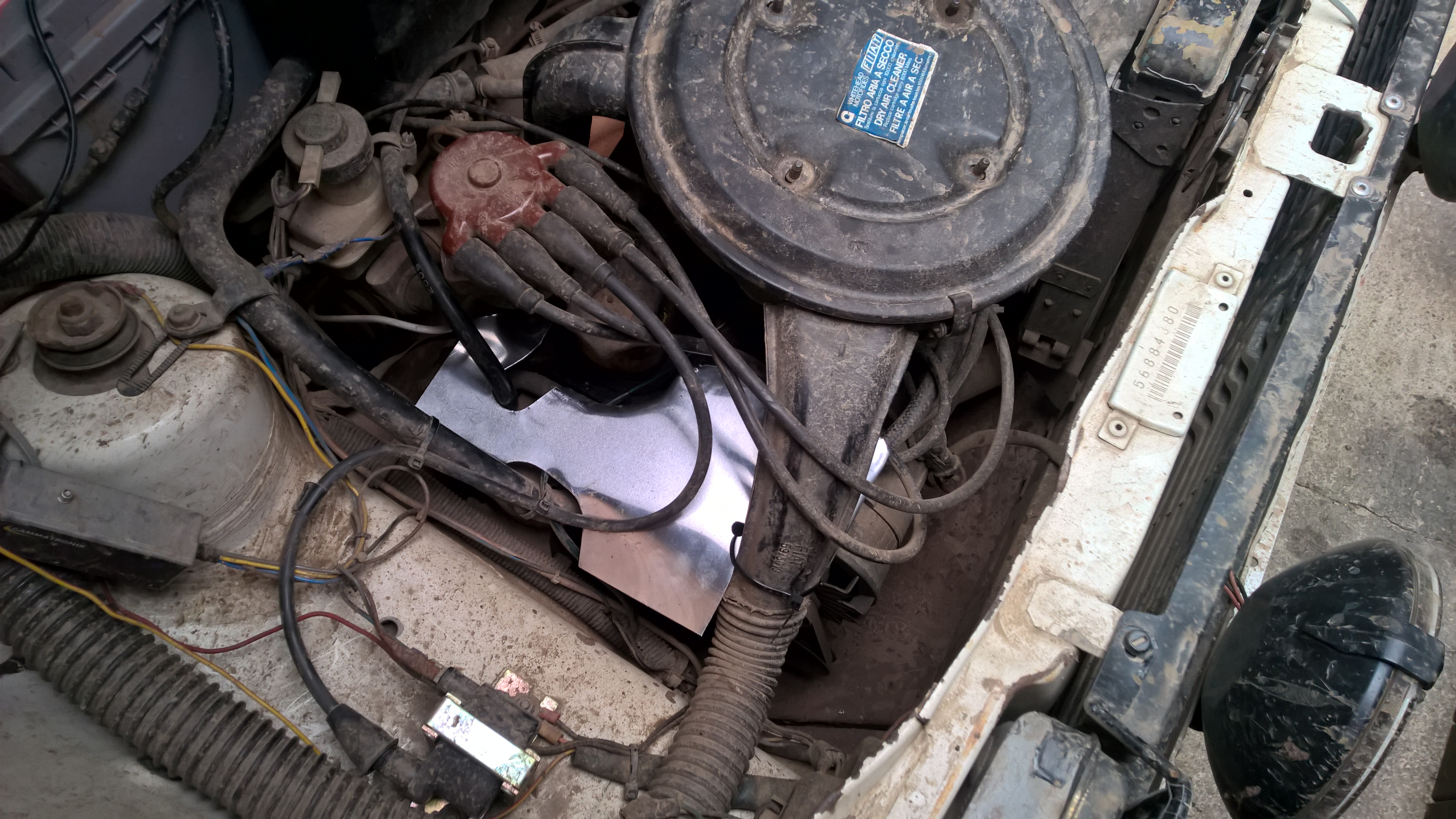

Also Qing Qing got a bit of attention in the form of a nice relaxing sonic bath to rest her carburettor in (not intending to be rude...)
You can see the swirls of crud coming off which is mildly satisfying:
Like new again :D...

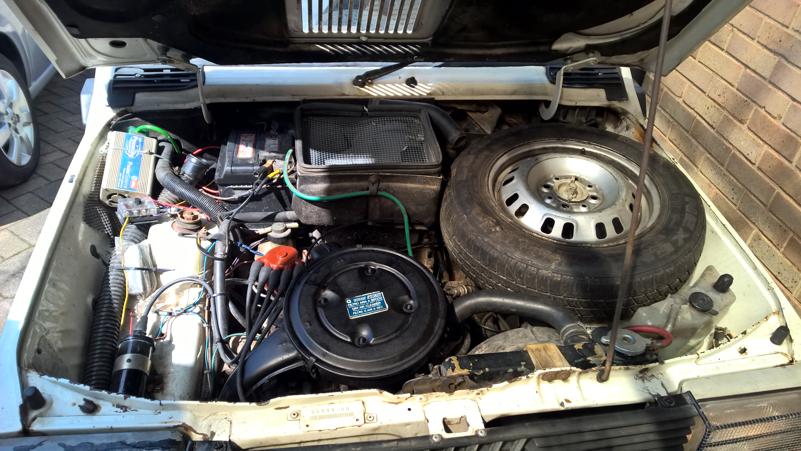

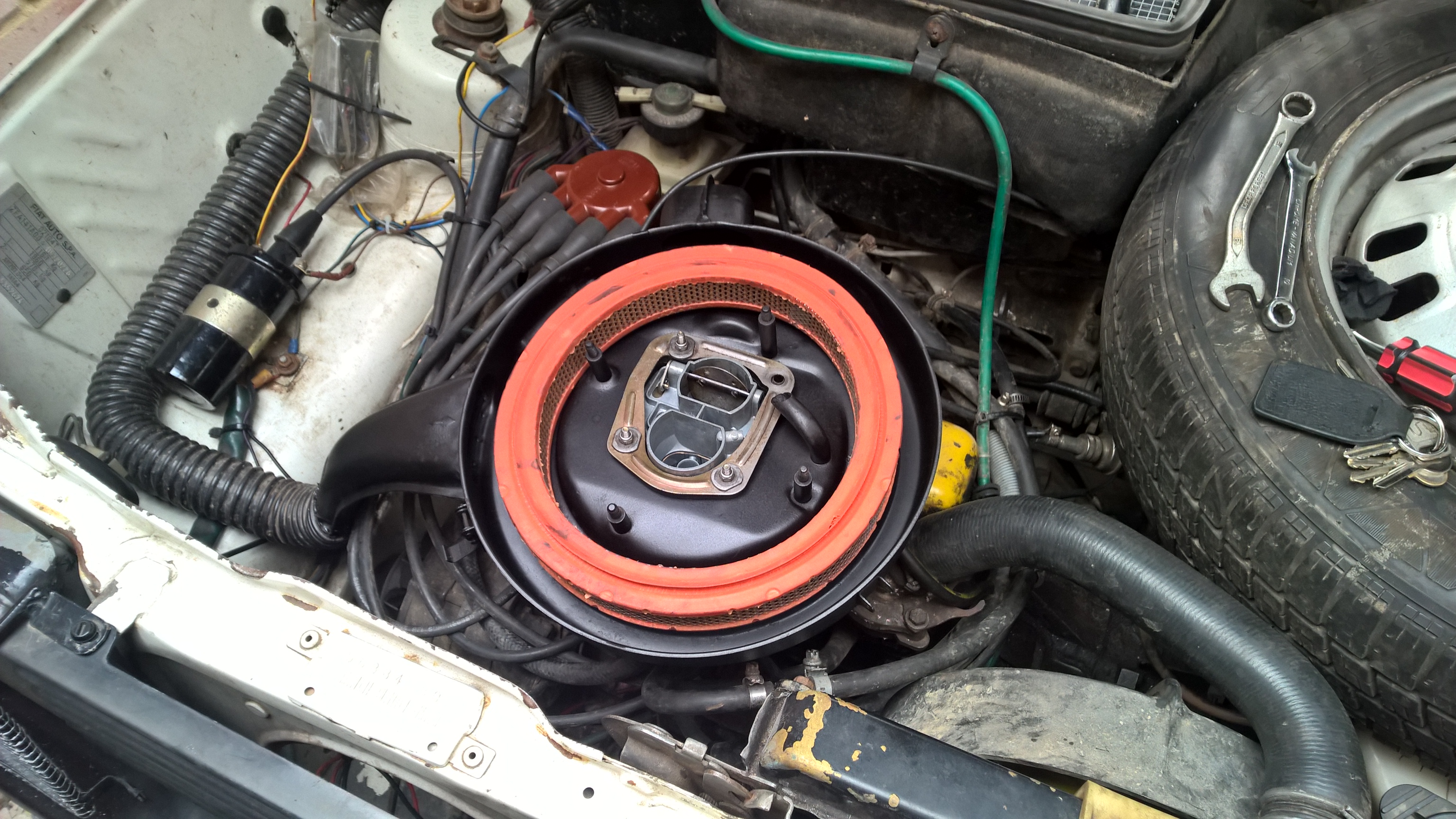

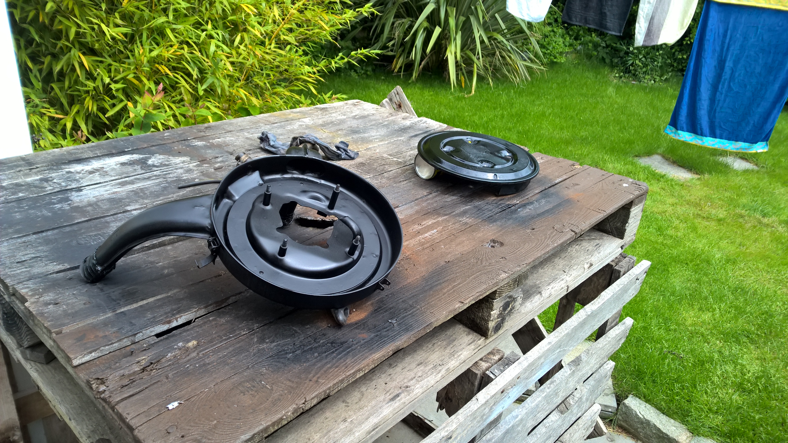

and so with a clean carb it seemed a shame to put the rusty airbox back on (ok now all these things are sounding rude sorry)...
I resprayed with left over BBQ and stove paint which seemed appropriate as it gets hot. I don't know if it is suitably petrol fume resistant though...
So hopefully no more blocked jets (or less frequently at least!) :)
Love the modified spanner - and did you mask off the sticker on the filter lid or buy a new one?
Great attention to detail, either way.
Ah yes, that spanner was a genius attempt to access the nuts which hold on the carb without taking the top half off to get access with a socket drive instead!. I think that's what I did that for. I think was mildly successful. And more relevant on the Lancia engine.
The sticker peeled off ridiculously cleanly! And retained its stickiness!! Impressive for a 30 year old sticker which has been in a hot engine bay on a rusting airbox! There was no rust under the sticker either. Tempted to vinyl wrap the entire car tbh!

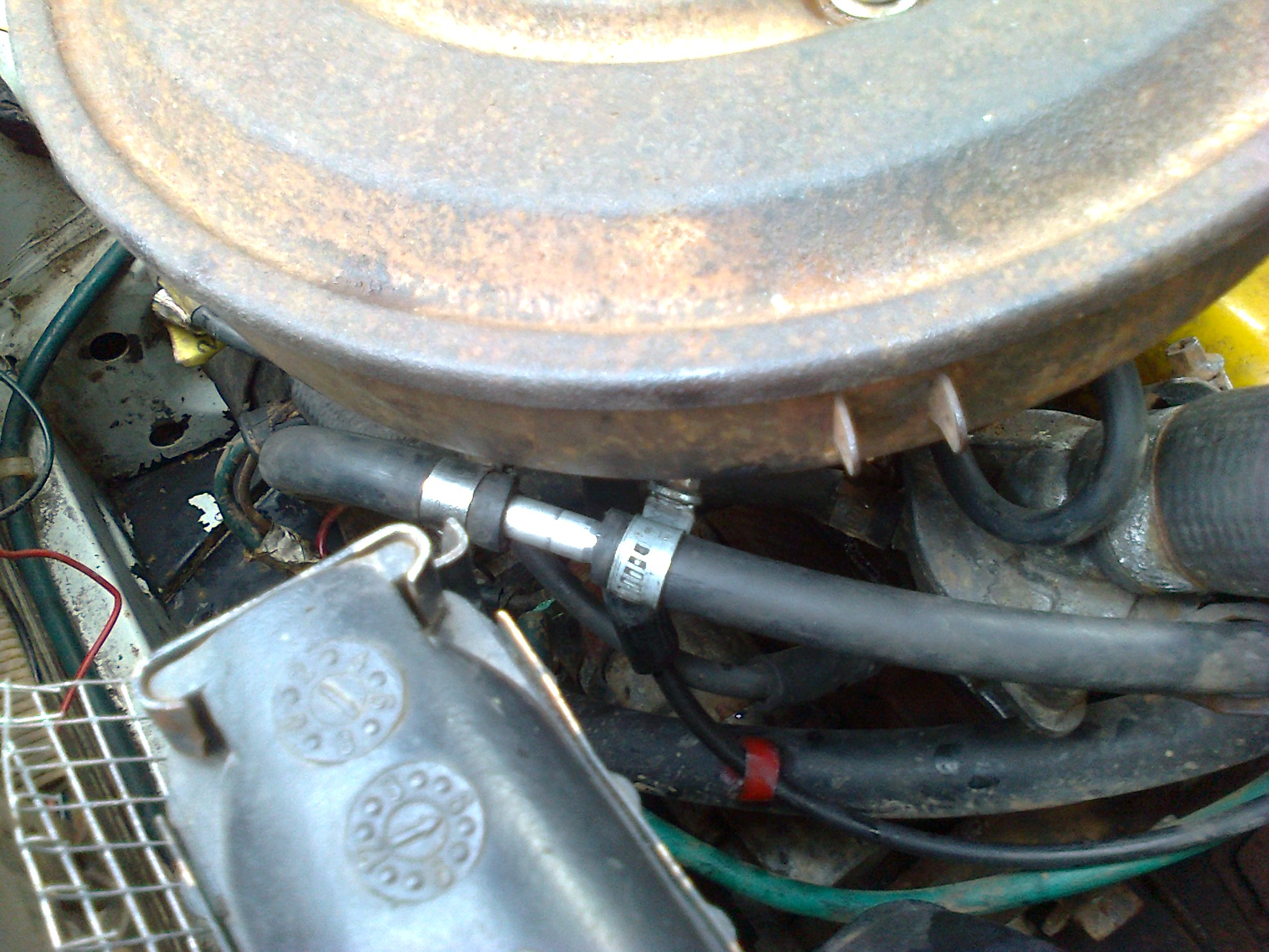

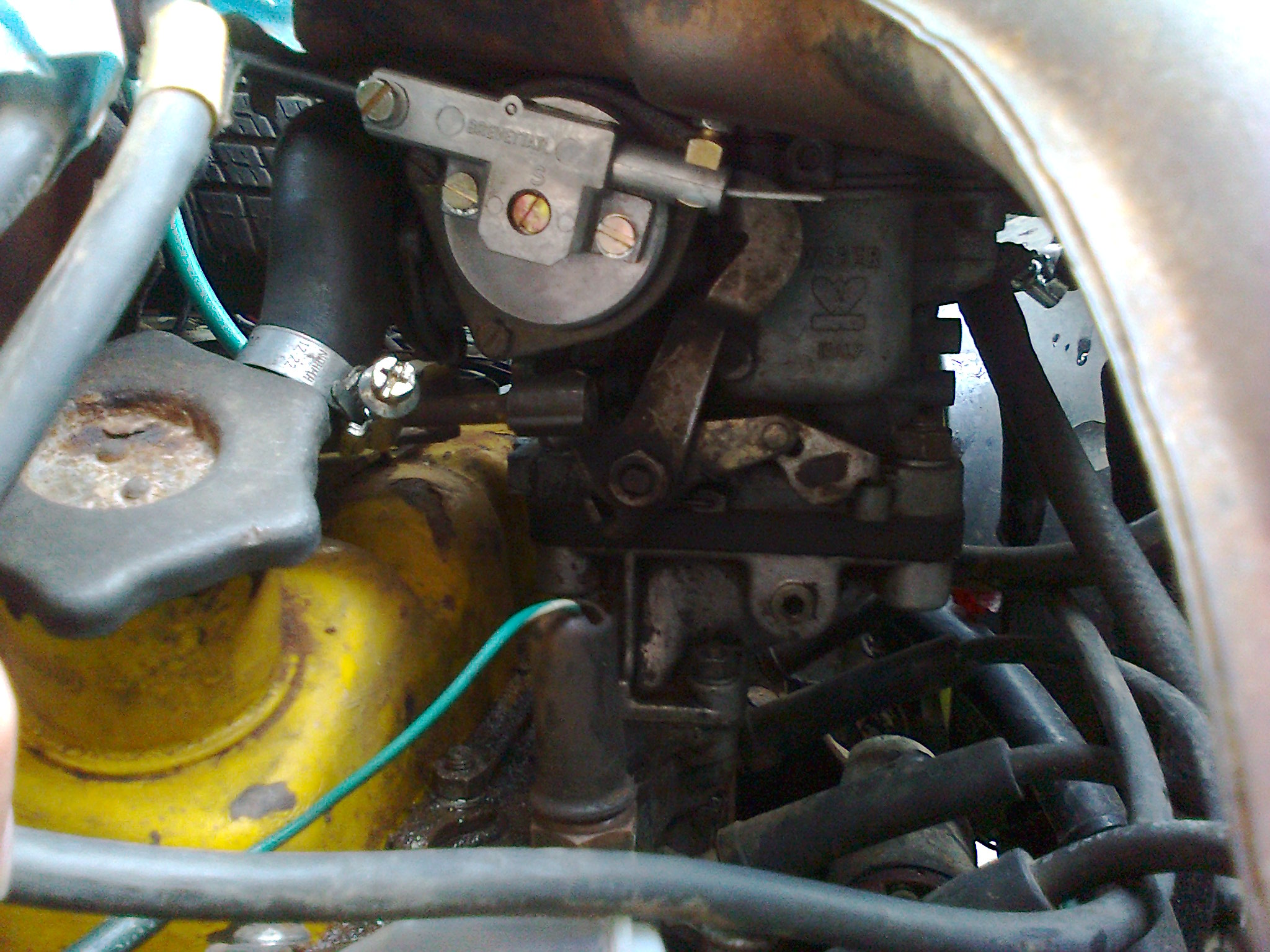

Well Qing Qing hasn't had much love since all her adventures this year (apart from a good clean!!). So I set about sorting out a few things. She was overheating so I checked the water level which was low...that seems to have sorted that out. Result!
However a new fault with the choke has developed (uncontrollable high revs and stalling under load when started up), which was the final straw for the auto choke I am afraid. So I ordered myself a conversion kit (feel like I am living in the 90's right now haha!) like this one.
It basically replaces the spring which moves the choke as it warms up with a spring connected to a choke cable. And what a transformation, runs so smooooth!
Anyway, here are some photos of the new parts fitted:
The new attachment to the side of the carb:
Bi-pass the hot water pipes:

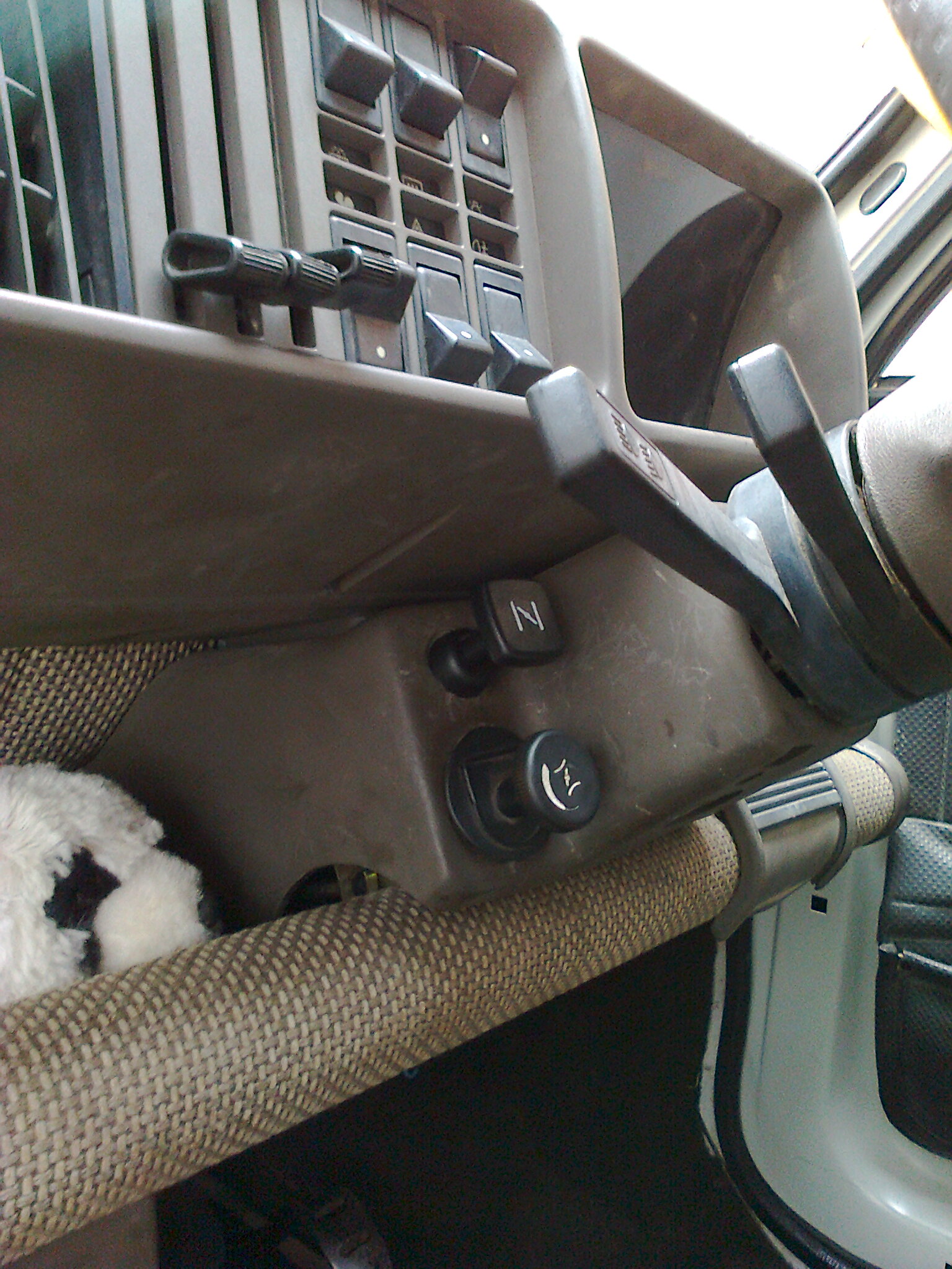

And the really funny bit...
Fit choke where it is normally fitted on the 2wd (and later 4wd I know :p) juuust above the mk1 4x4 engine speed adjuster....wish they hadn't labelled it up as a choke as now it looks like it has 2 chokes!! haha...
Anyway, I should have a nice reliable carb now both in winter and summer :eek:
