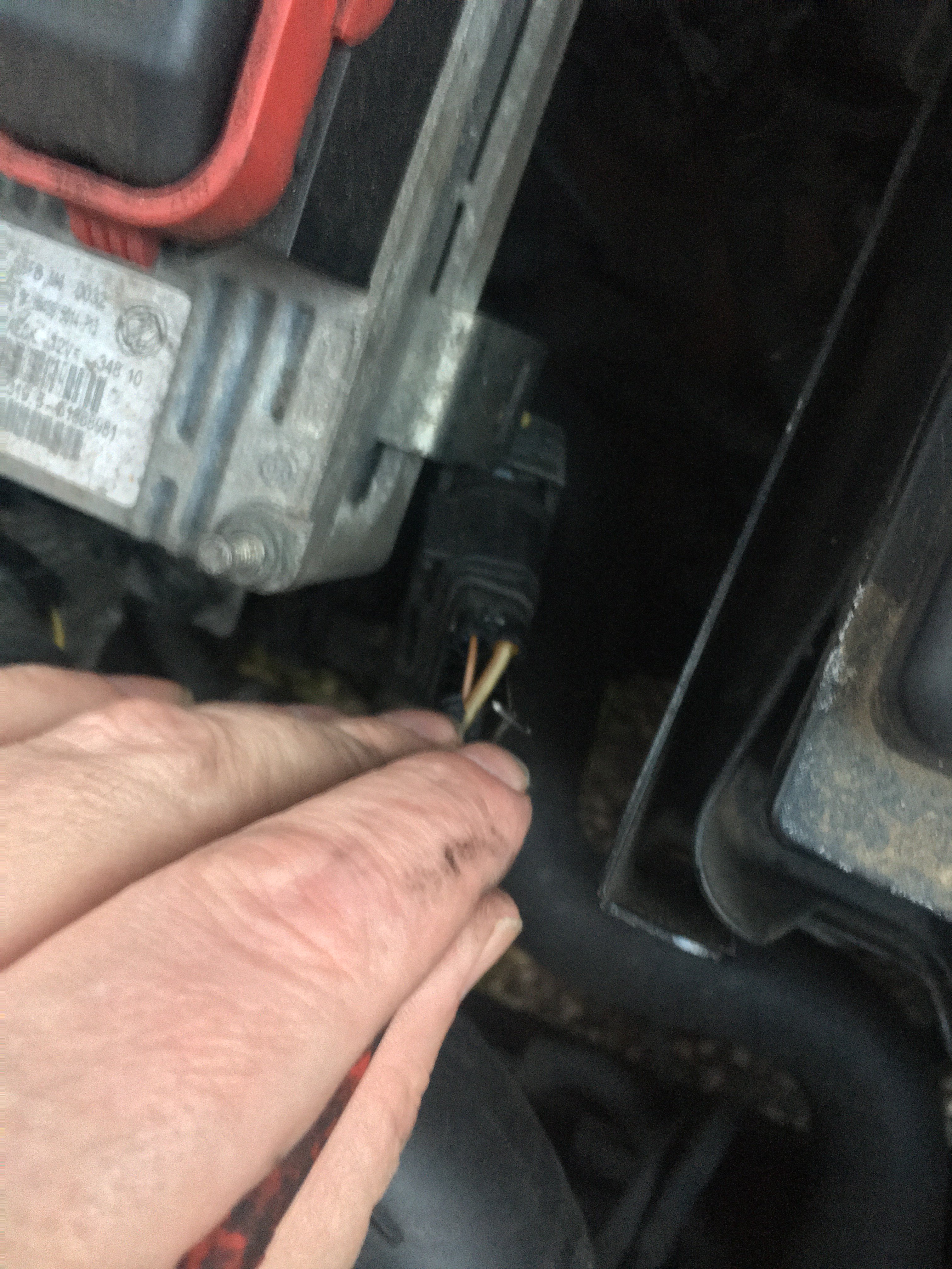

The connector is great
Between the battery and engine
Both the alternator and starter control wires go through it, Saves crawling under the car
Back probed with a T pin on the starter solinoid wire

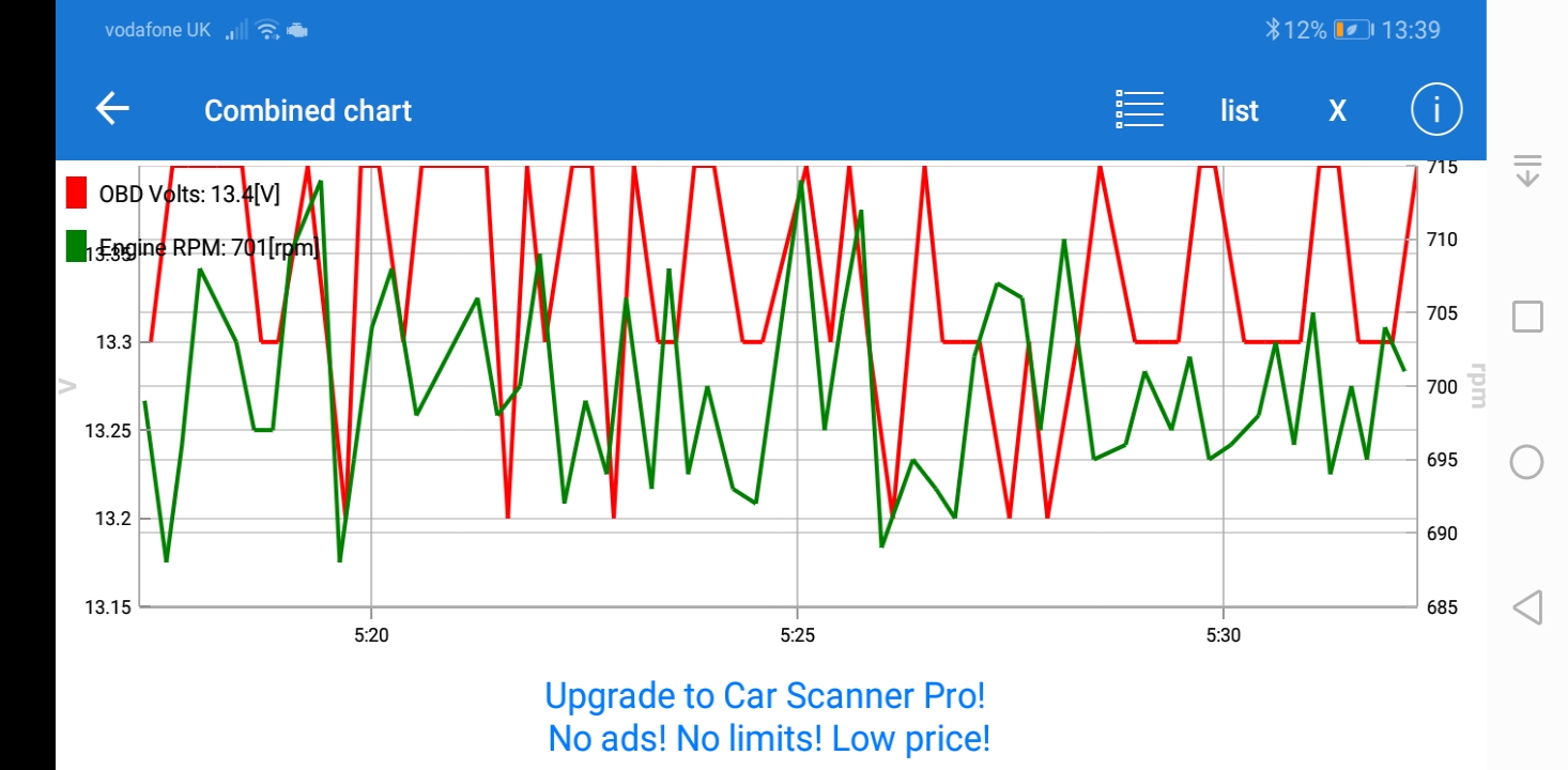

Looks very choppy because of the auto scale, there's a small decrease in revs and voltage
If I leave it to settle there is about 5 RPM drop and 0.1V drop
Here I have all the electrics on, front and rear fogs, fans full, main beam, really struggling to cope revs and voltage are starting to fall

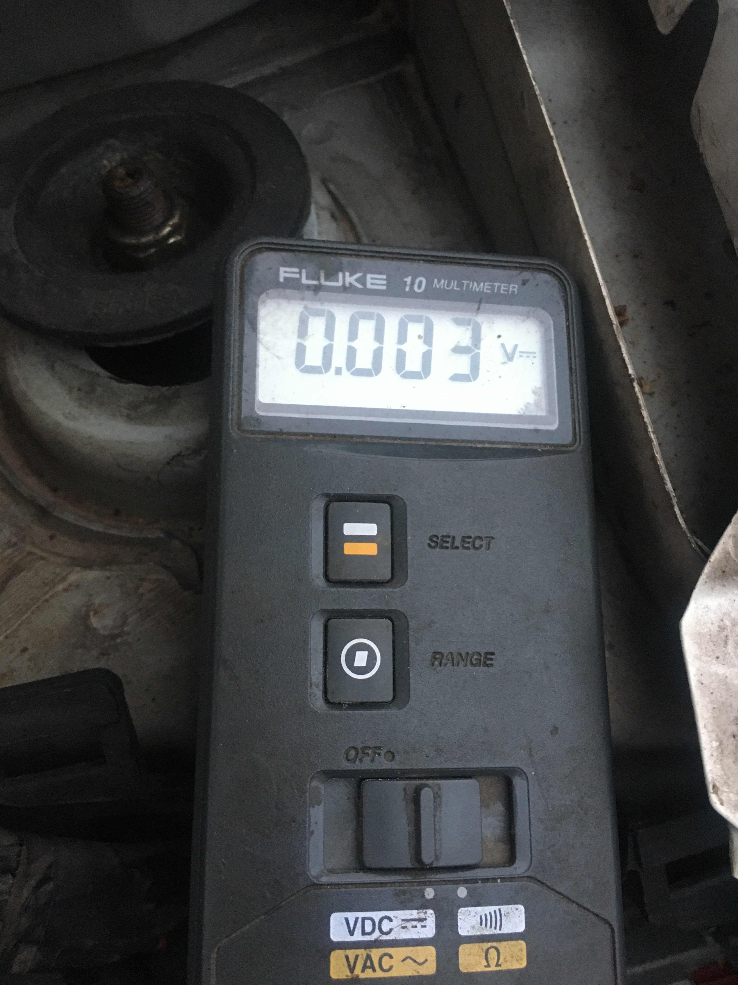

Same connector allows you to back probe the alternator D+ wire
Here's mine
Thickest wire starter
One underneath is alternator

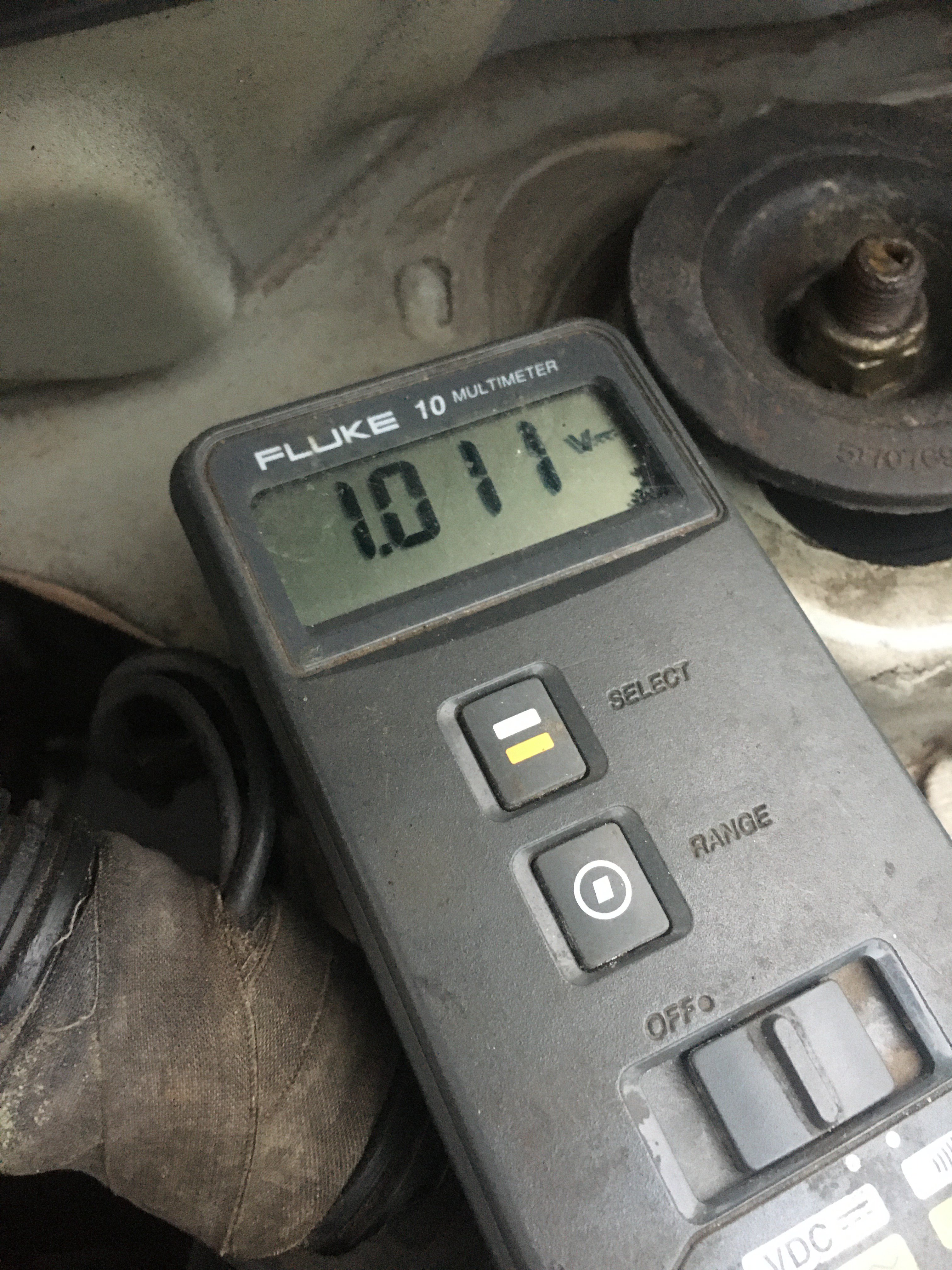

Key out
Ignition on
Engine running
If the ignition on is high check the resistance to ground should be around 1.5K
If way above it's time to check at the alternator post to confirm if it's a faulty altinator or the wiring.

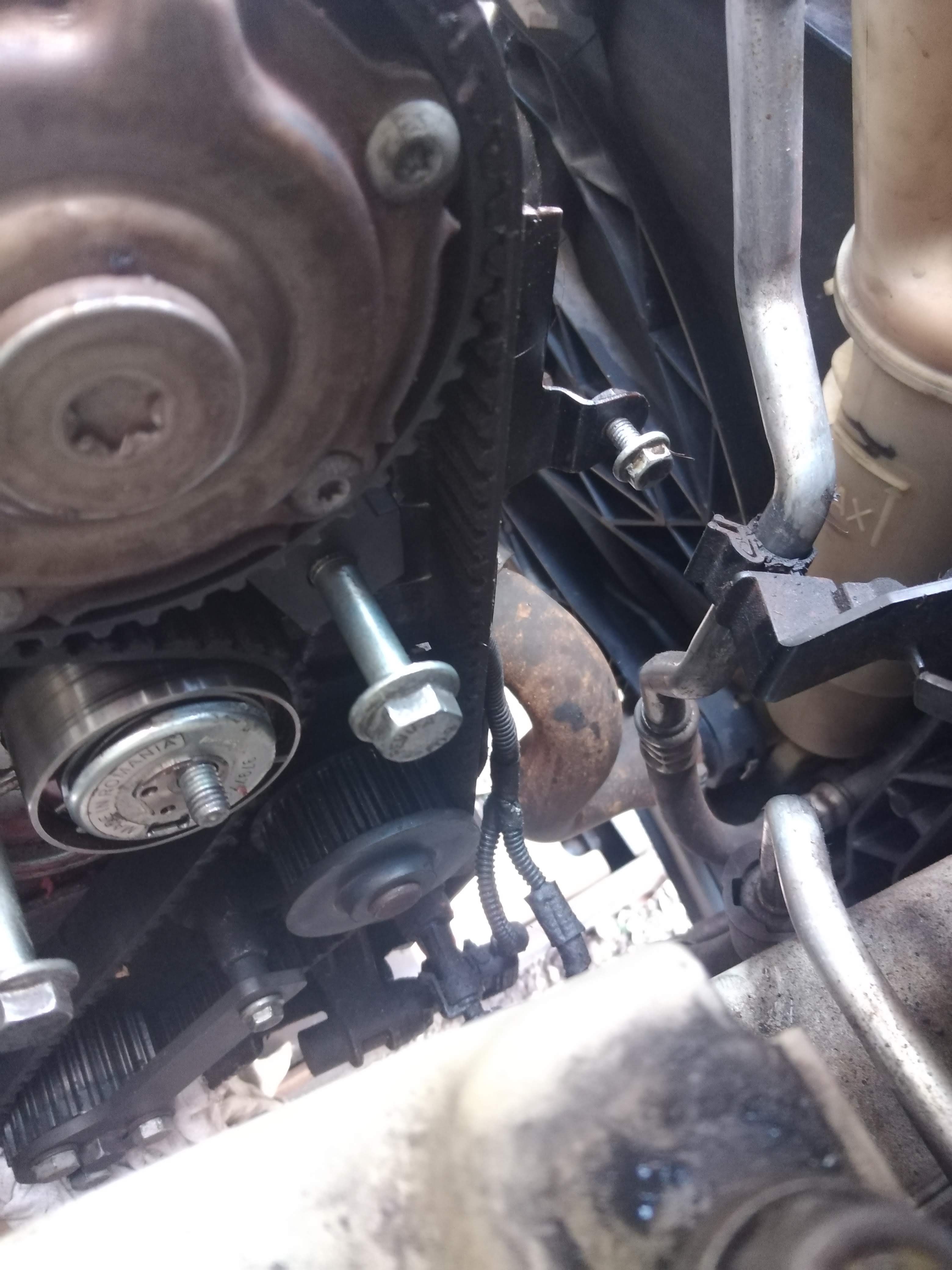

Changing the cambelt on engines that are timed by locking the cam and crank
There no need to undo the pully
However you can not get the right hand side tight enough with them both locked

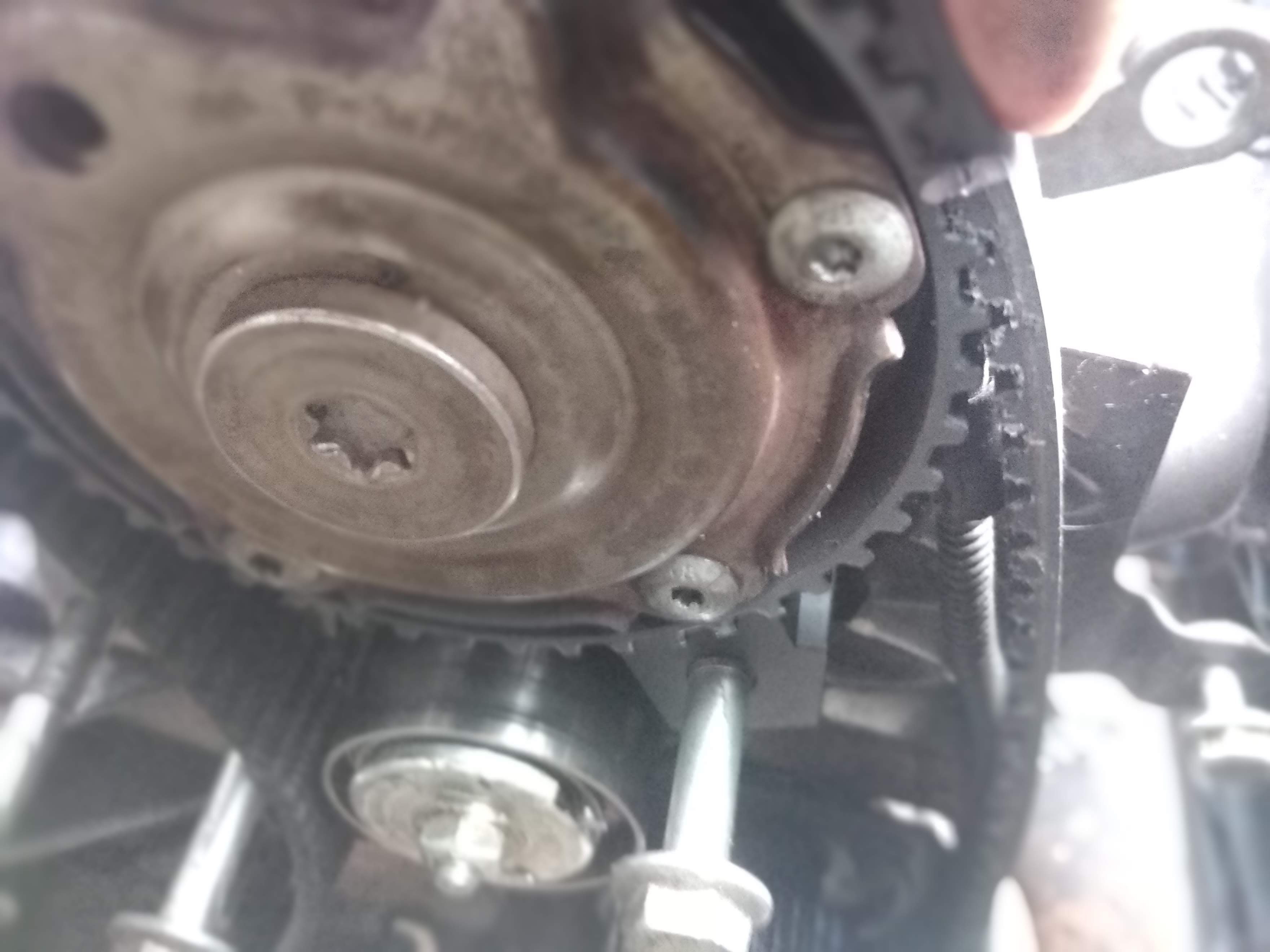

I stuff a rag at the bottom to hold the belt on the Crank pully and pull the belt up to the cam pully, and mark the pully and belt, remove the cam locking plate and turn the Crank clockwise about half a tooth and fit the belt it should look like this while still locked, belt slack, you can not pull it up to the next tooth
And like this after rotating the cam, and rotating it back belt tight
The whole process only takes less than a minuite
A bold statement!
Yep that can read wrong 😁😁😁
Process of putting the belt over both both pulleys correctly without loosing the cam pulley is much quicker to do that it was for me to write it up.
Something that some garages seem to mess up occasionally
The two photos does demonstrate well how even though both pulleys are locked it can still be put on one tooth out

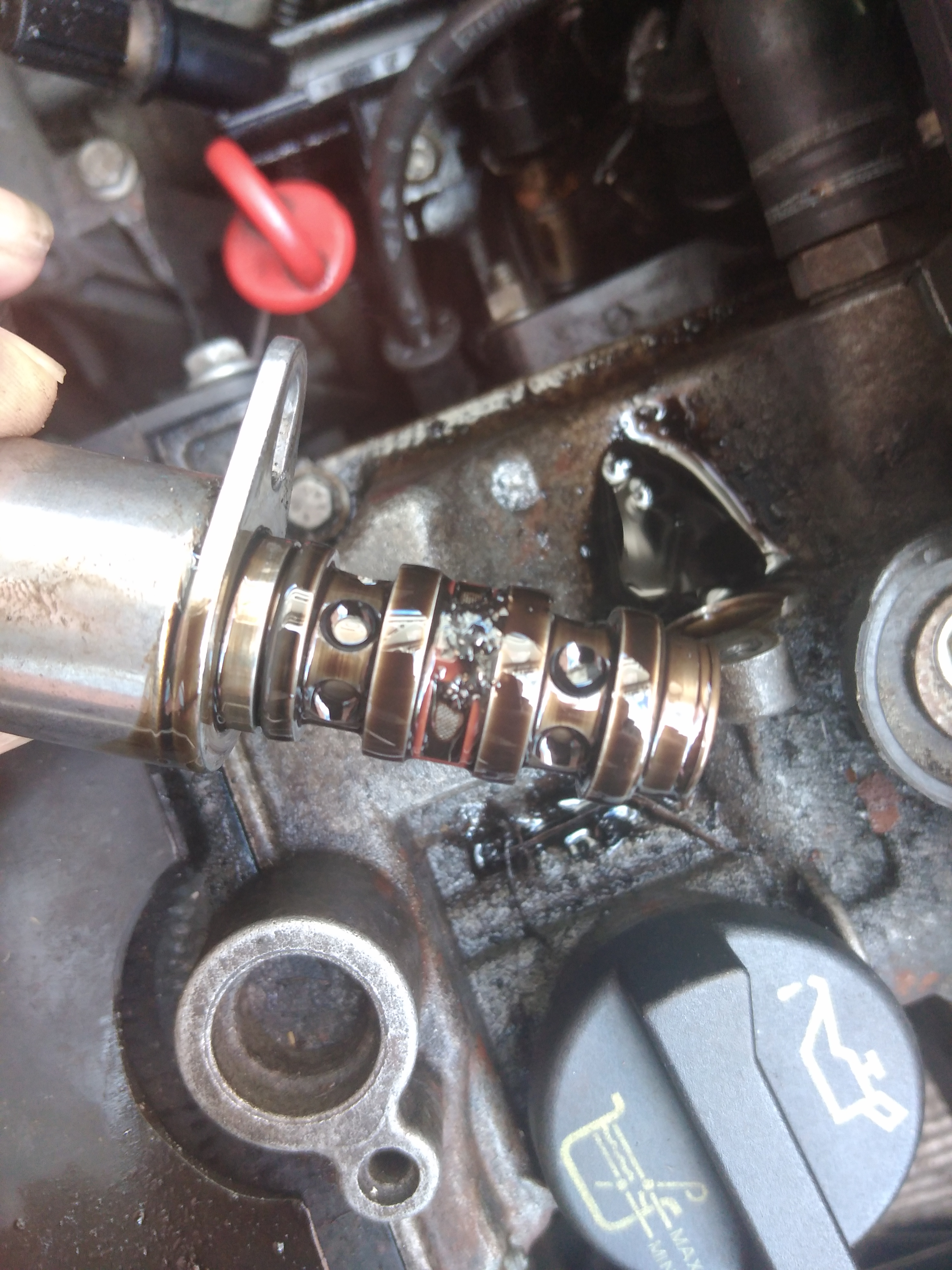

P0016
P0011
Aren't usally serious
They often turn up a few days after head gasket has been changed
Just one bolt
Often looks fine from the top
And blocked underneath, cleans easy with a tooth brush and some petrol
P0016 is also a common code if the cambelt is out by a tooth
