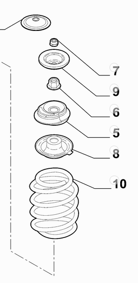

According to ePER no, they are not intended to:
I took the part number from the amazon listing.
Looking further in ePER shows the construction is different for both suspensions:
So even the plate marked 9 is different (51707691 vs 50517346).
Google image shows that it's shape is different, too.
I'd try searching on aliexpress for some aftermarket ones. Or perhaps for some 3d printing projects.

The plastic cover is simply aesthetic, can also protect from water getting into the plates (number 9) and upper nuts (numbers 7 and 10) getting rusted.
