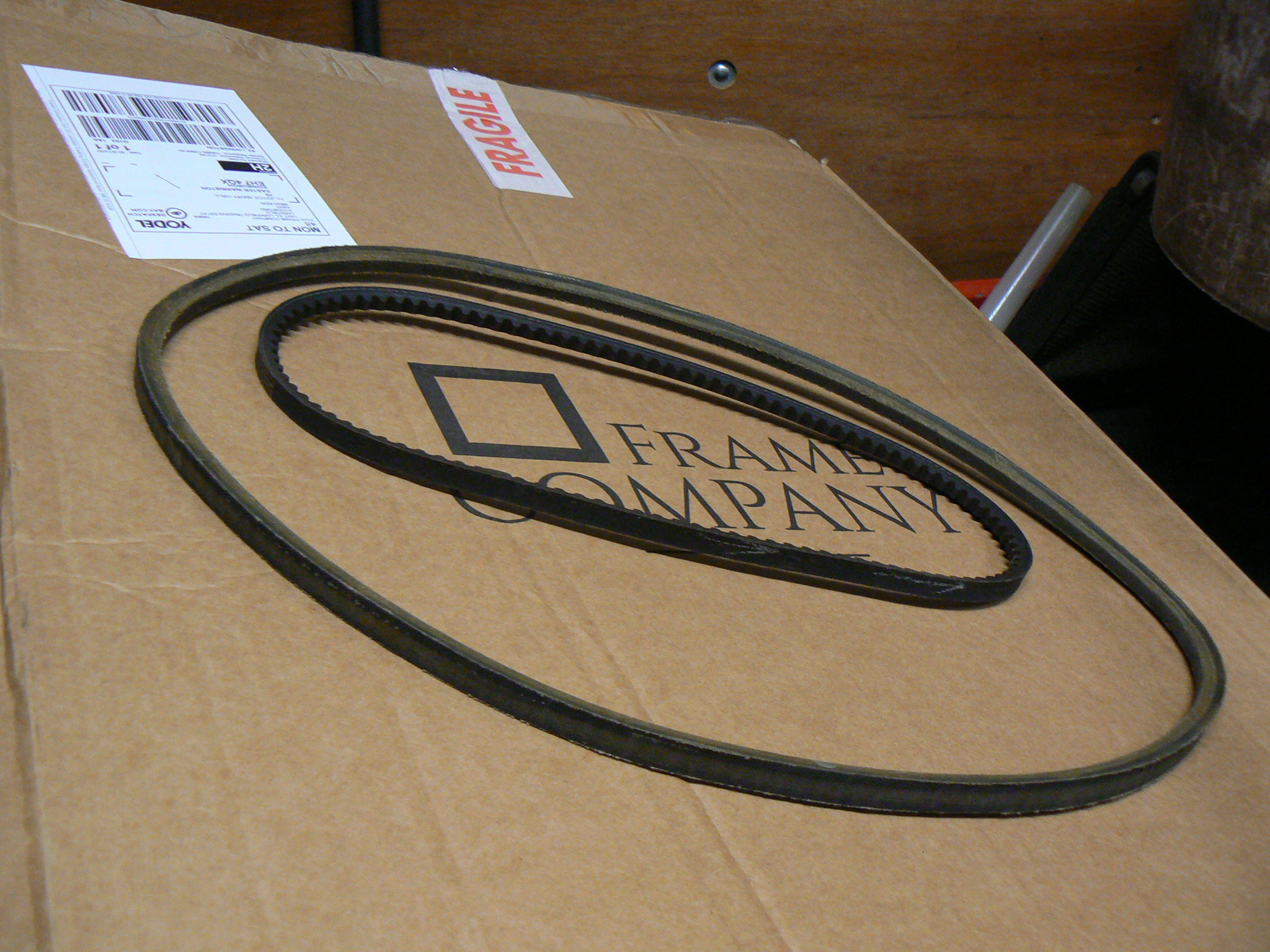

The fan belt on earlier engines (like our '99 Panda Parade) was a simple "V" belt. The older "V" belts were just that with the belt section being in the shape of a "V". As they aged they would often crack and break up due to the flexing so there was a bit of a redesign where they relieved the inside of the "V" to reduce this problem. Many people think that this kind of belt drives by engaging like a chain does, but no, it's only a design improvement to enable longer belt life. Here's one of each type:

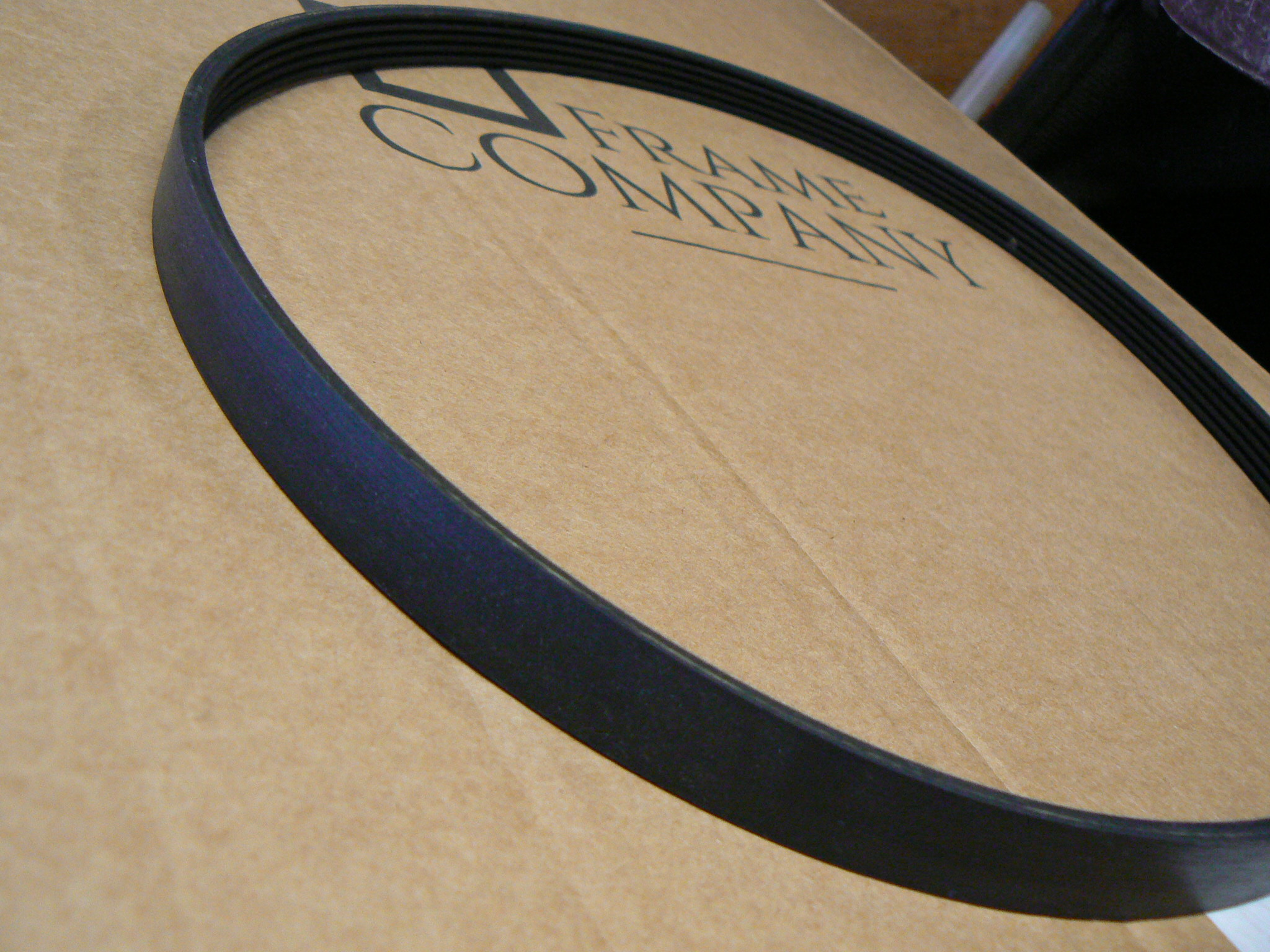

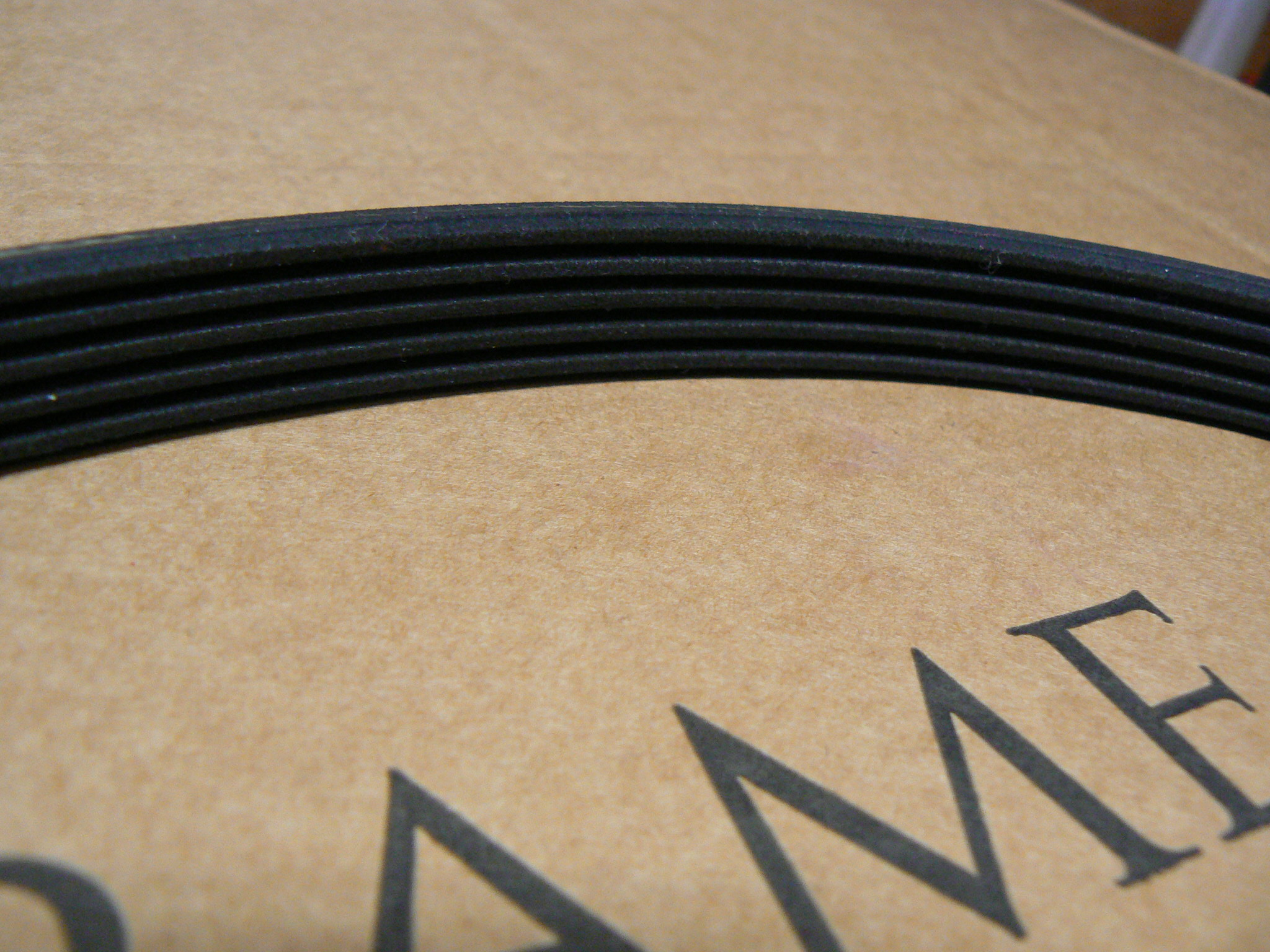

Later models and just about everything I can think of today, use "multi V" belts. This is the one that came off Becky when I did her Cam belt (I would always do a fan belt at the same time):
Looking at the inside you can easily see the difference to the old belts:
These types of belt transmit drive on the sides of the "V" So you can see, it's obvious that the "multi V" design can transmit a lot more torque before it will slip. Alternators now a days have to provide much more electricity than in the past (just think of all the electrical/electronic "stuff" on modern cars and it takes a lot of effort to drive them. Now you know how it transmits drive it's worth being aware, when checking these, that apart from looking for obvious physical damage to the belt look also to see if the belt is seated so far into the pulley that it is touching the bottom of the "V". Often this will be easy to see from the "witness marking" on the pulleys. If the pulley sides are polished right down to the bottom of the "V" then the belt is bottoming out and, even if it looks almost new (someone may have fitted the wrong belt) it's not going to transmit drive properly. Rather more difficult to see on the "multi V" set up but still possible. Because the belt transmits drive on the sides of the "V" it's the sides which wear and as it does so the belt will drop deeper into the "V" until the inner diameter of the belt bottoms out in the pulley. Once it does that the sides of the belt can no longer grip the "V" sides of the pulley and it will slip!

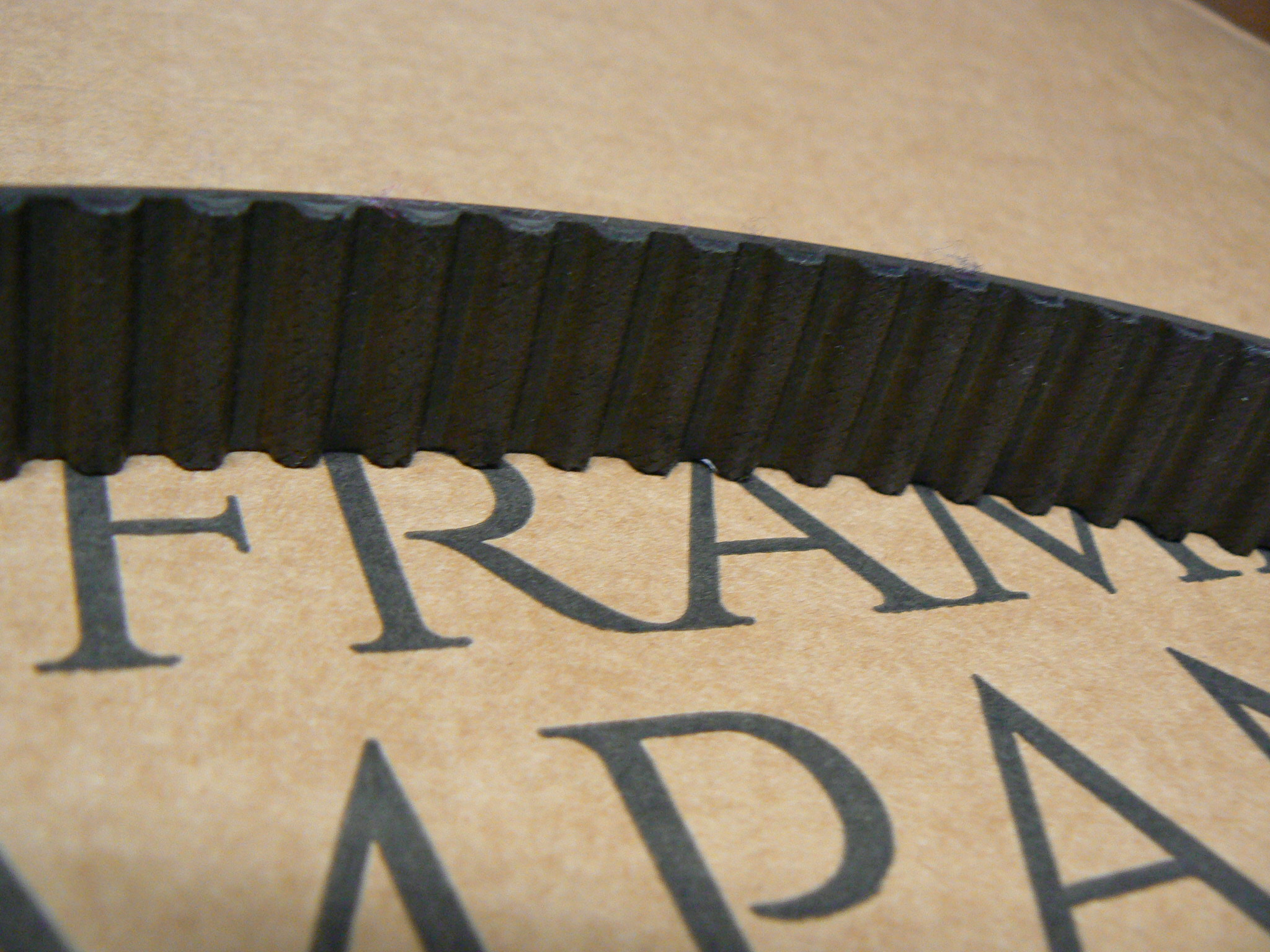

Timing belts are synchronous belts and drive using molded in "teeth" - as you can see here on Becky's old one:
