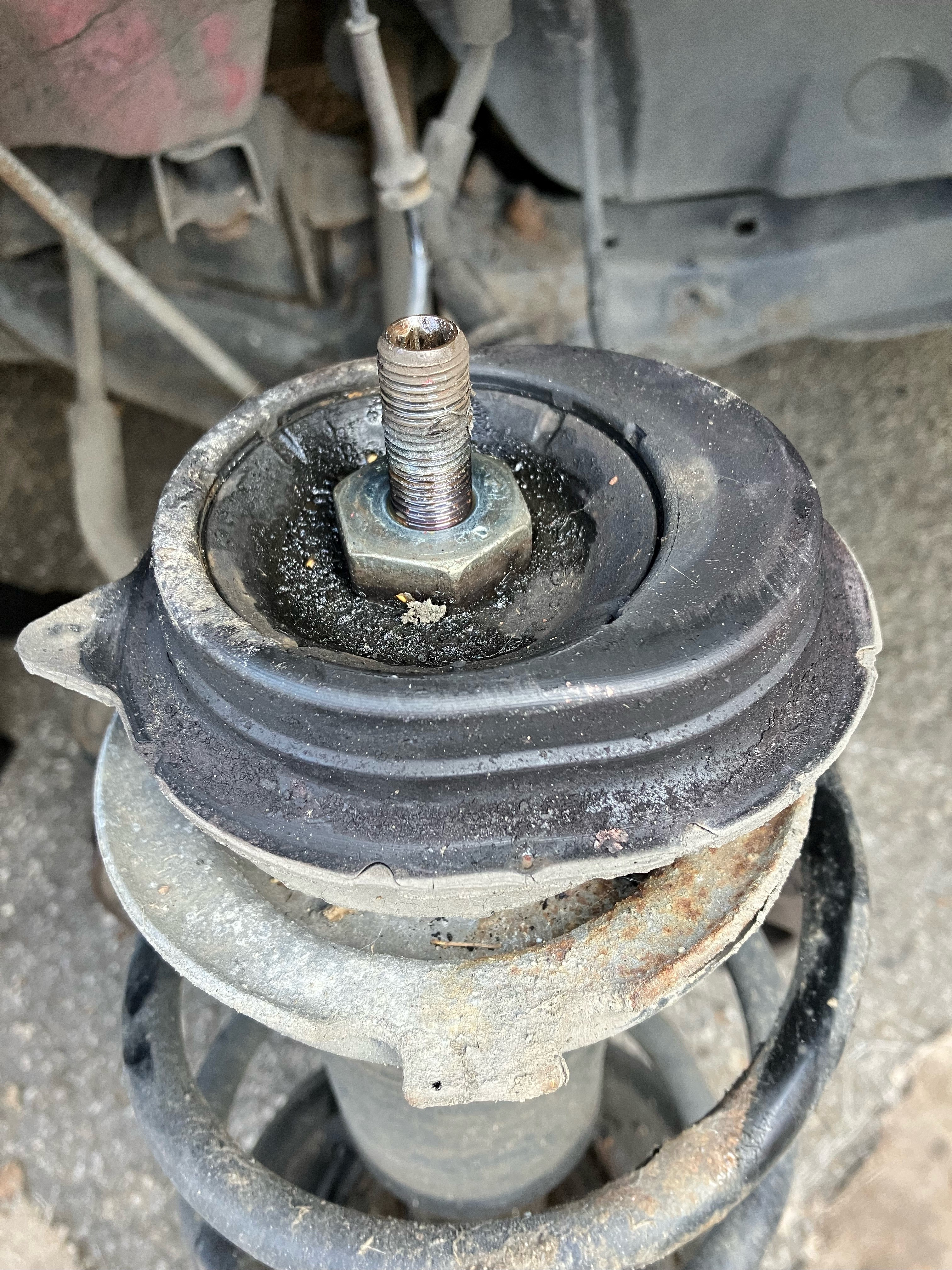

No, never been off and both sides are the same. Owned car from new.That strut been off before?

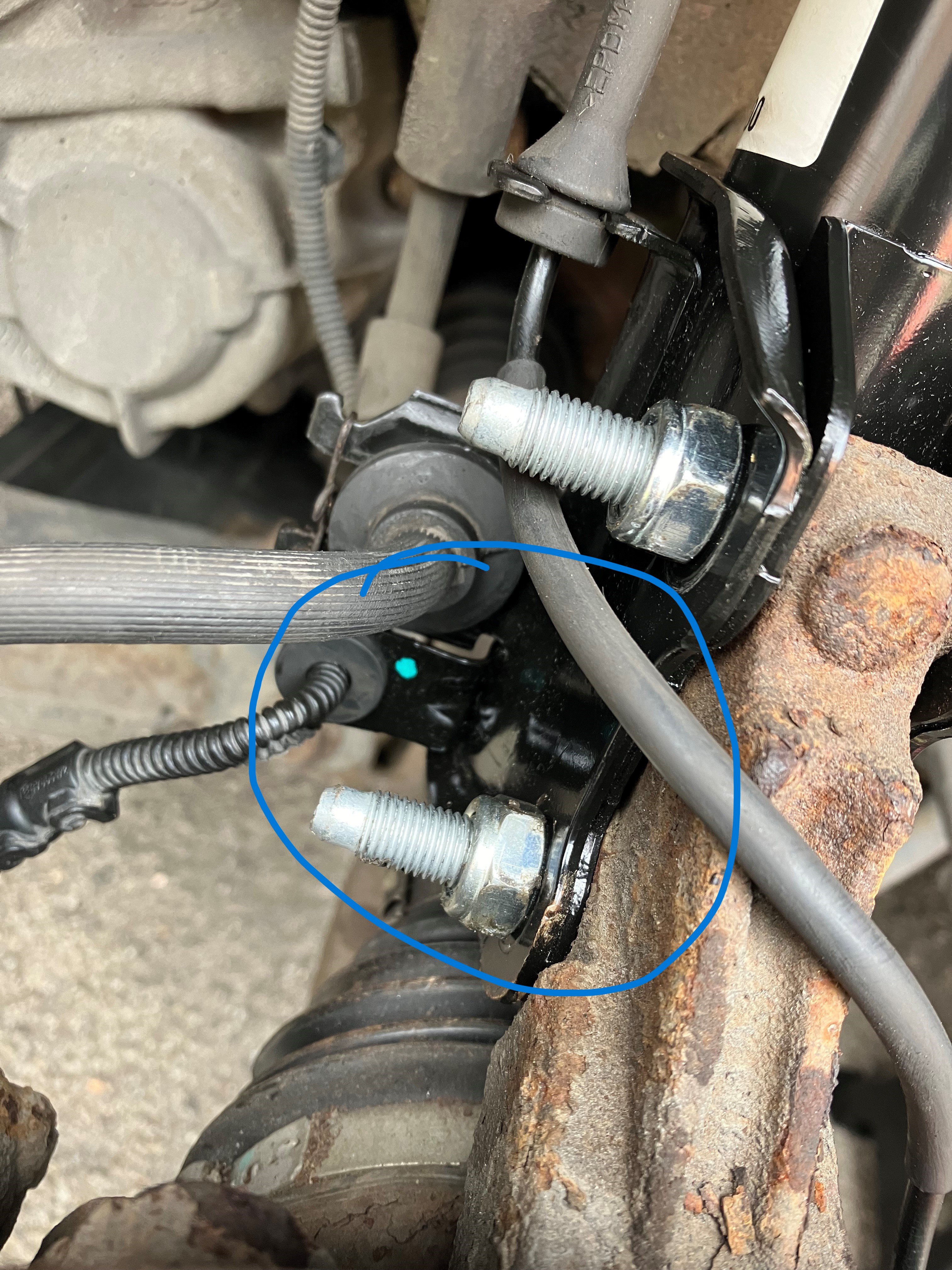

The bolts are in the wrong way, should be nuts to the rear
Is the 500 different to the Panda? - they have the thread pointing forward like the picture...That strut been off before?
Oops my mistake bolts inserted from the rear not nuts thank you allIs the 500 different to the Panda? - they have the thread pointing forward like the picture...
Yes the (169) Panda is fine - but the scuttle design on the 500 naturally funnels the water into the strut tops...Fiat introduced caps for them, to prevent a recurrence. Seems to affect the 500, not so much the Panda.
