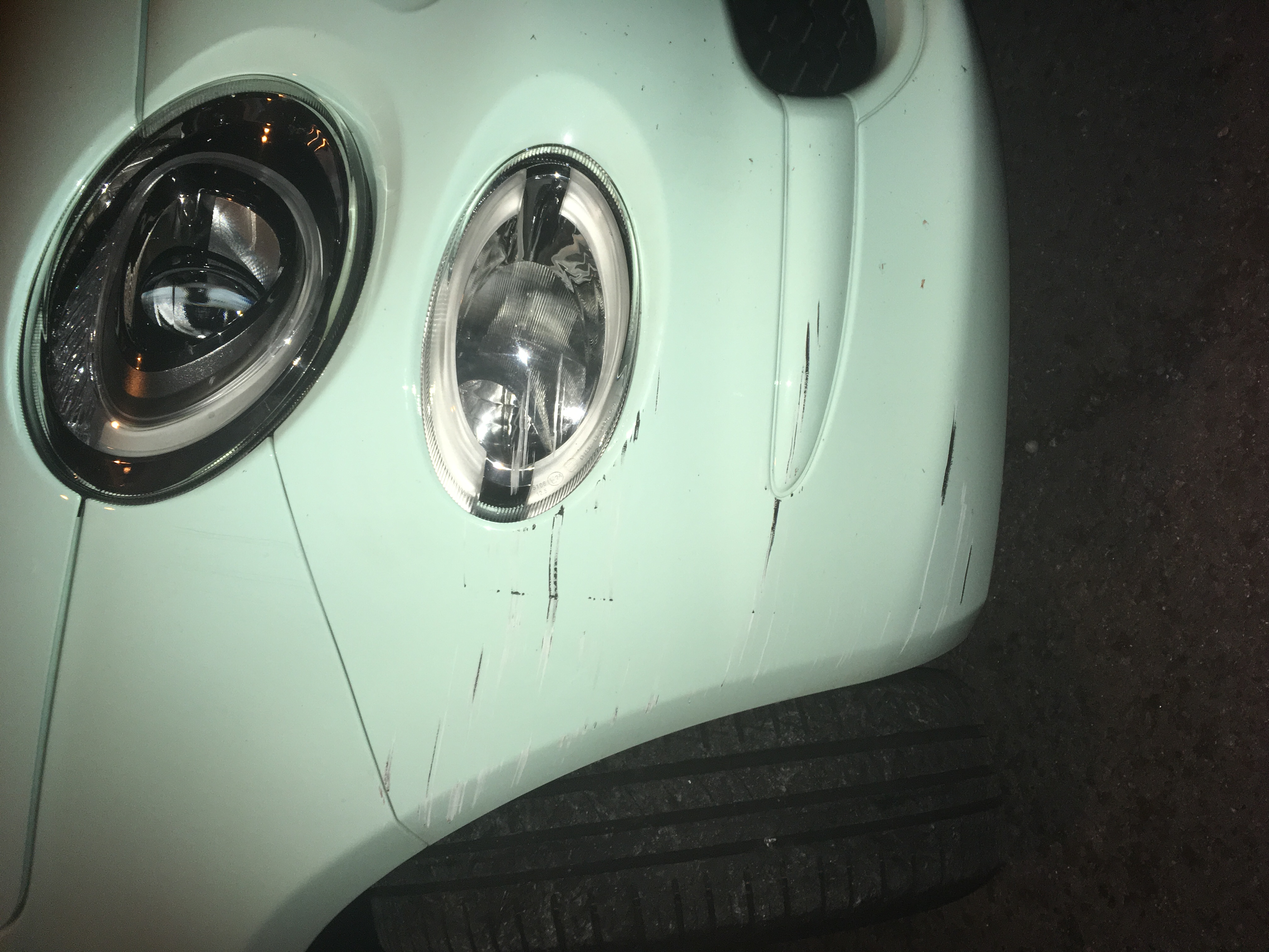

Well after a few months of extremely careful driving, my clumsy side got the best of me and I've scratched my lovely new fiat 500 :( sad that my first post on this forum is so sad, but hi all! Does anyone have any tips on how or where to fix the scratches? It's in the cool mint colour so not as easy as a black or white car (I assume?)
Thanks in advance!
Photo for reference

Hello! Firstly, do you know what you scratched against?
Secondly if it is plastic it should be relatively easy, recently our bin men decided to scrape our bins between the side of my 500 and my wall of our driveway, I took it to our local fiat accident and repair and the evaluator who asses what the best course of action is walked up to the car and started rubbing the marks and they disappeared before my eyes [emoji43] I could not believe it, just try and give the marks a rub with your hand quite vigorously that's exactly what he did and then just gave the panel a polish and wax and it's good as new :)! Let me know how it goes! Aarron

Go to your local autoparts shop, buy a paint claying bar and some lube. Read the directions and go for it. Follow up with a cut and polish. A few spots may not come out perfect, but you can cross that bridge when you get to it.
Wow that's amazing! It was the side of a brick arch :s I'll have to give rubbing it a try!

I think where you can see the black, it will be OK and will probably polish out, but where it's showing through white, that looks like it's gone down to the primer, so will probably need a respray.
It's worth keeping an eye on eBay as you often get bumpers of that colour advertised. You can pick up a bumper for less than £100 in perfect condition. Just have to put up with it until you find one in the right colour. There is one on eBay now, but it's in worse condition than yours.
Its a re spray job, you could try a scratch repair service ( that comes to you) like Chipsaway? bank on £300-500
