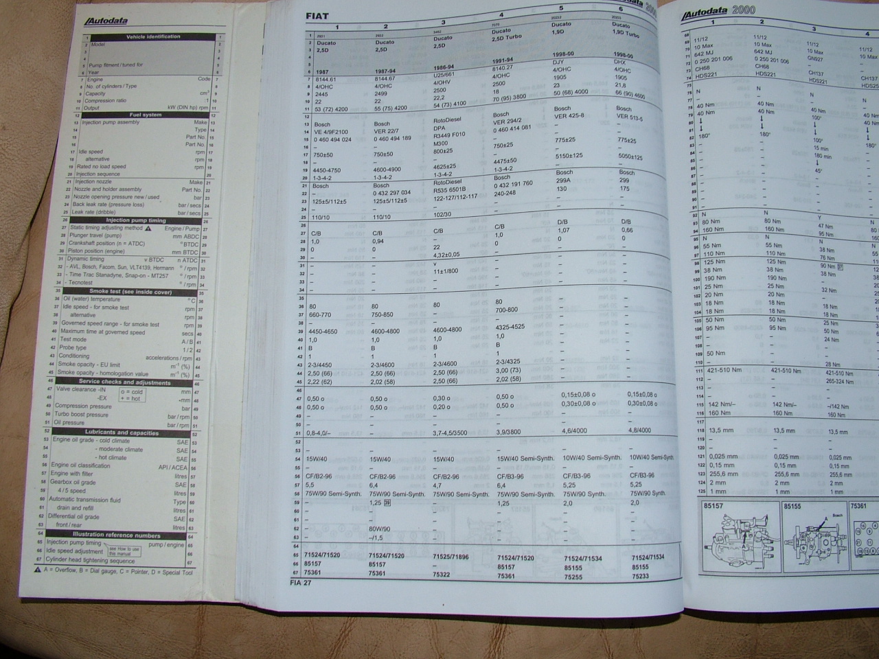

Any good?
Thanks for reply but it is a 96 I did it years ago and im sure i put in EP 80W90 GL4 from Halfords 3litres I was hoping someone could back this up Cheers
That was a 2000 year manual but only gave details of your vehicle to 1994, these manual were what the trade used and at the time cost around me £100 each year.

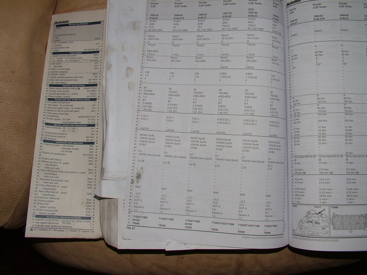

This is a 2012 version.
