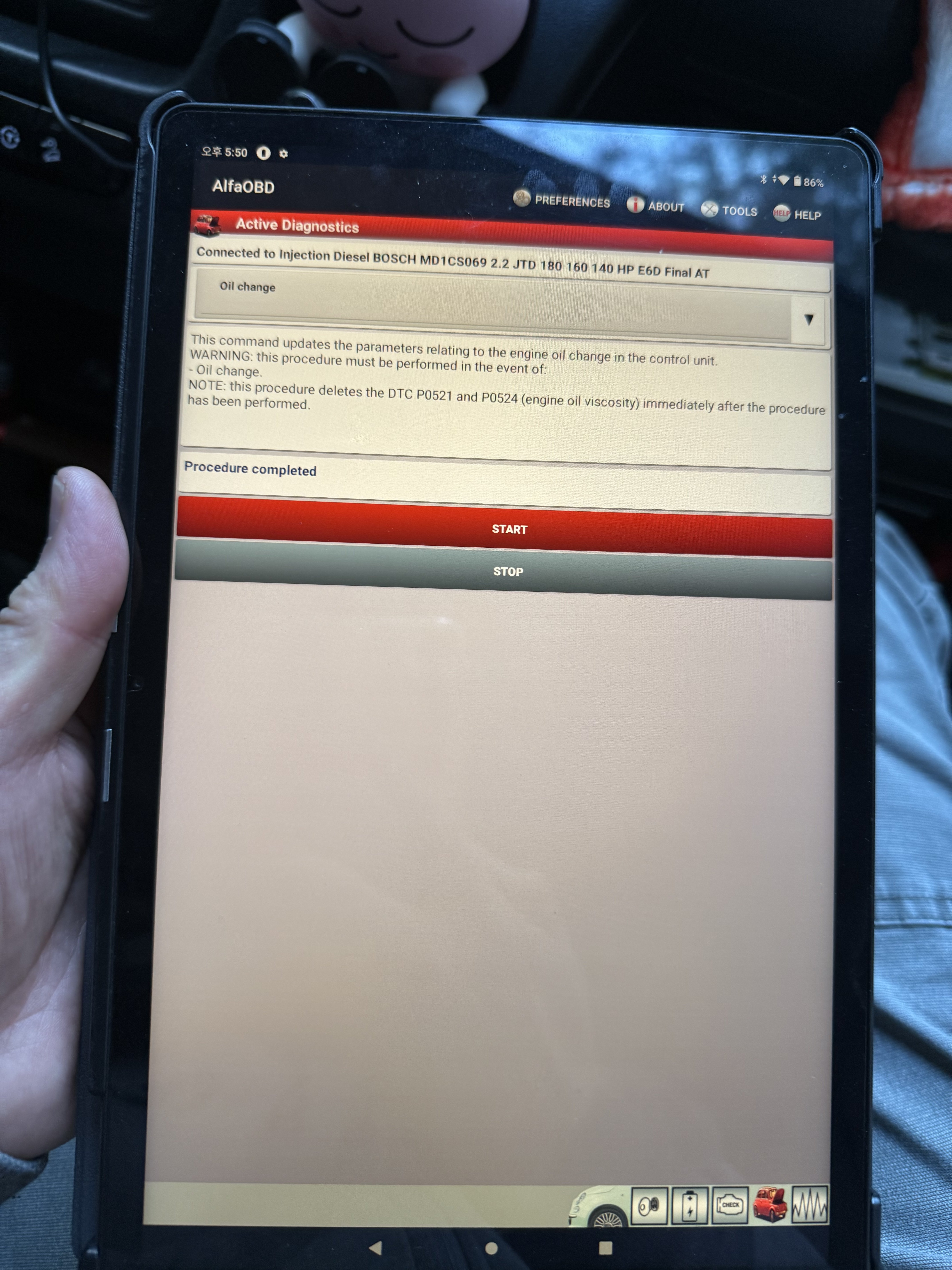

It's a van that was shipped around February 2023... After the oil change, the oil change process was successful at alfaobd. The oil life was reset to 30000km again at the current count. I want to change this 30000km to about 10,000, is it possible? I haven't found the item on alfaobd yet.

I see.. Somehow there is no menu.. thank you.
In MES, under the Service menu, select Adjustments, then Service Interval, and write the desired interval mileage.
In AlfaOBD, there is Services Interval Write under Instrument Cluster/Active Diagnostics, but a note attached to the function states it only works with clusters with SW version 1426.
