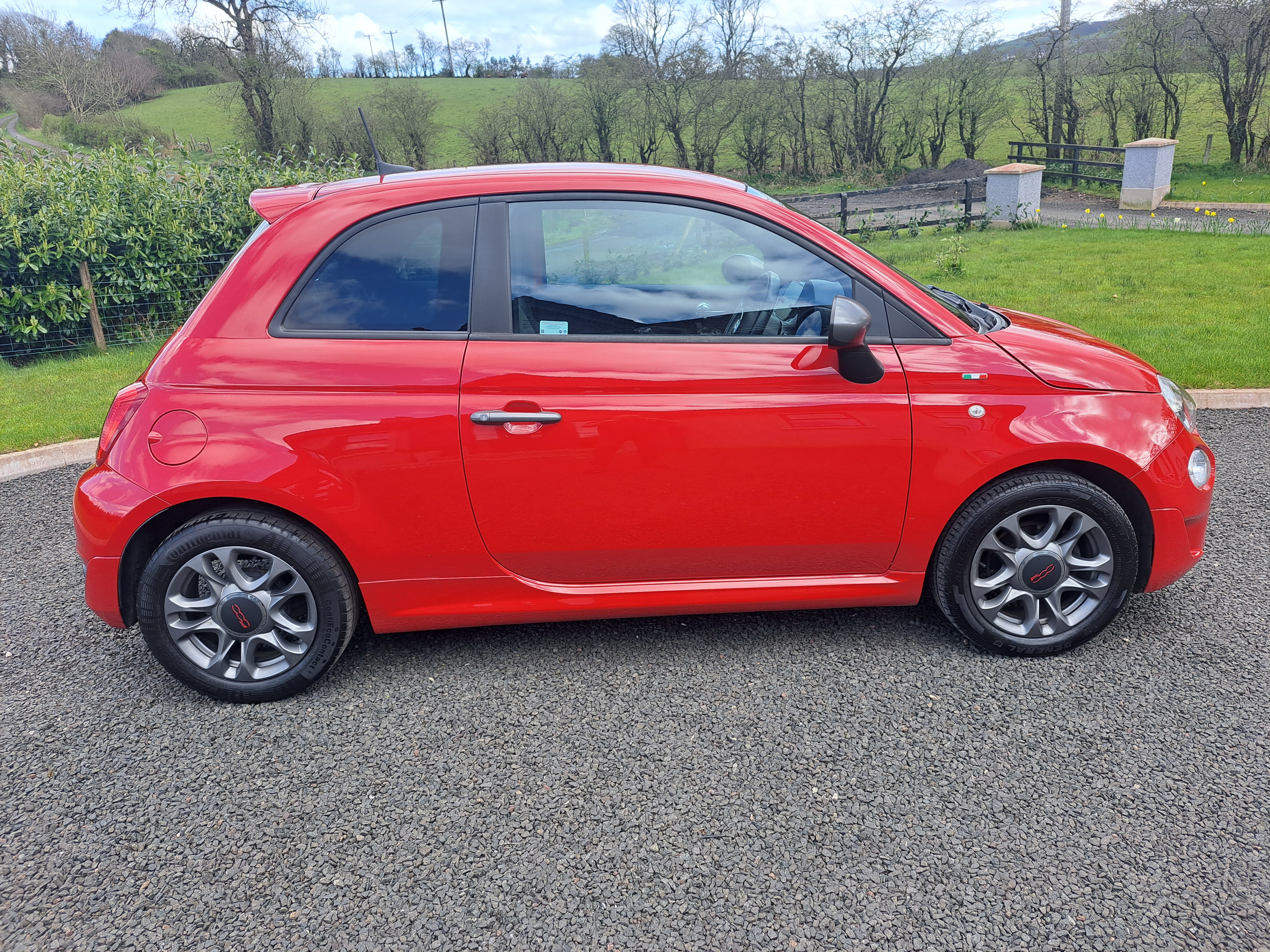

That was my introduction to 500's, we hired one specifically during a trip away as my wife was considering buying one. It didn't put her off and she bought a lovely 2019 500S a short time later. Their foibles and idiosyncrasies will no doubt come to my attention in the coming years as I'll be the poor mug left to fix it!
I didn't. Never even thought to!
