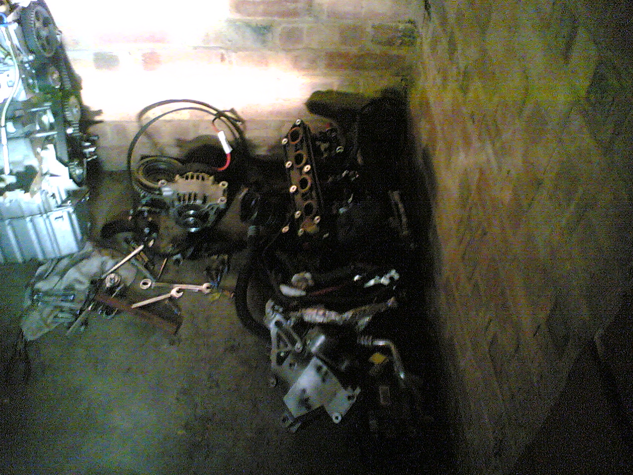

Right, poped over James100hp's tonight and removed a spitfire gear box and then headed off to the garage to do a little bit more :)
Sadly didn't have my camera, and this garage has no electric (all work done by headlights) so excuse the picture quality.
Here's where the engine is at now:
All the looms, ancillaries, manifolds etc are now removed, pretty much a bare engine.
Here's what was removed and left over :D

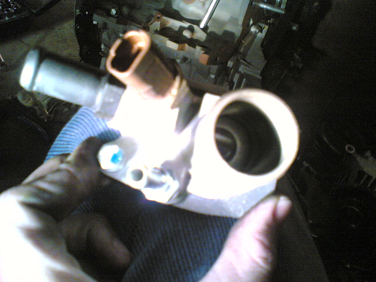

This I found interesting, and may be a neat solution for anyone doing a water cooled turbo conversion etc. Its a thermostat that will fit all the cento/punto heads, but it has the normal outlet, inbuilt thermostat, and a large and small take off for coolant pre thermostat. One is designed for the heater core as its capped off the normal hole by the manifold. I'm unsure what the smaller outlet is for, but both can be unscrewed and capped/adapted! (y)
Here's the engine mounting that the cento uses, hiding under the alternator/aircon bracket:
This poses a problem, the alternator fits to this, but the mount covers the holes, so i have to ditch the mount, the alternator, the aircon pump, the cam pulley, and then fit a cento alternator and mounting bracket. If i do this i need the 1242 16v crank pulley, or the 1008 and modify the crank sensor to sit in the correct place like on the 1242 16v conversion i did.
I am keeping the COP though, and running them in wasted spark, as it looks neater and is technically a more reliable solution.
The gaskets are metal on the head and extension if anyone cares.
Hope your all enjoying the progress! looks like I have to sell some parts to make some money for the new bits i need.
