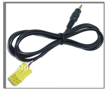

Firstly you will need to make up a lead.
Bought a screened 3.5mm figure of 8 jack extension cable crop the cable to length then seperate the 2 wires...
strip the outer black sheathing off about 3"..
next gather up the outer strands and twist together (these need to be insulated with heatshrink tubing and ideally soldered at the end)
strip the 2 coloured cores (one is left and the other right) ((right is usually red))
and crimp on 110 red female spade crimps to each wire and the outer strands
next insulate the crimps (i used heat shrink)
and use some tape to hold the wires into the crimp as an added fail safe

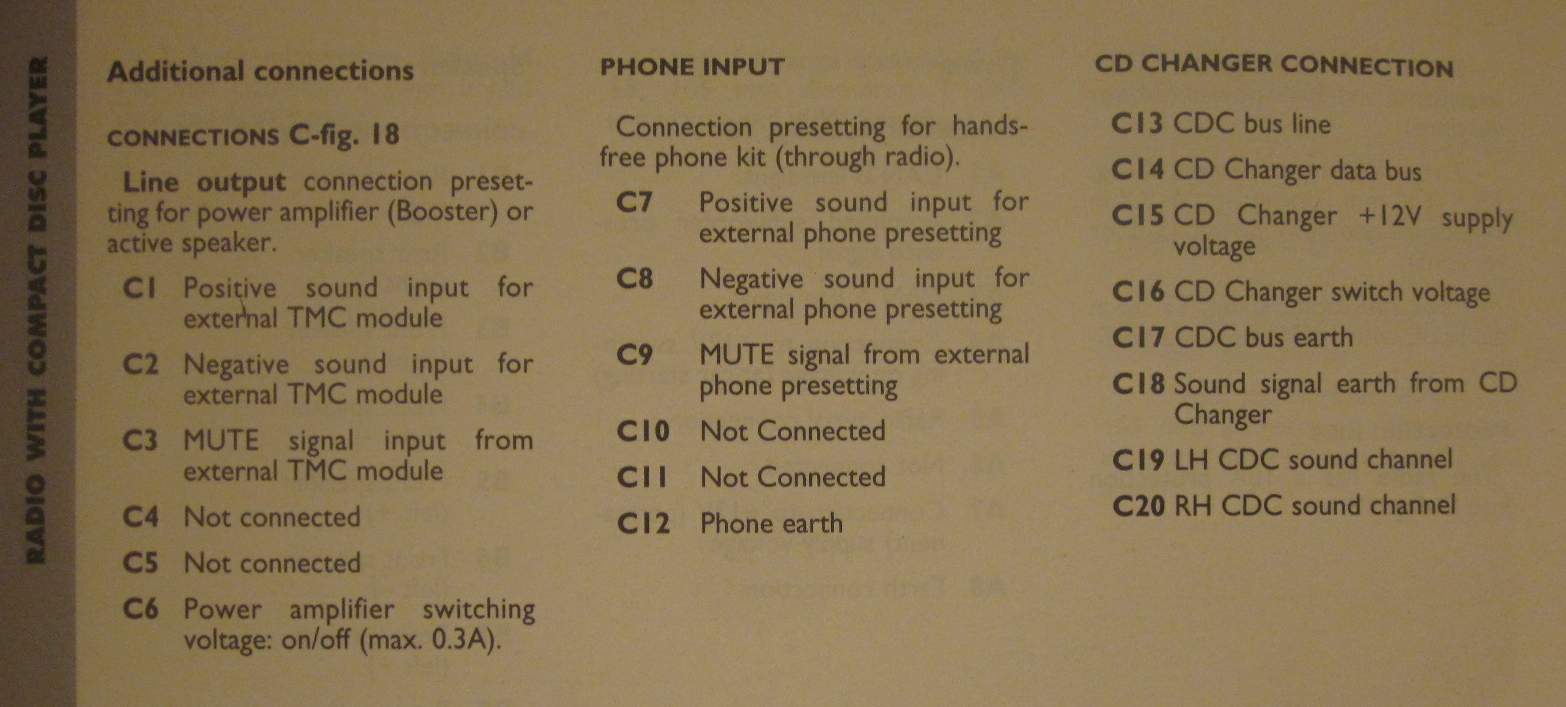

locate the AUX socket
your looking for A.AF-R (PLUG THE RIGHT wire in)
A.A (earth symbol)
A.AF-L (plug the left wire in)
