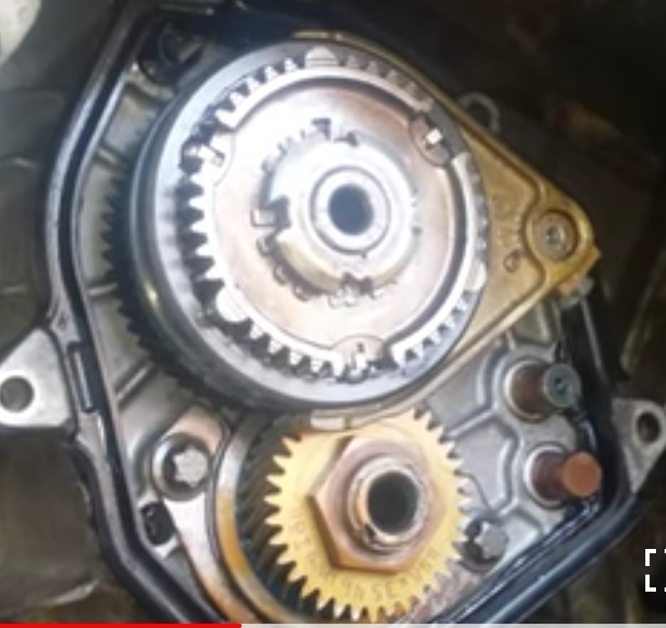

I've just replaced the complete 5th gear plus syncro (1999 2.8 ducato 164, 000 kms)

Done in situ in 2hrs including oil refill.
In my case the captivated nut had worked loose holding syncro (center of large cog).
2 x teeth broke and found in casing.
Method was Jack up nsf wheel to gain access then jack stands.
Drain g. Box completely.
Carefully remove 5th gear casing to expose gears.
Flatten out nut retaining ring and remove with flat nut.
Pay attention on how gear is situated and carefully remove off spline, being careful not to let any of the 3 ball bearings to drop from the inner face of the syncro hub.
Familiarise yourself with new parts and how they go back in.
Clean up, lubricate shaft splines and carefully reassemble.
When it came to tightening hub/gear nuts I searched high an low for torque settings without avail.
So tightened to first grunt 😁 and made sure locking tabs were good in place. Managed to get 3 to line up.
1500 kms later all good.
Refilled g.Box via reverse switch 2.7L .EP 75W-80. GL4

I decided to drain down and inestigate 5th gear, and found the flat locking nut loose and and teeth had escaped from syncro hub.
Chrome on the hub bush was pretty worn with age I suppose.I don't know, could of been the mountain roads lots of low gear, but no problems.
Replaced with all new parts
And 2.7L EP 80W-75 API GL4 through reverse switch apeture.
