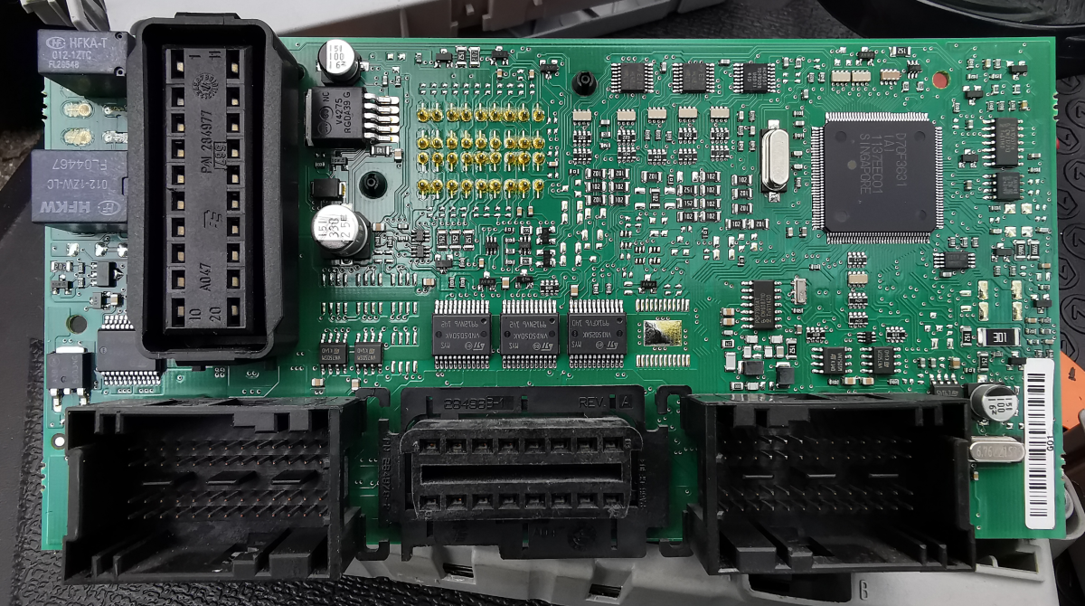

My Ducato's BCM looks like that stripped:
Other ones might be even more packed (the airbag module, ECU, ...)
