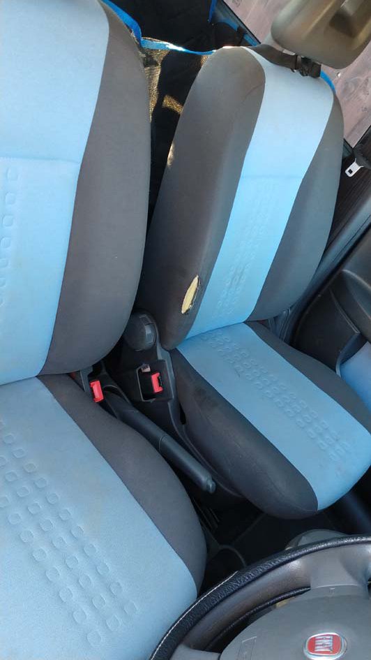

So the drivers seat and especially the backrest were showing signs of wear after 13 Years and 130 K miles.
You can swap the backrest over without removing the seats from the car but I decided to remove the seats completely from the car.
Allow 2 - 3 hours working slowly.
Photo below is after I swapped both seat and back cushions over.
