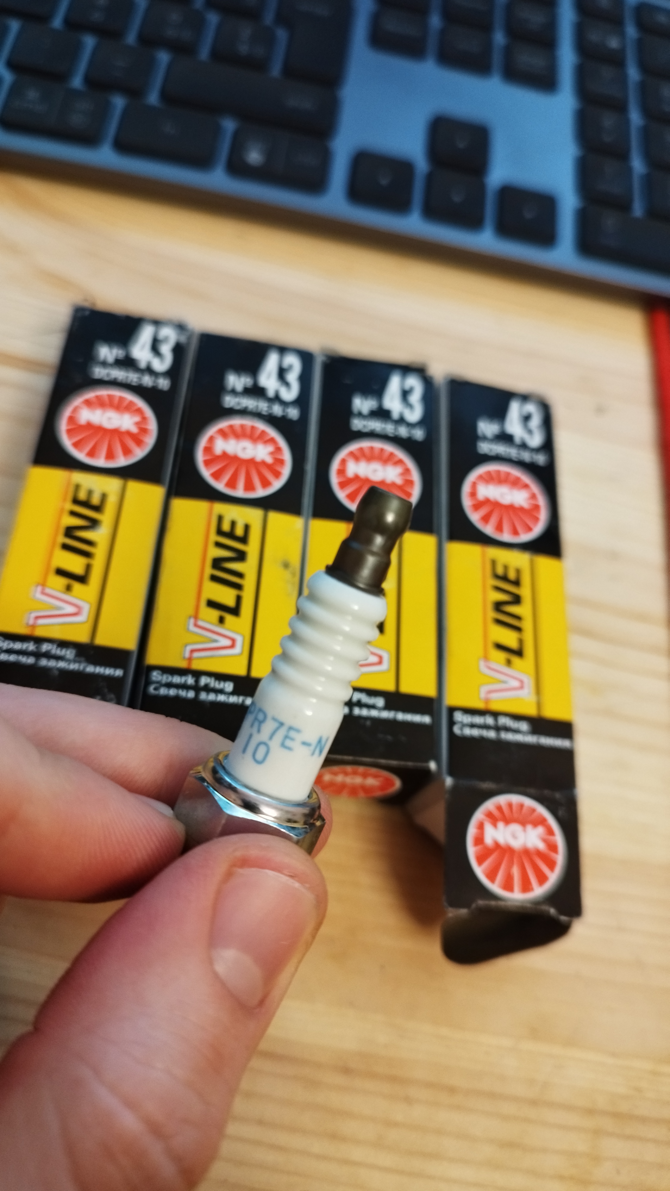

I bought NGK DC7PRE N 10 pregapped sparkplugs, which is what is written in the car service book.
On NGK website it says .039" 1mm gap but I measured all 4 spark plugs and they all have about 0.8mm gap. I am a bit confused if I should increase the gap or not. Shouldn't the gap be correct at the factory? This is the first time I have bought spark plugs.

It not worth gapping
Are you sure that you actually received
NGK DC7PRE N 10 Have a 1 mm gap
And NGK DC7PRE Have a 0.8 mm
in the last 20 year or so the gap on a major brand (denso,NGK and so on) plug has always been spot on
anyhow 0.8 mm is fine some of the equivalents are this
but I would be slightly concerned that if they were marked as NGK DC7PRE N 10 and didn't have a 1 mm gap that they were genuine

I bought them from Amazon de and on the item page and packaging it says NGK DC7PRE N 10.
I do not know if they are genuine, I trust amazon but I can send them back and buy from another supplier. The problem is that car parts are extremely limited in Switzerland. There are only 2 online suppliers and they cost 3 times as much as in Germany. Therefore I had to use Amazon for almost all equipment - parts.
What's it say on the porcelain part of the plug
The N10 isn't used in much except the later fiat 1.1 and 1.2
So they aren't cheap here either, which is why I fit the denso equivalent, normally
.8 will run fine
They stopped using the N10 with the introduction of the Euro5 engine in mid/late 2010; later engines used the near-identical ZKR7A-10, which is basically the same plug with a 2mm tip extension.
Another good option is to fit iridium plugs; if you want to stick with NGK, DCPR7EIX are the ones you'll need. These will likely last the remaining life of your car; they're good for at least 80000km. I use these myself.
There's a long historic thread on spark plugs; here.
The engine will run just fine with an 0.8mm gap (the iridiums are pregapped to that), and it'll put a bit less stress on the coil pack.

Plugs came in this box with DCPR7E-N-10 written all over it. Spark plug Ceramic also has NGK R DCPR7E-N 10 mark on it. there is ///// JAPAN ///// and M37A mark on the metal casing as well
I measured all 4 spark plugs andthey have 0.036" - 0.9mm (i do not have calipers at the moment but i will bring one from work tomorrow and check my gap tool to be sure

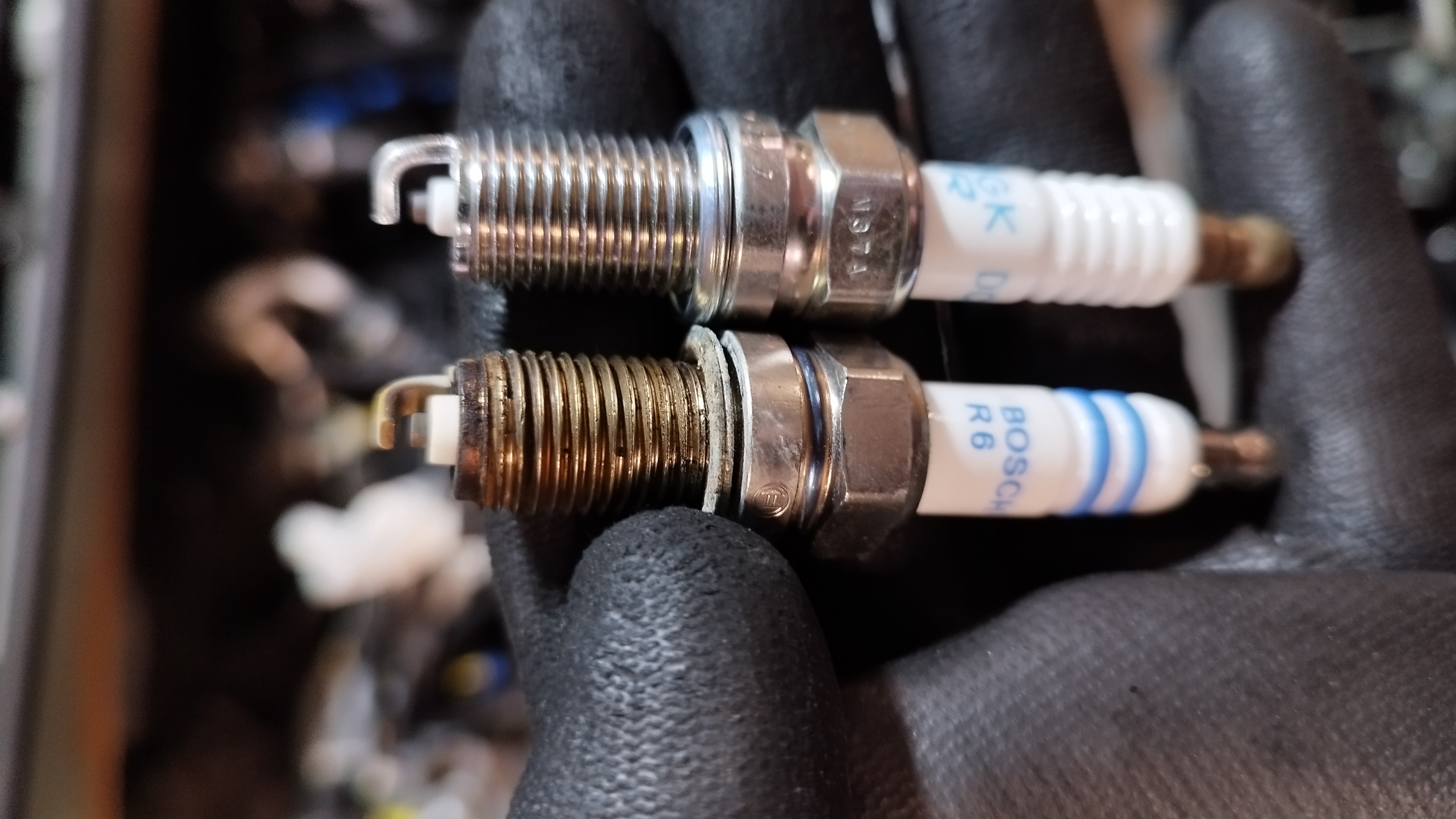

Today i changed the sparkplugs and cleaned the throttle body. Maybe i made a mistake changing sparkplugs. I watched few tutorials and there all the pictures of used sparkplugs are wornout discolored and really worse condition. Here my old Bosch plugs. They are little dirty due to combustion but look really good to me. I measured its gap all of them 0.9mm I might have changed the plugs unnecessarily.
I could not reach everywhere on throttle body but i used 95 Benzin on a rag and toothbrush and cleaned as much as possible. I could only drive 10 km and i think it is way better compared to earlier. I mean burking-jerking when off the gas pedal. But i might be mistaken and thinking i solved it. I need more road test and second opinion therefore i will let my wife drive and take her opinion as well.
