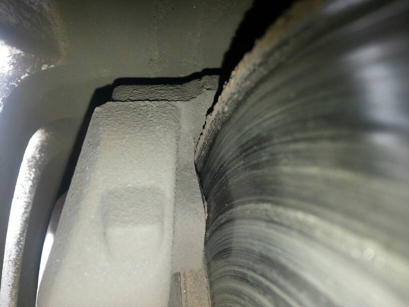

I'm beginning to think it is in fact the pads that are worn, I've just taken the picture thru the alloy wheel spokes. I cant work out if the bit at the bottom of the calliper is the friction material or the brake plate itself. (I'm pretty sure you all know where the pad is in the picture)

Come to the conclusion the problem is the pads, approached a roundabout earlier this evening and as soon as I hit the brakes I there was a metal on metal sound, took my foot off the brake, the pads stuck in position until I tapped the pedal and metal on metal sound stopped, upon returning home I checked the disc to find a very small, thin grove in the disc exactly in line with where the centre of the pad sits on the disc. Soooo new pads will be fitted tomorrow morning.
Took the wheel off the problematic side of the car to find firsty the brake pad wear sensor was hanging by a thread, and the brake were badly worn; maybe no more than a couple of mm of friction material, put new pads on, and couldnt beleive how easy it was and to think I was going to pay someone £60 to do em for me :eek: 2 bolts and off comes the caliper with a little jiggle about. The piston was a bit tough but I expected that, following advice I removed the resevior cap and managed to pudh the piston back in
