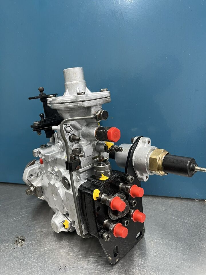

If OP looks at their injector pump and it looks similar to this photo but with a cover over the area around the four injector pipes and also covers the solenoid, then what he has to do to bypass the immobiliser is carefully cut off the security shroud to get to the solenoid as it in this photo, he should find that a 12 volt supply directly to that solenoid directly above the four injector pipes will open the valve allowing the diesel into the pump so that it can be bled and started.
He will need to safely insulate the old wires apart from one 12 volt supply possibly via the ignition switch.
Note he will need to be careful not to damage anything else, as a new Bosch pump is very expensive !!!:(

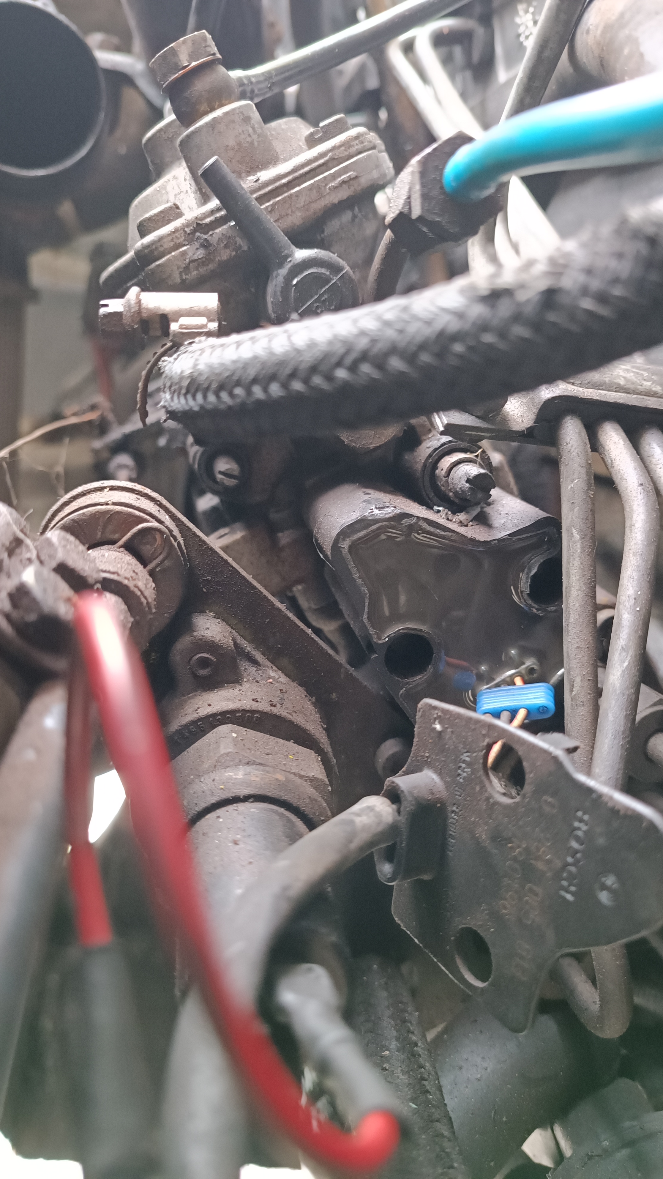

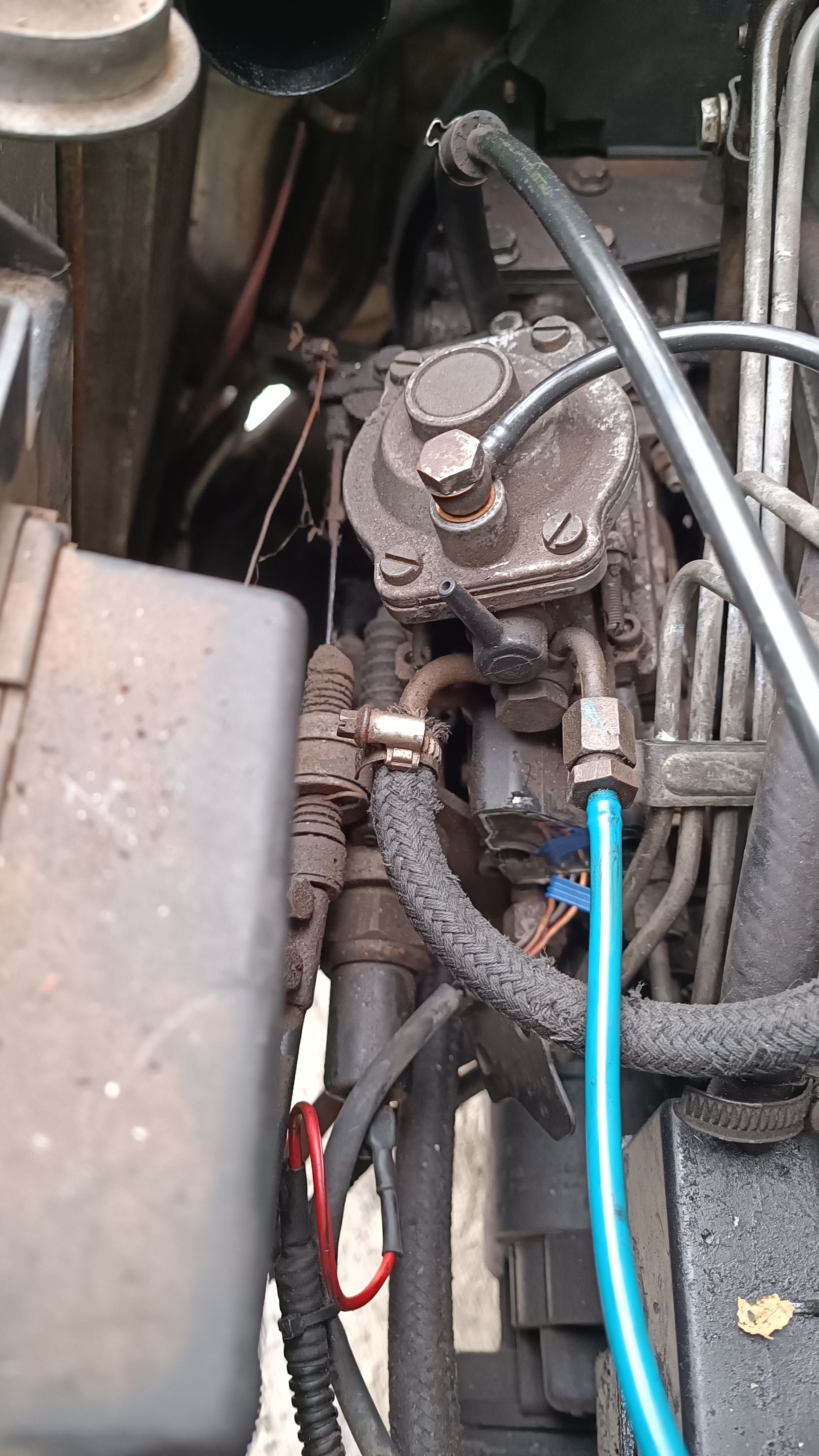

Hello send photos

Regarding the wires, do I cancel two and only connect the 12volt one?
You will need what ever gives you a 12 volt supply that comes on with the ignition switch and goes off when you turn engine off, the other wires will need to be safely disconnected.
All you need for the pump to work is the solenoid to open.:)
