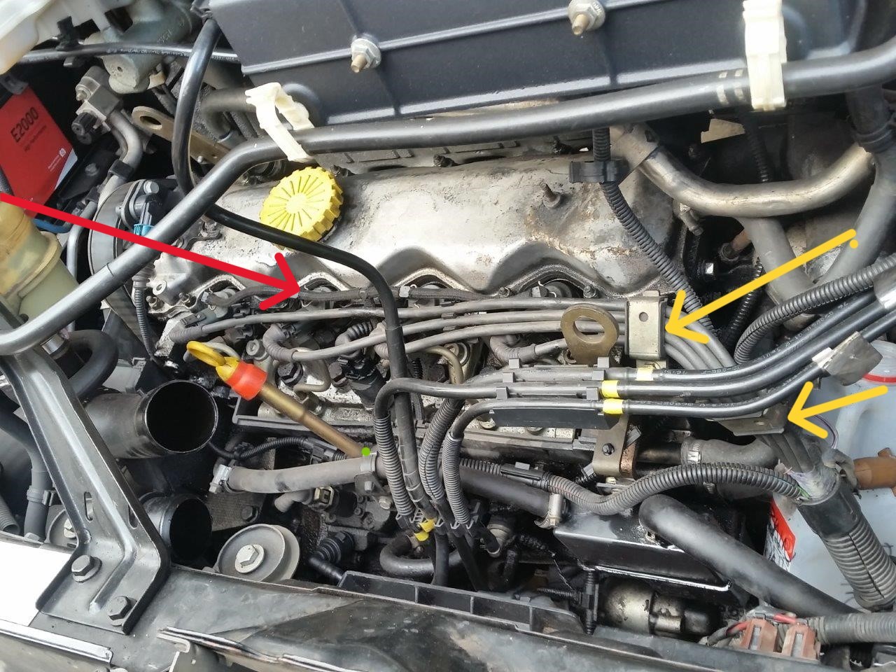

Attached is a photo of a 2.8jtd (not mine) with the air hoses across the front, and the engine cover removed. Injector 2, is arrowed in red, and the injector cable clamps are arrowed in yellow. I managed to gain perhaps 2mm of extra cable at the injectors by slightly loosening the clamps arrowed in yellow, and working the cables towards the engine.
