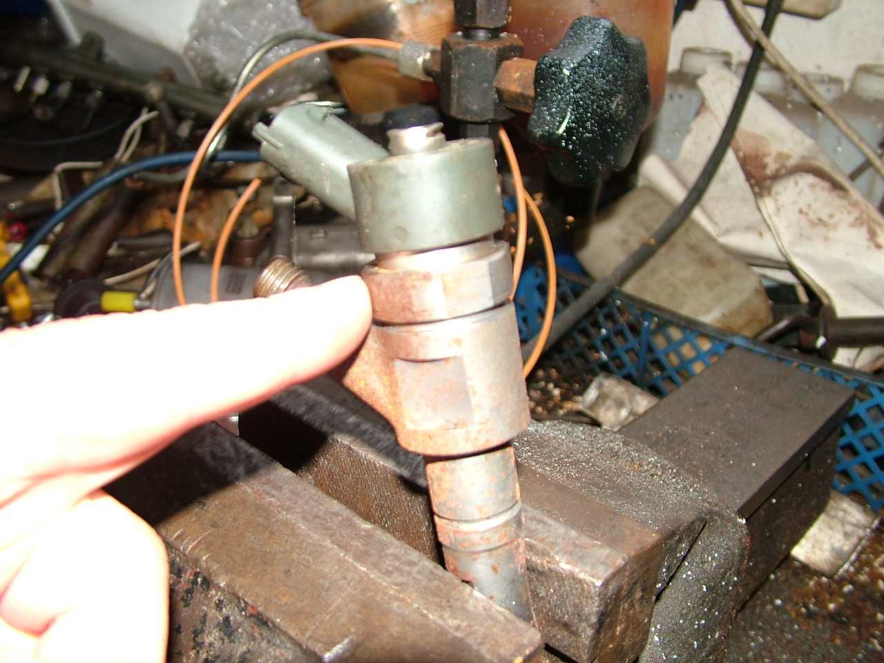

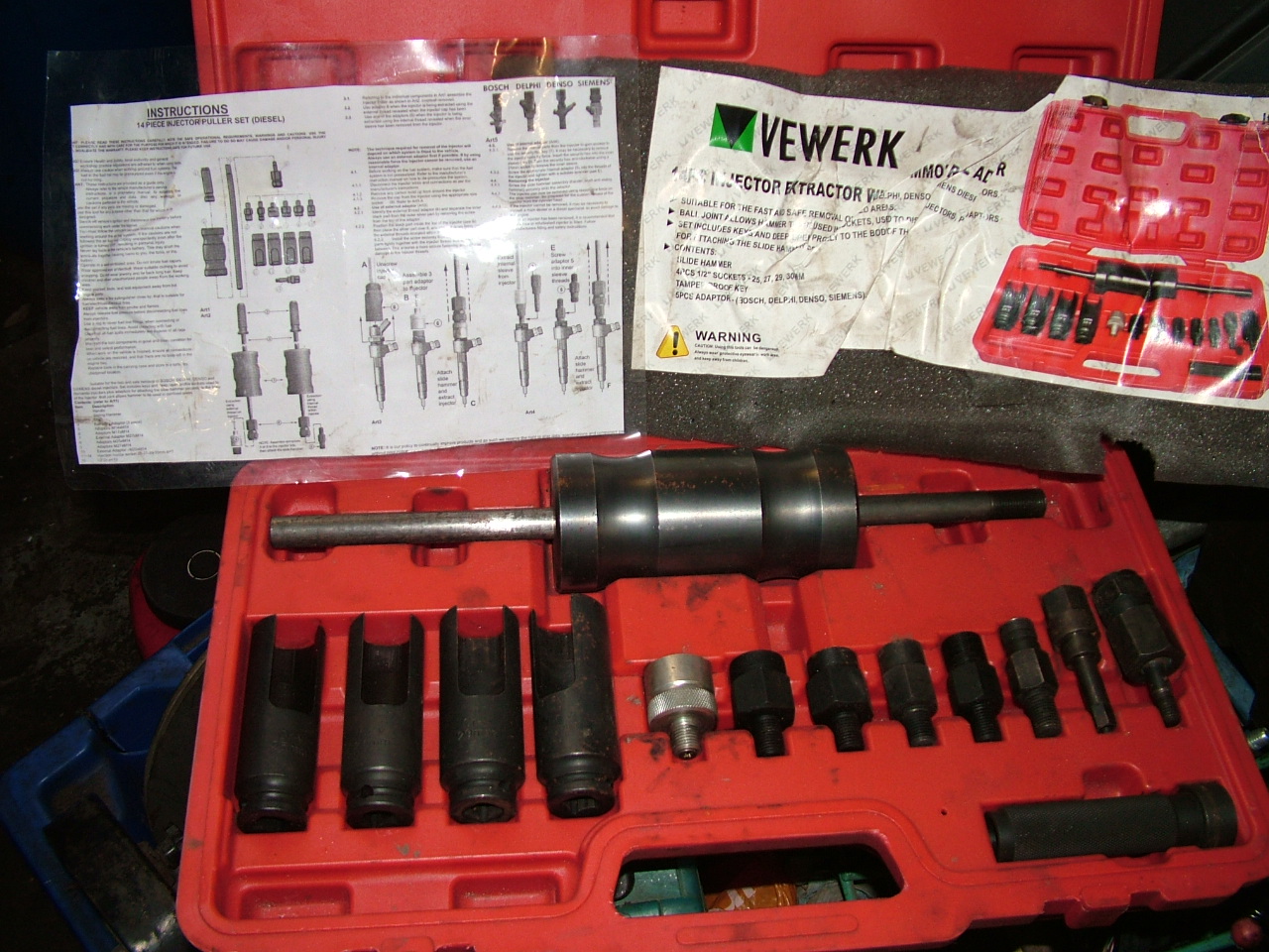

If yours are this Bosch type then I use this slide hammer tool with it's adaptor, the only problem is you have to undo the nut I am pointing at on injector and under neath in the centre is a tiny ceramic ball valve which if lost or disturbed means the injector will not work and the whole engine will not start.
I have played around with these a fair bit in the past and ultrasonically cleaned and rebuilt them, even testing using a old school injector "pop off" tester and a 24 volt jump pack connection wire just brushed across the terminals to trigger the solenoid to check spray pattern basically.
If you try that do not hold wires on , just spark it quickly at your risk.;)

Hello. Thanks for your answer, how and were can you see that it is a bosch injectors? Best Regards Trond
If the design looks like my photo it probably is, but it should have Bosch written on the top solenoid bit, plus there will be a long series of numbers which if you check on line will probably confirm.
Note late injectors on many vehicles went to piezo injection triggers so totally different.
That kit will extract many different injector types, the only issue is having to take the top nut off to fit extractor, so be careful.;)
