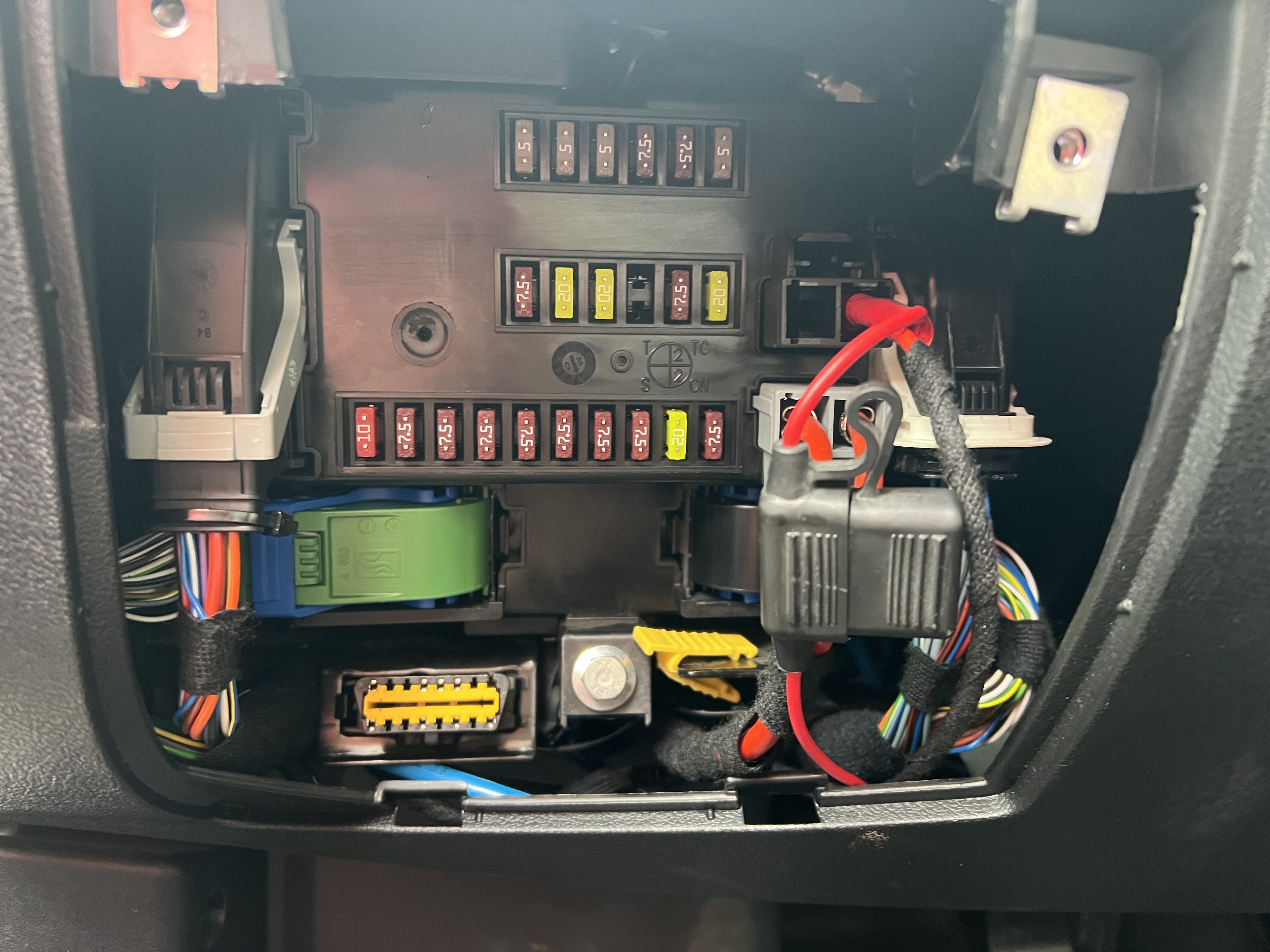

Hello,
I have a campervan (Burstner Campeo C640) on a 2020 Fiat Ducato L4H3 Maxi 2.3 140hp. I am looking for the reversing signal to connect to my Alpine receiver for back-up camera signal. I used a multimeter to probe all the pins form the fuse box connectors, but I didn't have any succes :(.
Nothing I read in other threads doesn't seems to apply and I hope it will not be necessary to use a CAN adaptor or to run a wire from the reverse lamp.
Can you help me, please?
Model
Ducato L4H3 Maxi
Year
2020
This is how my fusebox look like, for further references.
