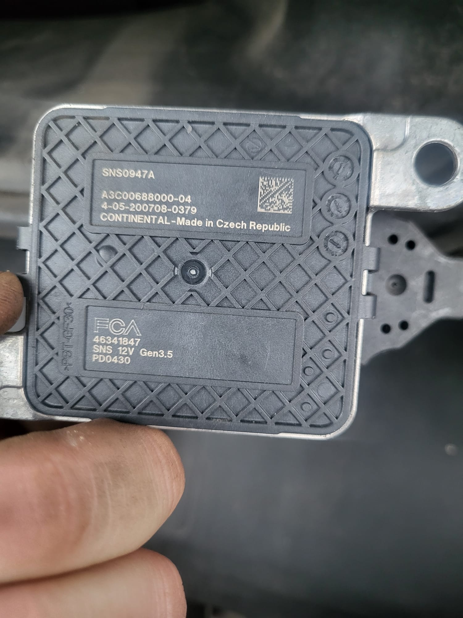

Read an article about changing exhaust sensor, the first one I saw was the Nox sensor right after the turbo, the first foto (part number 46341847). Changed the sensor with an original new. Probe in the exhaust was really stuck, but managed to removed it. Seemed to fix the problem, but the code came back.

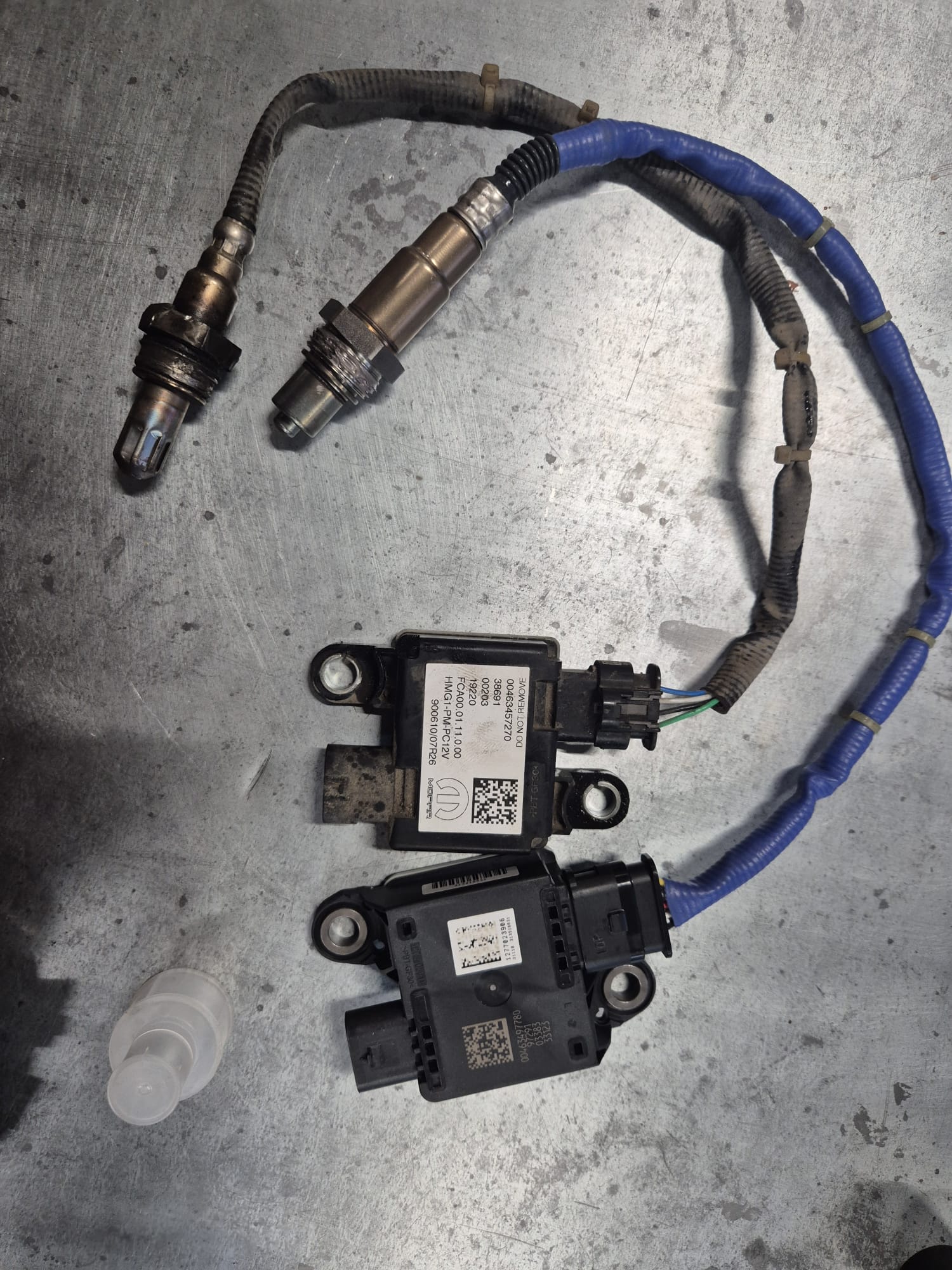

In the video it becomes clear that there is an modification for the Soot sensor. Going from a 4 wire sensor to a 5 wire sensor. Called the dealer (whom we almost always avoid) and they confirmed it. They said the modification part number is: 463497780 or 00463497780.

If you look at the pictures you will see the difference in sensors. (4 wire vs 5 wire) The connector at wich goes to the car is the same on both sensors.
