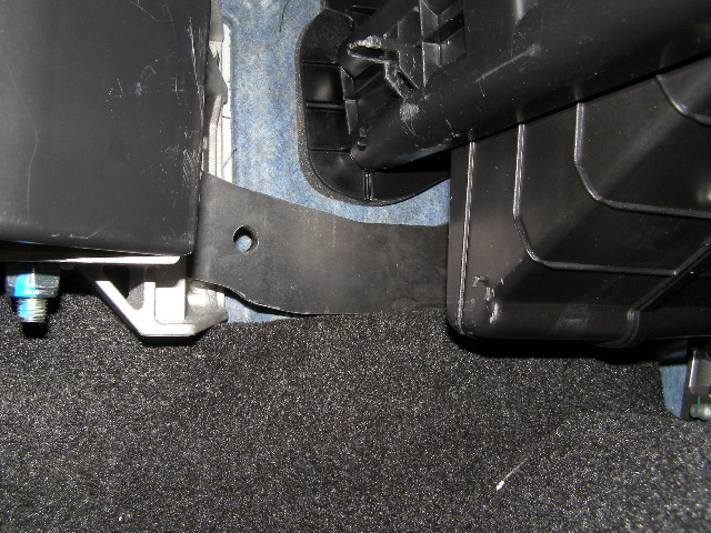

please post a photo of this location in the footwell.
John

If you look at where the brake pedal mounts, there is a bar that is attached to it, this bar dissaperes off to the L/H side of the car in the footwell, then goes out through the bulkhead to attach the master cyl to the pedal, saved FIAT having to relocate the master for RHD cars.
John
Here you go - its the flat metal bar that passes from behind the heater and into the master cylinder housing - cheap left to right hand drive conversion me thinks.
also see aluminium plate - this just slots in to the master cylinder casting and into a recess on the heater housing - no screws or bolts needed- 10 seconds to fit
i hope this helps
Chris

I'm struggling to push against that bar and make the brakes operate, however I can find a silvery coloured lever higher up (partially behind a plastic cowl) that is easier to operate accidentally. Could that be the part that was pushed?

Could be - the dealer did a test with the engine running and the car in gear - had someone put his foot on the bar (or maybe the lever) and tried to pull off.
The car was rooted to the spot and the engline stalled - the brake lights were on also??
its somewhere down there.
Chris

i found the lever your talking about - its a little too high up
I was most definitly the bar - it doesn't move much - just requires pressure on it.
C.

I looked at this last night, and you must have had a passenger with very long legs. But as you say, it is possible.
